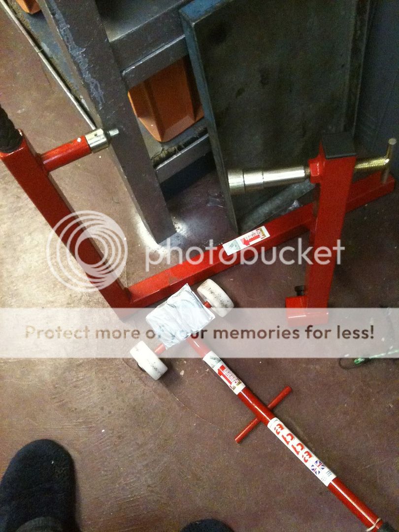

I also used and ABBA Superbike stand and front lift £135. I'm not trying to Spam ABBA here but they make some decent clever kit, even if it is abit expensive for what you get everything I have bought has been worth it IMO.

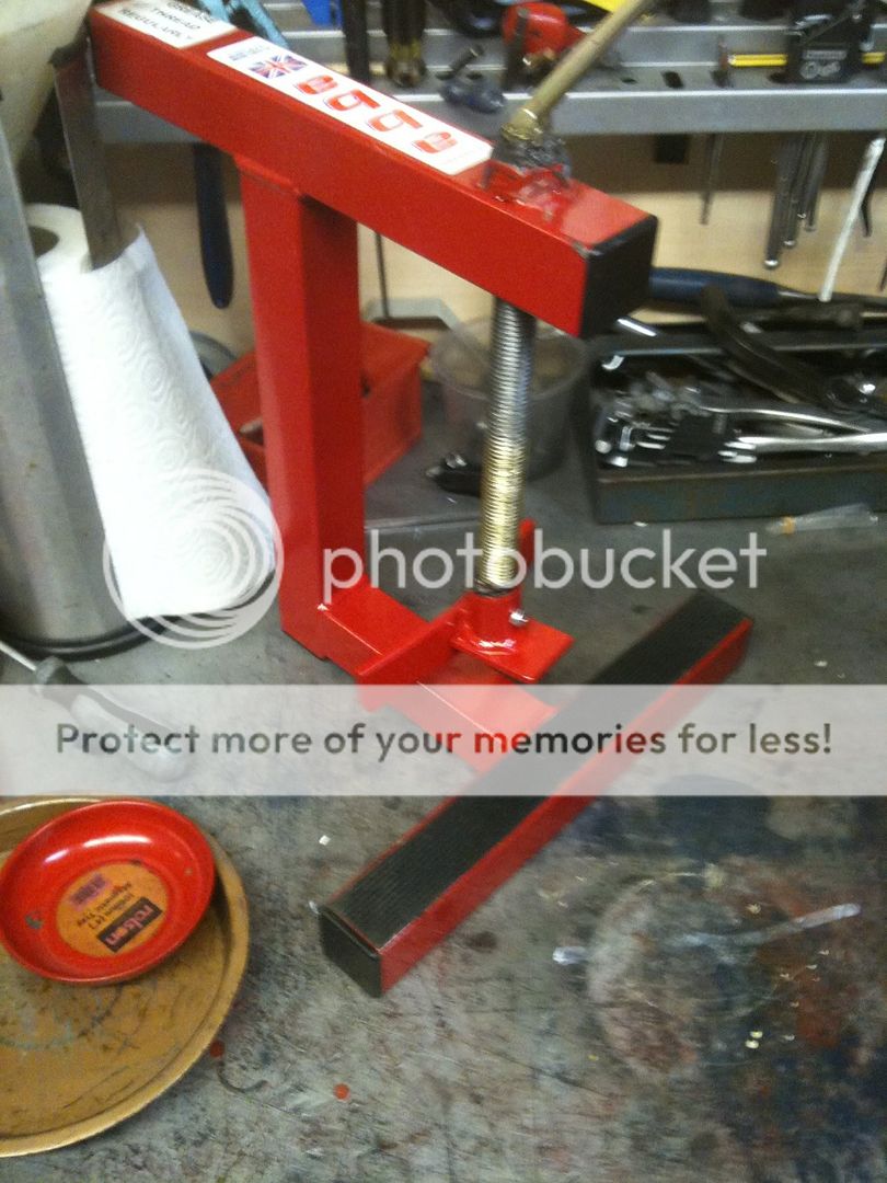

Right the kit
https://img.photobucket.com/albums/v295/chris-red/IMG_0078.jpg
Bead braker

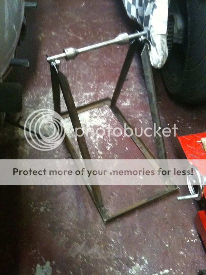

Wheel Balancer
https://img.photobucket.com/albums/v295/chris-red/IMG_0083.jpg
Abba Stands
https://img.photobucket.com/albums/v295/chris-red/IMG_0079.jpg

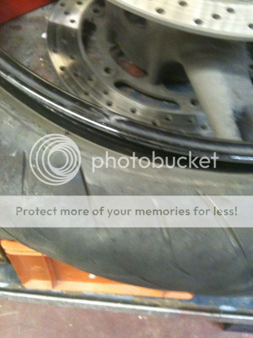

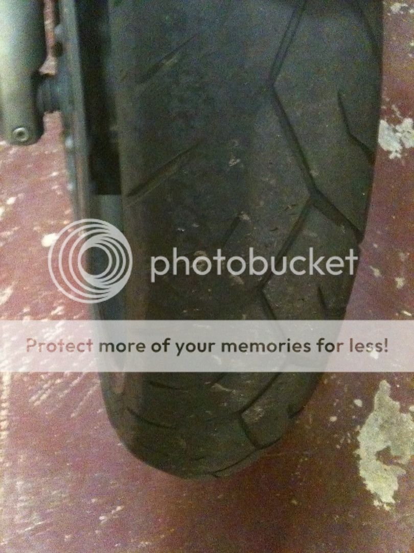

Old tyre - no that is not a trick of the light it is that slick on the side!

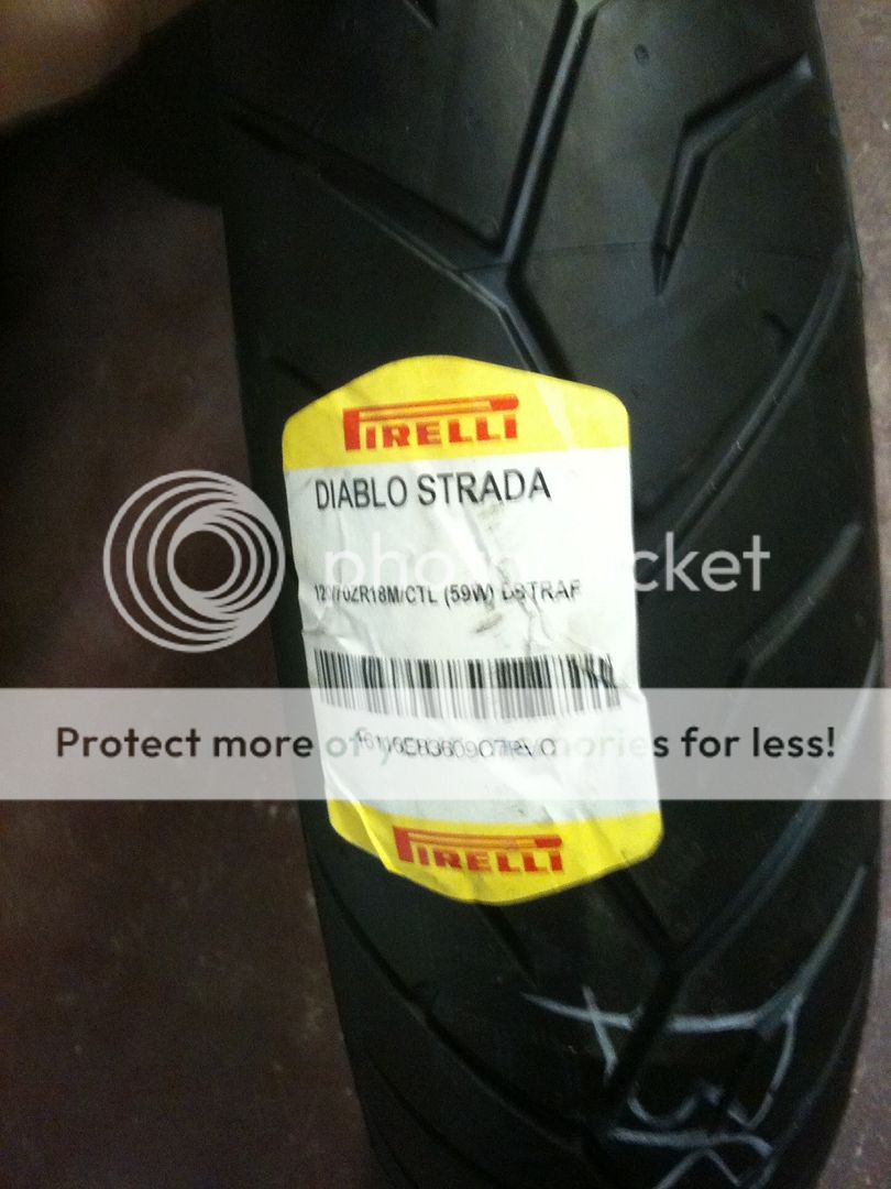

https://img.photobucket.com/albums/v295/chris-red/IMG_0084.jpg
New rubber

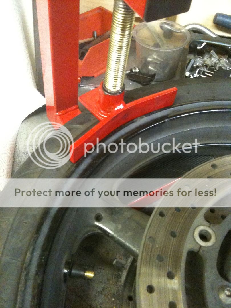

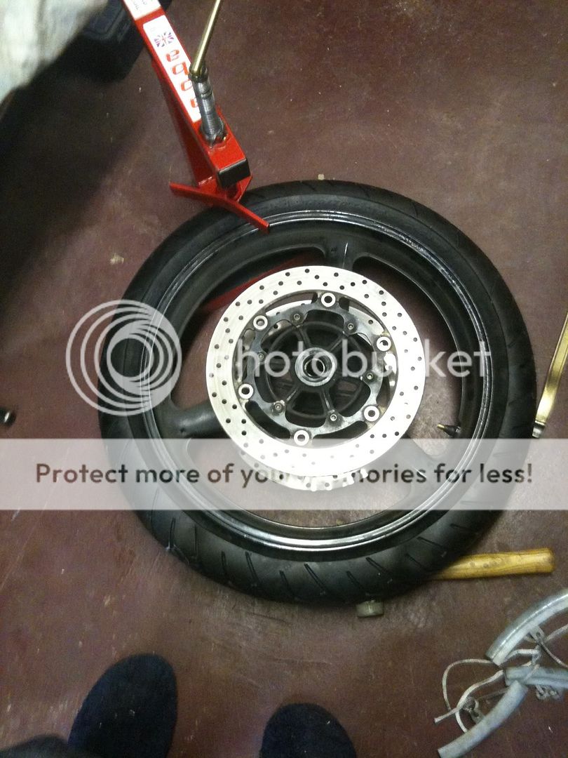

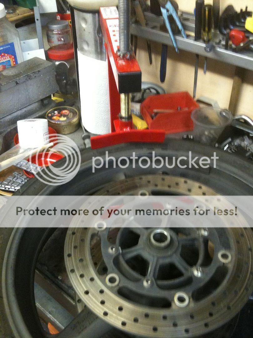

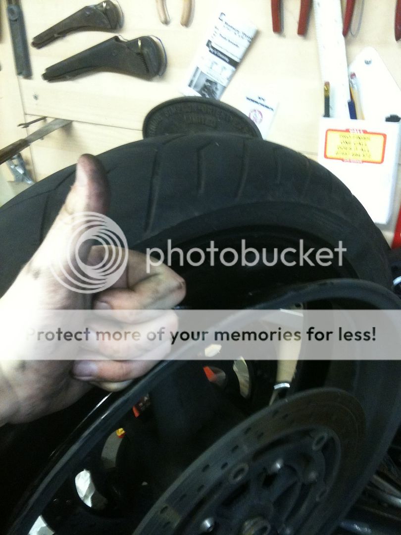

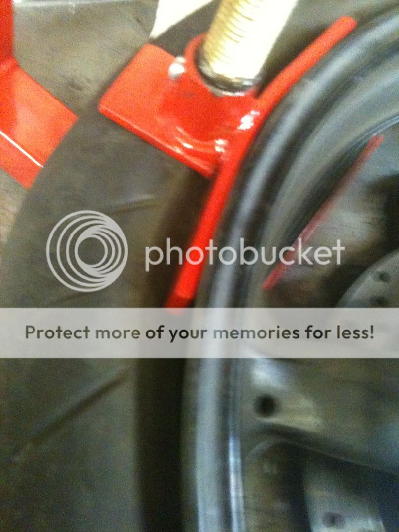

Breaking the bead, first use a screwdriver or similar to let alot of air out of the tyre you need to make sure this is free all the way round both sides of the wheel you will need to crunch the bead 2-3 times round the side of the tyre, this frees the tire lip from the rim
https://img.photobucket.com/albums/v295/chris-red/IMG_0090.jpg
https://img.photobucket.com/albums/v295/chris-red/IMG_0087.jpg
https://img.photobucket.com/albums/v295/chris-red/IMG_0088.jpg
Once that is off both sides you can get to work with the lube (I didn't do this which is why it took so long!) Put a generous about all over the tyre edge and inside of the rim. Then get to work with the levers MAKE SURE YOU ALWAYS USE A RIM PROTECTOR and work you way around. There is a technique but I can't think how to describe it but it isn't hard to work out.

Always use the rim protectors
Use lots of lube

And what's with the wheel balancer? Looks nice, but such a waste of effort making that when all you need is a couple of chairs and a piece of wood that goes through the wheel.
Also you mention using the bead breaker to pin the tyre down as you work around the edge with a tyre lever. If you don't have a bead breaker, your knees are a great tool and you only need one tyre lever, just work it round and move your knees around the tyre as you get more over the rim.

it does get easier after the first few goes.
the screw type is easier to use than the lever type unless you got enough wieght/leverage to pop the bead. my tyre felt like they were glued on i had to break the bead at 6 points around the rim to make sure it was off. an extra 10 minutes of work but nothing terrible.
as for the wheel balancer. a bit of wood through the wheel sound like a shit idea. at least with mine it can actually get balanced and doesnt have to be on perfect level ground or anything like that. plus its always good fun making up stuff like that in my spare time.
PostPosted: 18:59 - 22 Apr 2010    Post subject: Reply with quote
Well you would say that because you put in the effort of making one out of metal Laughing My wood method works, it's free, it takes less time. I can't actually think of one disadvantage Thinking
steven_191
Joined: 31 May 2009
PostPosted: 19:08 - 22 Apr 2010    Post subject: Reply with quote
apart from a bit of wood through the wheel what else do you use?
PostPosted: 19:10 - 22 Apr 2010    Post subject: Reply with quote
Used Wink I'm never doing it again.
I used two garden chairs Laughing
Gazdaman
I did a trackday!!!
Joined: 12 Aug 2004
PostPosted: 19:12 - 22 Apr 2010    Post subject: Reply with quote
I tend to agree with the improvised method although your balancer thing is cool.
When we did the tyres on the race 'ped we just balanced a broom on a bench and something else.
Gaz
steven_191
Joined: 31 May 2009
PostPosted: 19:16 - 22 Apr 2010    Post subject: Reply with quote
does that mean you have a bit of wood that give a good fit in the bearings or just anything that slots through. could you do it with a long screwdriver for example? i thought the whole point of the balancing was to get the centre of the wheel at the centre of rotation which in turns shows the weight in the wheel.
either way, some people say they've never had the wheels balanced, i just wanted to make something else. i like these little projects. i wouldve probably made the bead breaker too Laughing dont tell chris
Gazdaman
I did a trackday!!!
Joined: 12 Aug 2004
PostPosted: 19:18 - 22 Apr 2010    Post subject: Reply with quote
Doesn't really have to be a perfect fit, ideally bigger than a screwdriver though.
Just spin it, mark the part of the tyre at the bottom, spin it again, if it lands at the same spot again put a weight at the opposite side.
Repeat, when it lands on a random point 3 times, it's done.

Your wheel balancer is too small for rear tyres moron Thumbs Down Make me another one, Rear went on fine infact putting the rear wheel back on the bike was harder than fitting the tire, it took about 10 minutes to get the rear wheel off another 10 to get the tyre off 25 to get the new one on (had abit of trouble) then 5 to balance it then about 40 mintes to get the rear wheel on and adjust the chain. Had loads of trouble holding up a heavy wheel whilst trying to ensure the 2 spacers stayed in place and lining the brake disc up with the caliper whilest trying to line the spindel up with the holes. Evil or Very Mad

After doing the rear I still have no idea how Chives fucked his rims like that, both of mine where not even marked in the slightest, I wasn;t being gentle either.
PostPosted: 09:46 - 23 Apr 2010    Post subject: Reply with quote
chris-red wrote:
I can't work out how some people can get tyres done so cheap unless it is mates rates.
It was done taking it off. Maybe my rim protectors were shit but I'm still never doing it again.
