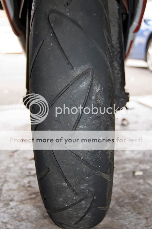

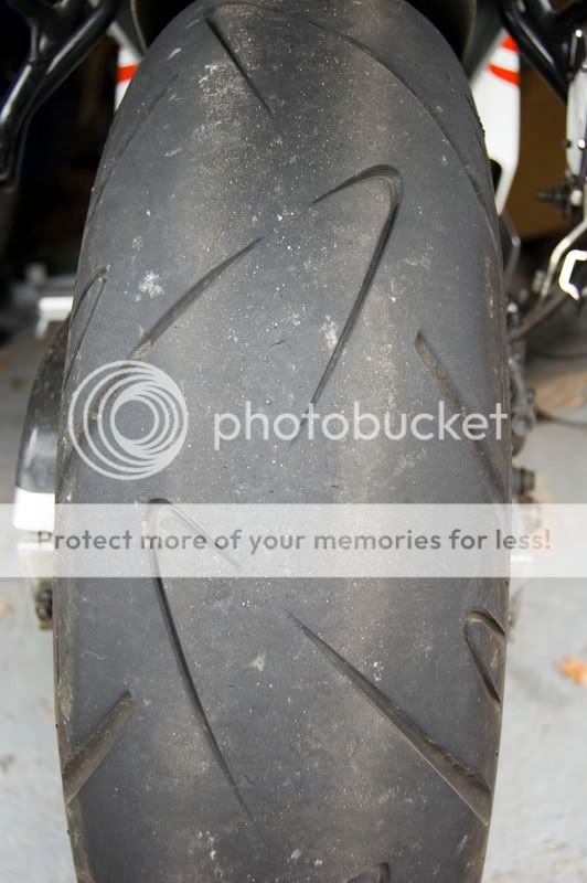

I'm trying to plan myself a little Europe trip, probably covering around 3-3.5k miles and I'm trying to add up all the costs, which led me to my tyres! How much life would you guess these tyres have left in them (that is if it's even possible to tell from a photo)
Also, they are Continental Road Attack's - any good? Thinking
https://i4.photobucket.com/albums/y118/Wonderboy_001/DSC_0397.jpg
https://i4.photobucket.com/albums/y118/Wonderboy_001/DSC_0396.jpg

looks like the rear is slick right in the middle, can't remember my tyre laws (focused mainly on cars) but I don't think it's allowed to be slick in the centre. Would get it cahnged soon tbh
EDIT: NICKED FROM A QUICK GOOGLE SEARCH
The grooves of the tread pattern must have a depth of a least 1 mm throughout a continuous band measuring at least three-quarters of the breadth of the tread and round the entire outer circumference of the tyre
looks like that tyre is outright illegal going on the above

It's not supposed to be slick anywhere Laughing (where there's supposed to be tread)
And going by my usual standards probably around 5k.
But beware, there might not be any rubber, anywhere!
Front has loads, but the rear won't last the 3.5k miles.

You need a new rear, front should be ok

Oh dear... I knew it was a little low of tread, but didn't know it was illegal! Shocked

As above your rear tyre is beyond it.
Same model and make if possible as they will be the same profile, if not then "some" reckon a less grippy rear of the same brand is an ok alternative.

I'd say it's probably best to replace like for like, go with what you know and all that.
Get it done ASAP, that tyre carries 3 points and a fine of up to £2500 Shocked

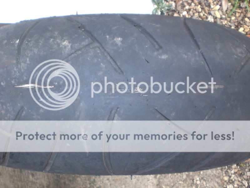

This was my rear...
https://i29.photobucket.com/albums/c282/M0LOT0V/tyres/CIMG2230.jpg

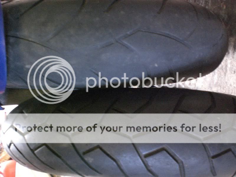

And this is comparing my front, old and new. Guess which is which Laughing
https://i29.photobucket.com/albums/c282/M0LOT0V/tyres/CIMG2237.jpg

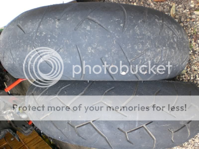

Comparing old and new rear..
https://i29.photobucket.com/albums/c282/M0LOT0V/tyres/CIMG2234.jpg
And I'm sure others have ridden on worse. Laughing

The front looks 'cupped' to me, which although is not illegal will seriously affect the handling. Cupping is where tread blocks are slightly different heights across the gap of the tread causing high spots on the tyre. This will affect the profile of the tyre and the grip supplied by the tyre.
Replace them both is my advice.

And Marjay, how can you see that it's cupped?
Edit: I see you wanted to start a new thread. But you somehow hit reply to this and change the title in "Subject" Laughing
PostPosted: 16:49 - 23 Apr 2010    Post subject: Re: Where to buy black domeheaded bolts? Reply with quote
Look about two thirds of the way up the front tyre, by where 'CONTI ATTACK' is stamped in the tyre. The tread block there is higher than the surrounding tread. It looks cupped to me.

What can cause the tyre to become cupped? Also, because I'm probably be going to do a lot of motorway miles for the trip - my house to Dover is about 480 miles on it's own, which is nearly 1k miles return - do you think it would make more sense to get a harder or cheaper tyre?

Running on low pressures, overheating, poor tyre design. Lots of things. I'm no expert but I know that it is bad. Its like riding a knobbly with very small knobbles.

There's a bit of a tell-tale on the 'peaks' of the tread-pattern too, looks like the rubber's been rolling a bit under heavy braking. I'd keep the front and change the rear. Do both if you can afford it.
