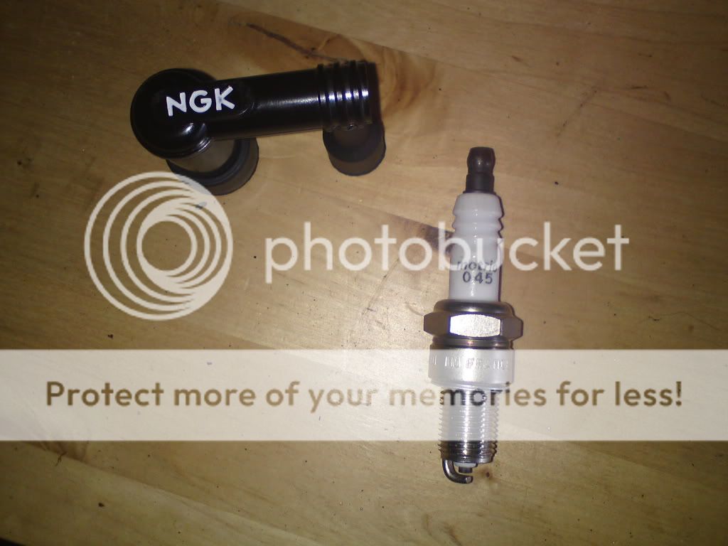

New NGK spark plug orderd & New NGK Resistor Cover.
I will let you know how i get on.

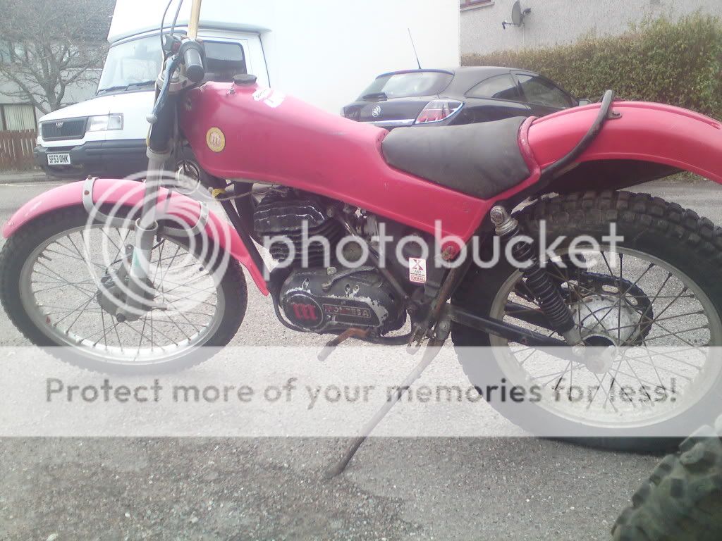

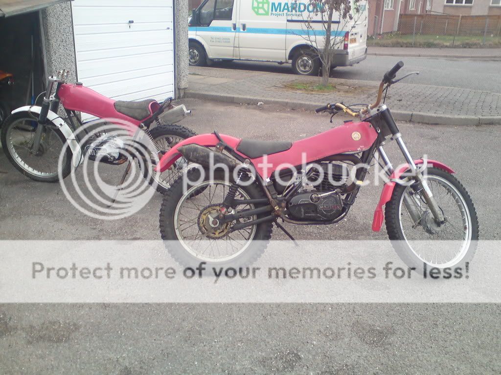

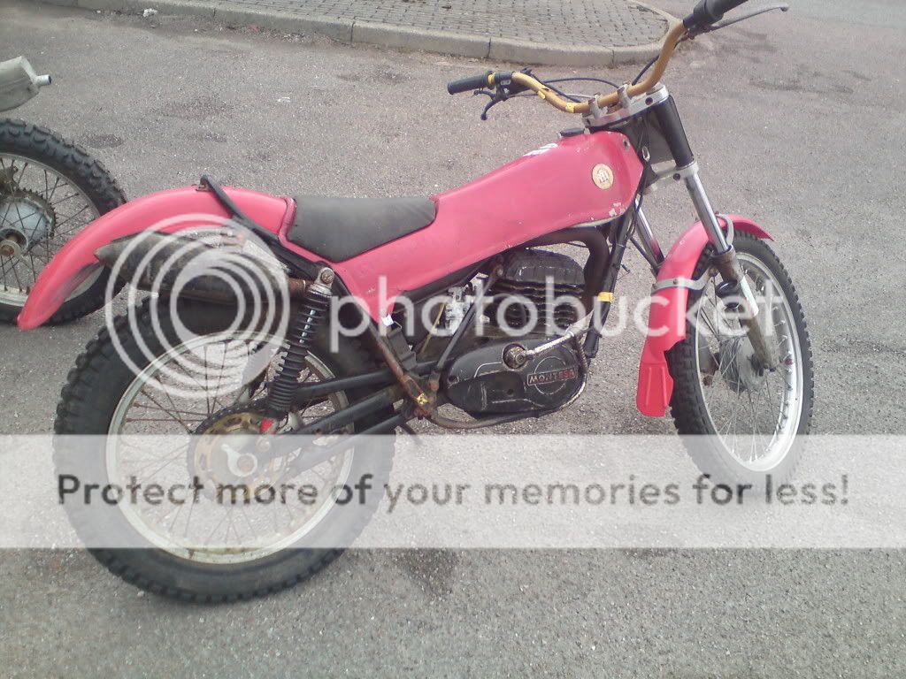

ok you asked for it Blue, It sparks direct from the red lead. But when i conect the plugs and caps theres nuthing.
https://i793.photobucket.com/albums/yy214/zedxfarin/DSC00336.jpg
Ok so what your looking at now is a erly to mid 70z twin Shock Montesa cota 348. I was laffing when you said i would be out again soon as i'v never had it running EVER! LOL

The new plug and cap arived today. Sadly still no joy. Confused
