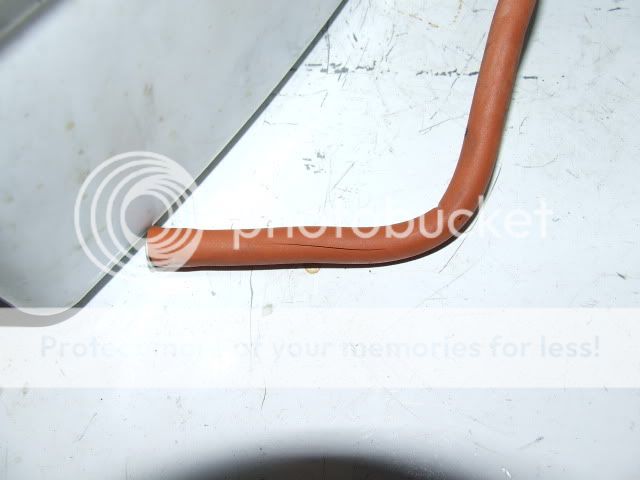

PostPosted: 18:24 - 03 May 2010    Post subject: Reply with quote
I have a little piece of rubber tubing with a bung in the end and a slit in it. Allows fluid out of the slit but nothing back in.
