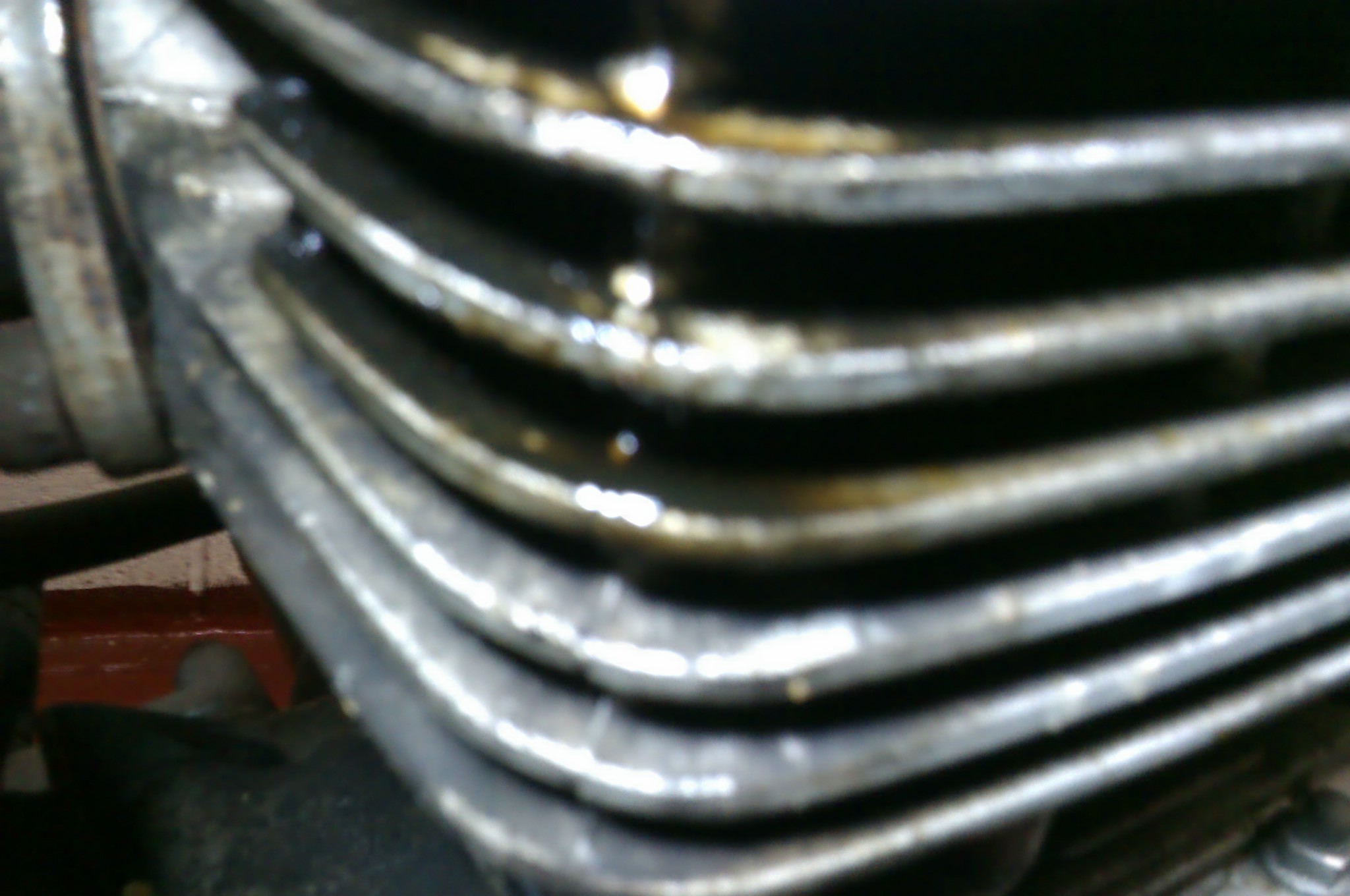

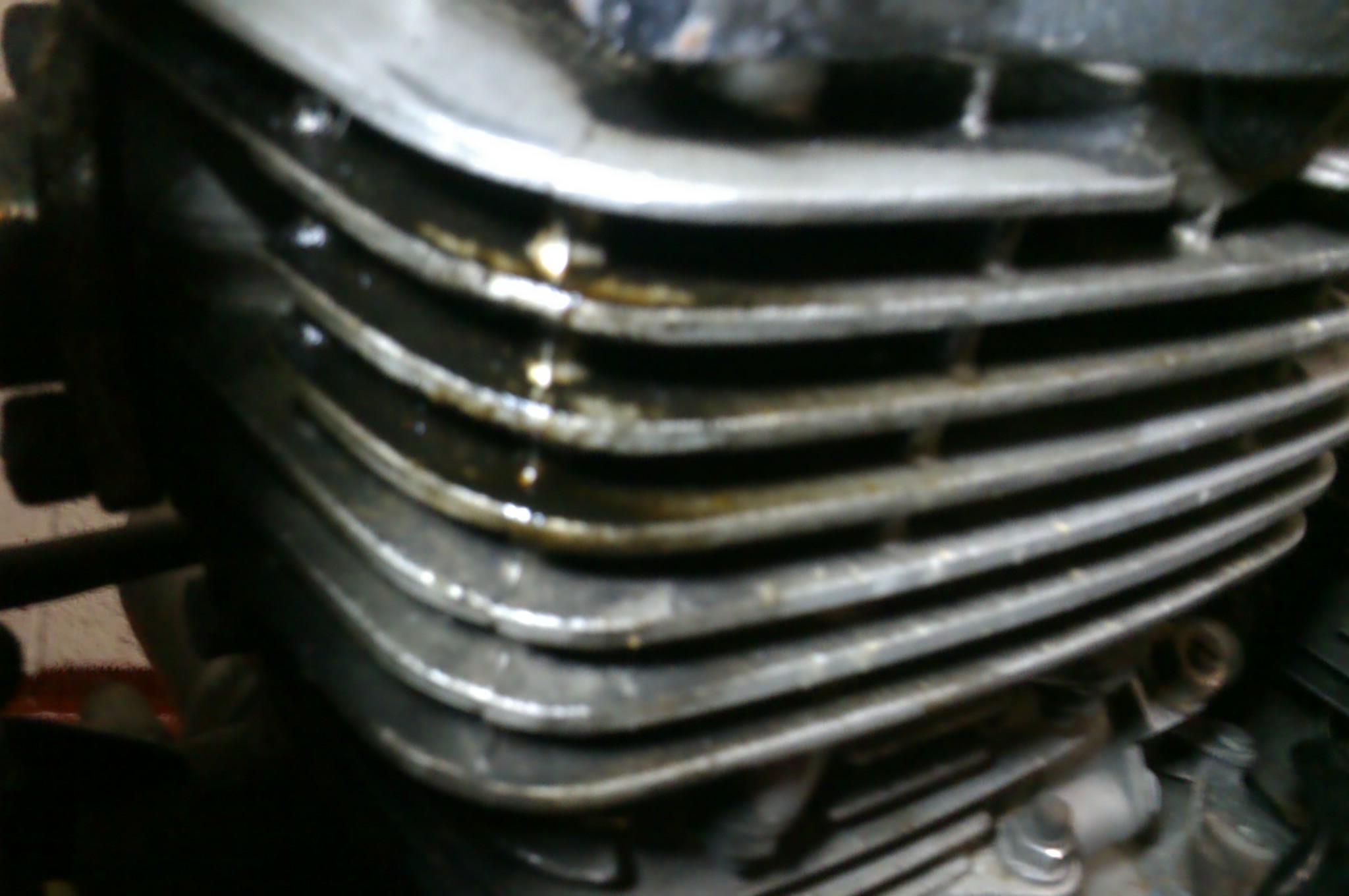

Today we thought it would be fun to take the top end off my bike and have a play around and make sure everything was ok.

Everything was ok apart from setting up the cam timing. Somehow by sheer luck the first time we put it back together it was180 degrees and 1 tooth out so the valves didn't hit the piston but it didn't start and just backfired very very loudly.
Figured out that we needed to turn it 180 degrees so off with the tank, electrics, cam cover, cct, cam timing gear and moved the gear round half way and put it on. It kind of ran but very sluggish so another tooth sorted that out.
There were no markings on the cam like described on the internet and in the workshop. Just a large chunk in the end which was horizontal at TDC.
