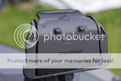

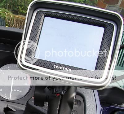

The rider should have a mount that comes with a twin cable which wires into the bike, ideally the ignition, if you have to open the flap at the bottom to plug it in then you have bits missing and that cable won't plug in if you have the rider on the proper mount.
It charges when you drop the rider into the mount, no messing with plugging stuff in etc.
New cradles cost about £60, plus the ram mount which costs about that again and these parts wear over time and although i do huge mileages i'm on my second mount in a year, lucky it's got a 2 year warrenty.
Did you get the scala headset with it as well?
The mount

The unit fitted and you can see the wiring plugged into the bottom of the mount.

Thanks Bramble, so I need a cradle and a ram mount?
Then it's just putting the Rider into the cradle, wiring the cradle to the bike, putting the cradle into the mount and attaching the mount to the frame.
All I got was the Rider itself, the cigarette lighter power cable and the headset.

The Tomtom mount comes with a variety of fixing methods.
Mine is secured to the handlebars using longer bolts which go through the tomtom mount and the brake cylinder clamp.
There is a spring loaded ball and socket arrangement which is used to adjust the angle of the Rider. This can be slackened off and the whole mount can easily be removed from the bike.
