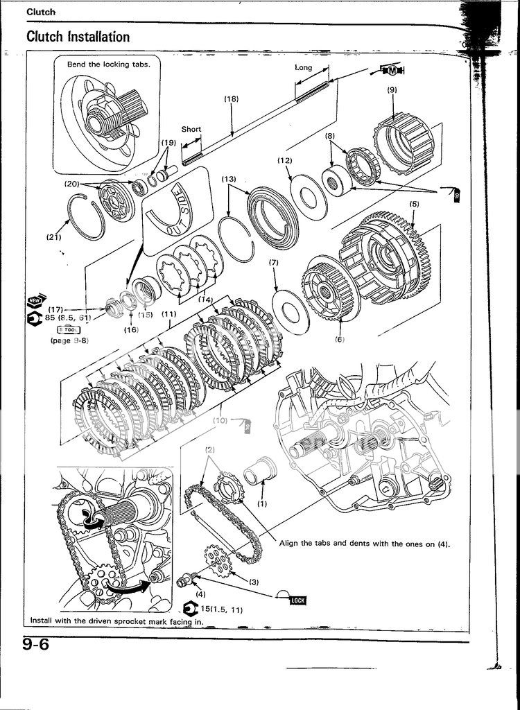

https://i29.photobucket.com/albums/c282/M0LOT0V/untitled-2.jpg
The part he is referring to is part 14 in the above diagram.
I suspect that the problem is with parts 18/19 or maybe nut 17 coming undone.
i think its part 18, the road keeps sliding apart slightly? think that could be it? the nut 17 is locked on securely
