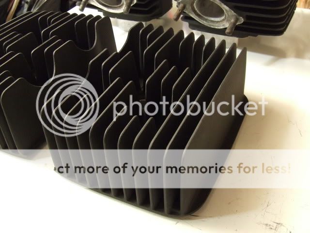

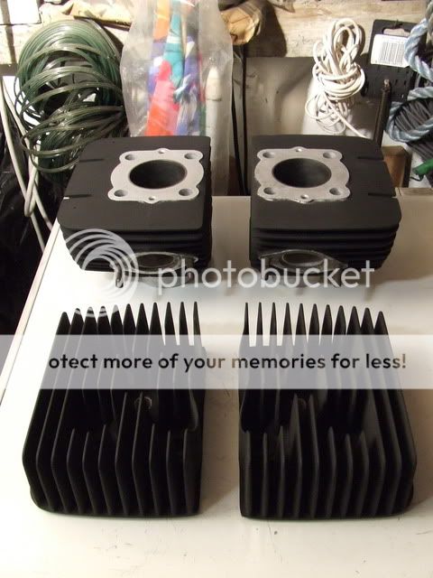

I'm assuming he's using it out of a spray can meaning it won't be that thick.
I used Hammerite BBQ paint on my dad's RD250 engine with good results:
https://i15.photobucket.com/albums/a376/ms51ves3/DSCF1734.jpg
https://i15.photobucket.com/albums/a376/ms51ves3/DSCF1731.jpg
It was just VHT paint in a Hammerite can.
PostPosted: 10:28 - 26 May 2010    Post subject: Reply with quote
OK but compare the thickness of those fins to a radiator.
https://www.aaronradiator.co.uk/images/KAW2010Rwm.jpg
Bit of a difference
