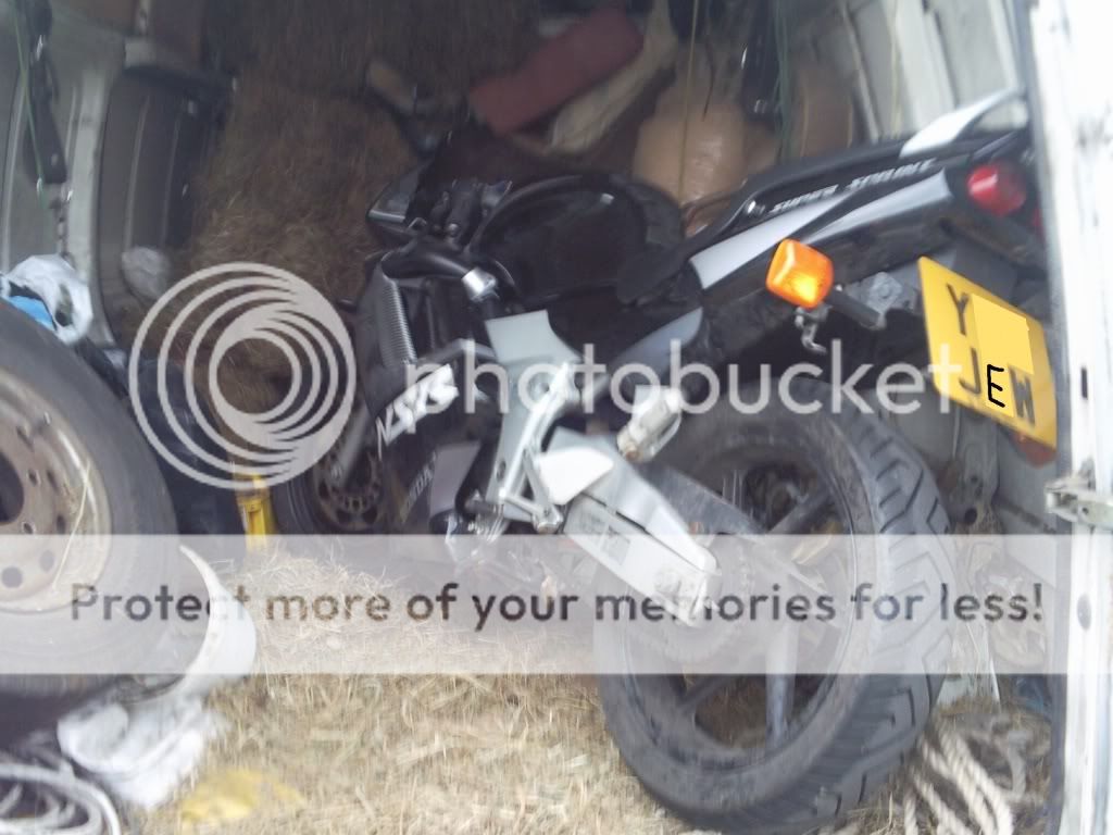

Any help as soon as possible would be lovely because I have left work 3 hours early tonight to get this fixed for tommorow morning otherwise I be fucked. I nearly had to push it if it wasn't for the security guard owning a van.
Have a van picture.
