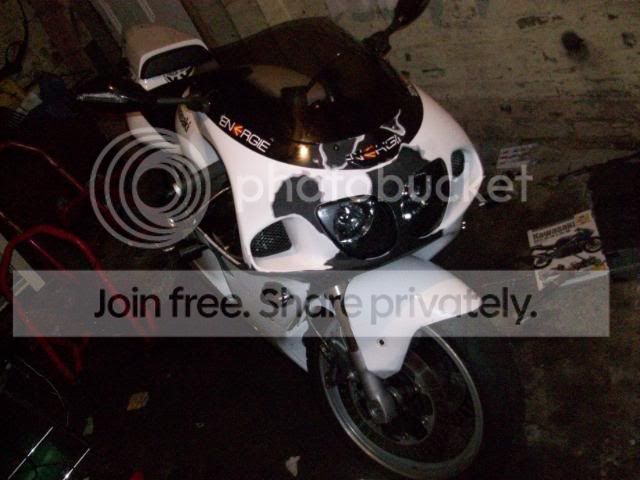

update
Got the logbook fairly quickly, was like 2 weeks i reckon. sorted out the electrical problems with the indicators. discovered the led indicators wouldnt work on the front connections so swapped those over with new ones.
removed the led strip on the rear of the bike as it seemed pretty tacky, replaced them with flush fitting indicators that are using the holes left over from the grab rails.
got a seat cowel, rear hugger and crash bungs from previous owner. had to replace the clock bracket as the original was bent. ordered new clock brace, harris screen brace.
took the fairings to get repaired and got them back today, also got the lugs on the clocks plastic welded back on.
hopefully if i get out of class early tomorrow i might get it back together before work then try and get it mot'd for friday Very Happy
heres the bike put back together
https://i626.photobucket.com/albums/tt349/Kaiser_Damz/100_1461.jpg
everything seems ok, electrics are behaving and have been tidied up, fairings seem to fit together all right and it starts with no hesitation.
pipes are pretty rusty so might replace them with stainless steel pipes towards xmas
