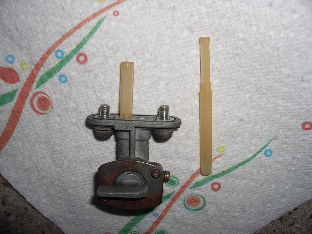

Right, all sorted now... ... I hope.
I used a few inches of stiff wire to hook the errant fuel tap filter out of the petrol tank. I said I’d get the sucker eventually. Twisted Evil
The long bit of plastic is the bit that had come adrift and was rolling around the tank. It was a nice tight fit back into the tap so hopefully it won’t work loose again. This I hope will take care of 99.9% of the filtering duties. It goes back into the hole to the right of the installed reserve filter.

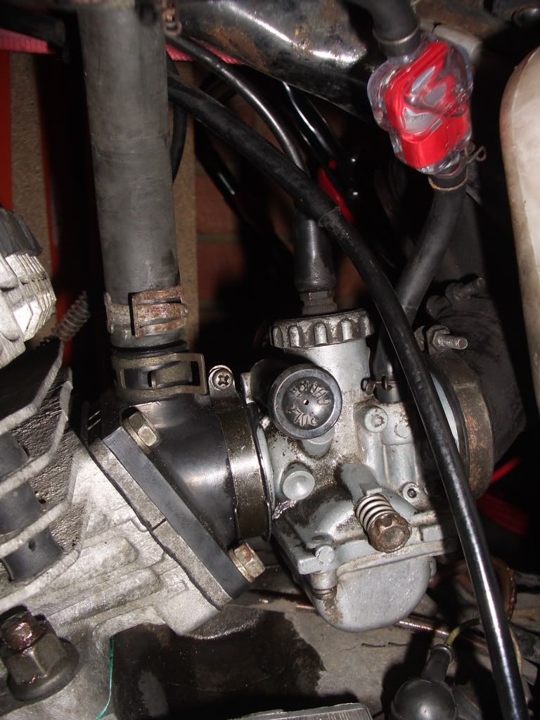

I took the precaution of stripping and cleaning the tap. Then stripped and cleaned the carb and put it all back together.
Taking the sound advice of Messrs. 27cows and Robby I purchased an inline fuel filter (sadly a mesh, not paper one) and installed it midway in the delivery pipe. I suspect that I may have to shorten the pipe a little to stop the filter rubbing on the side panel, once reinstalled.
https://i221.photobucket.com/albums/dd227/serendipity_uk/RXS100/IMGP7034.jpg
The bike runs perfectly and, so far, no premature moistening of the crankcase. I have rather rashly left the fuel tap switched on so fingers crossed I don’t find a petroleum swimming pool in the morning. Laughing
