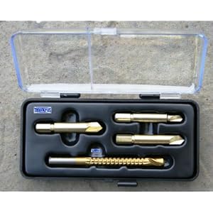

PostPosted: 09:37 - 24 Jul 2010    Post subject: Reply with quote
https://www.fordprobestore.co.uk/store/images/plusgas1.jpg
+ a few hours +
https://g-ecx.images-amazon.com/images/G/02/ciu/a2/39/7672017b42a0f3ae035b1210.L._SL500_AA300_.jpg
