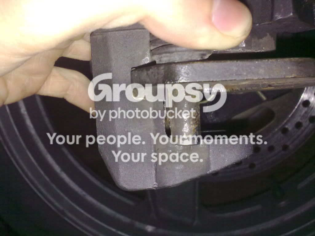

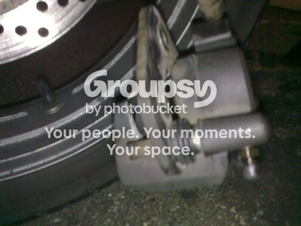

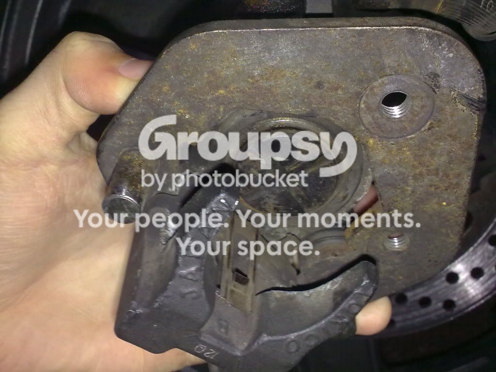

Pictures if it helps
I shall hold off with the WD 40 until later then thank you, and I assume by the bevels you are referring to the rubber I've pulled back slightly in the middle picture just below my thumb (see below)
The main problem is just getting them to move, I'm sure once they're free I can repair any damage I have but until then, I'm at someone elses house with a 50 mile trip home (presumably not tomorrow now) and I don't wish to do it without a rear brake!
I was thinking a whole new caliper at first but it seems to be a repeated problem amongst this caliper design among various bikes. I'll give my father a call in the morning regarding anything you guys and girls suggest, greatly appreciated!

I just wonder....
I have just recently done mine on the GPZ500 (they look the same as mine)
You do know that the pins that run 'through' the plate are fixed and are not supposed to move?
The whole plate and pins are removed together as one piece
The /only/sliding bits on the caliper are the bits hidden by the rubber belows (the bit under your thumb in one picture)
Just checking incase your trying to move the plate completely from the pins...which would be bad
Mine were gummed up inside the rubber bellows and had caused just one side of the pads to wear down
If you pull the bellows back and pll them to one side and drip some brake fluid in there and "pump them" in and out ...eventually they will pop apart allowing the surfaces to be thoroughly cleaned and greased up
Only one side has a 'proper bush' running through the caliper , the other is part of the rubber bellows and runs throughout a drilling in the caliper and should be poking out the back
This side will come out completely...but only once the pin and plate arrangement had been removed fully
I did this to get it thoroughly clean and to remove the old "stuff" that was obviously not as rubber friendly as it could have been and had effectively "glued" the pin into the rubber tube bit and was not helping tha caliper center properly
Good luck

Hi Rob
I was aware of that (about halfway through), and the problem is precisely that, I never intended to split the caliper. The only reason I'm here at the moment is when awkwardly trying to put the calipers back on, after spending a few minutes lining up the bolt holes and bolting it on, I pushed the brake pedal and tada, the brake disc actually bent and was pulled outwards rather than the brakes "squeezing" the disc, they just caused it to bend.
Also the "inner" pad was just, hanging loosely and seemed to have no function whatsoever, not rubbing against the disc atall.
And ontop of that, if you tried to let the wheel run freely, it'd catch at about 3 or 4 points and it'd become difficult to move along until you overcame it and it was free again. It was strange and certainly didn't seem to be how it functioned beforehand.
To just clarify, the pins and plate do move around as one, meaning they DO move back and forth? Because mine do not. (I do apologise about confusing people here, I'm still learning things myself and try to refrain from having my dad show me how to do things)

More good news this morning , I found out one side still "slides", it's the other side that's locked up, I found this out by sliding a chisel through at an angle and using the brake piston to power it, was hoping to break (Brake!) it free but I coincidentally put the chisel on the moving side so it shifted that side along the pin slightly, however, I tryed on the other side but... the chisel snapped, so I'm at a loss of what my next step is, I'll look for some ACF when I'm in town later, halfords should have it.
Also I hope using leverage between the sliding "frame carrier" and the piston won't break anything, if it doesn't I'll look for something stronger and attempt to use that to break it free, also I can't actually move the rubber bevel on the side that's pissing about, the clean side is no problem to move (it's in the picture, you can see the brass coloured metal).
Also if it helps... the free side is the one with the rubber bit on the other end of the pin, i.e. the outer side of it.
