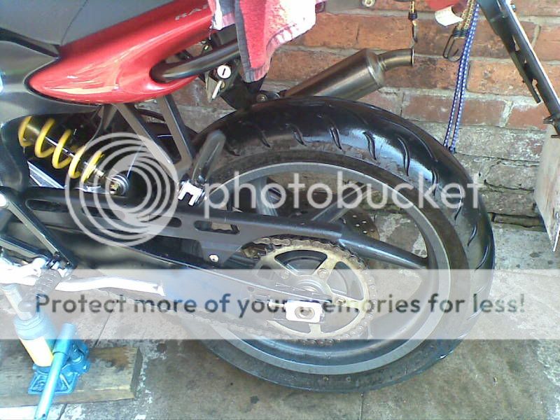

Bike on stand - wheel turning - pour it on, or apply with a brush/sponge.

Rapdude wrote:
Over it, or wheel in a container ... ?? Confused
If you can get the wheel off then get it in the sink, when her indoors is out of the way Wink
Other than that, brush water onto the wheel as you rotate it and watch for the bubbles.
