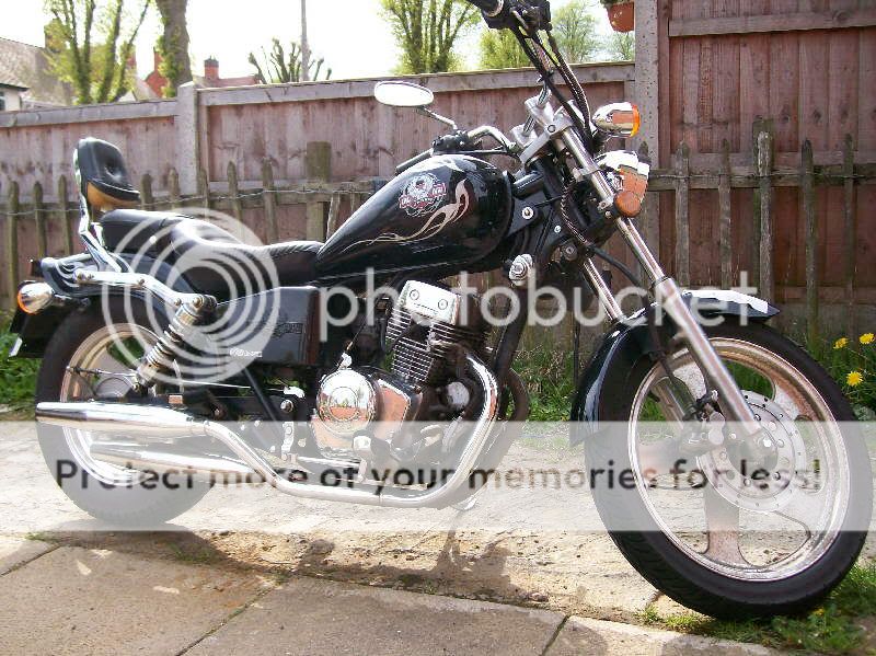

i thought i'd post a pic of the bike.
it as been restored by a member of the family who is a mechanic
after having it stolen twice in the last two week of 2007
and left to rot for three years
https://www.facebook.com/photo.php?pid=5033511&l=723d3d65dc&id=510106917

Thats the same as a bike i used to see every day, except the one i saw was always parked outside and was bright orange with rust. The finish on the metal parts isn't great, so spraying a little WD40 / Grease / oil on the metal parts now and then throughout the winter would be a good idea Thumbs Up

I did a google search on the model & It chucked up a pic of a dirt-bike! that, though looks more like Snow-Tigeress's old AJS Raptor, but with single pot motor.
https://i178.photobucket.com/albums/w269/teflons-torque/Little%20Dreams/100_0067.jpg

+ the pic is of the bike after it had being stolen and restored.
