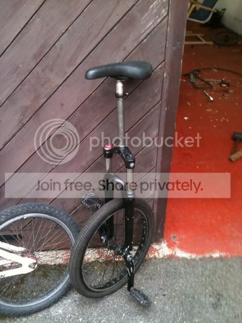

Smoked far too much doob and thought making this would be funny. Laughing

ha ha ha, good effort. you tried it yet?
JakeyR
Joined: 25 Nov 2006
PostPosted: 18:44 - 04 Sep 2010    Post subject: Reply with quote
Yeah it does work, got a puncture straight off so changed the tube and gave it a go, its pretty hard with the suspension though, need lockout on them lol.

Not much clearance between the pedals and the ground. Plenty of space for a bigger wheel though Wink
JakeyR
Joined: 25 Nov 2006
PostPosted: 20:30 - 04 Sep 2010    Post subject: Reply with quote
I know but it'd look real odd with a 26in wheel on it, plus itd be too tall it's already borderline. Laughing

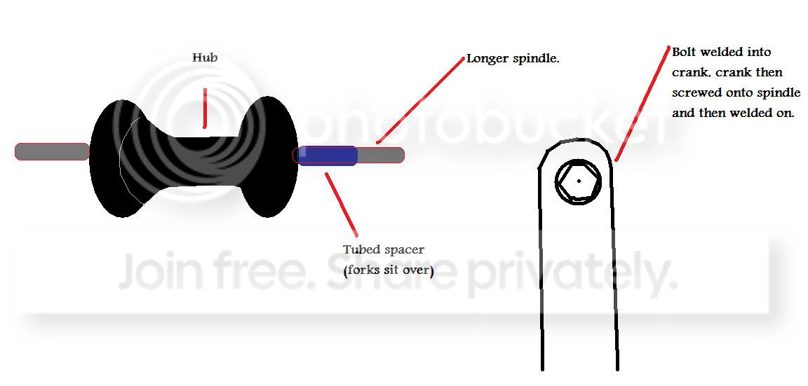

How do the pedals turn though, are they bolted to the outside of the forks? Maybe I'm just really tired and hungover but I fail to see how the wheel turns? Shocked

MS Paint diagram of how it works. Laughing
https://i222.photobucket.com/albums/dd116/JakeR600/unicycle.jpg
A mate of mine used to do unicycle trials, that shit was crazy.
EDIT: Nut welded into crank, not bolt. Laughing

Would these fit onto an axle and therefore eliminate the need to weld a nut into a crank?
I'm looking for an easy way out lol, and a cheaper alternative to a proper unicycle Laughing
Unicycle Crank Arms
Cheers,
Steve
PostPosted: 12:25 - 06 Sep 2010    Post subject: Reply with quote
No - they are just like normal crank arms as far as I know.
