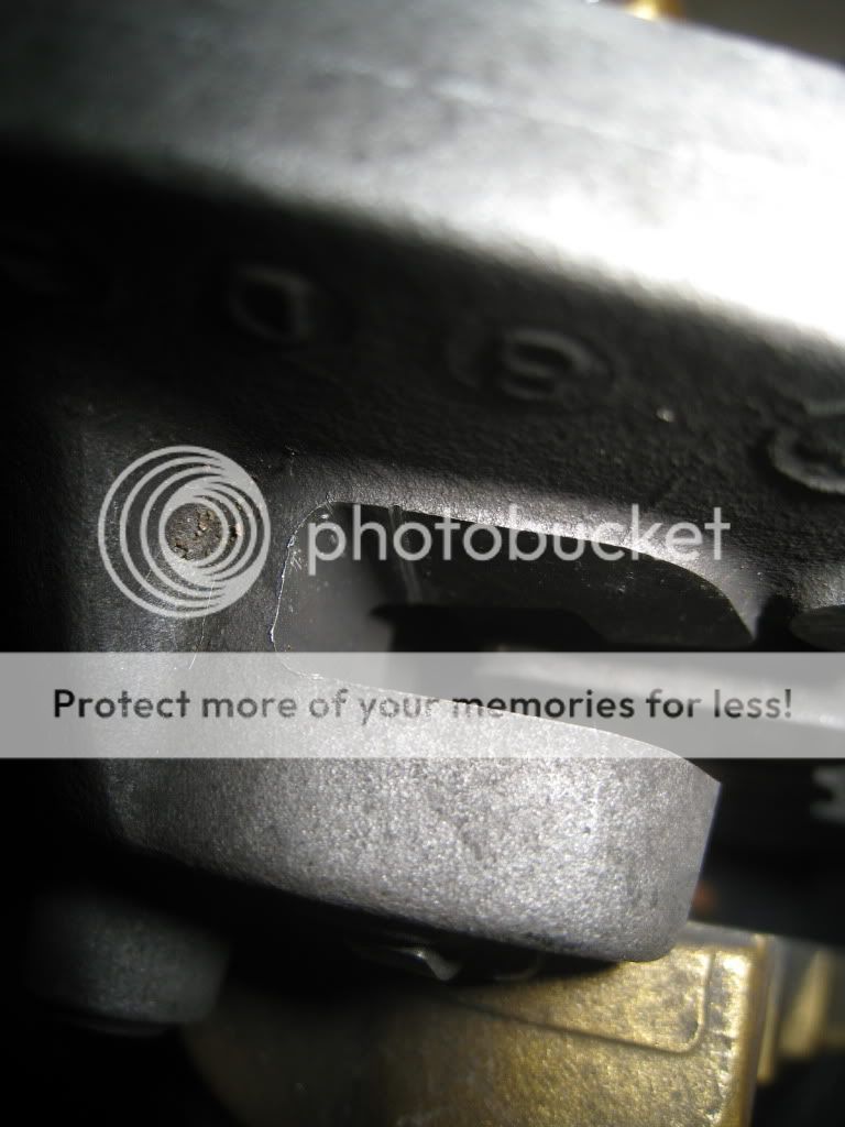

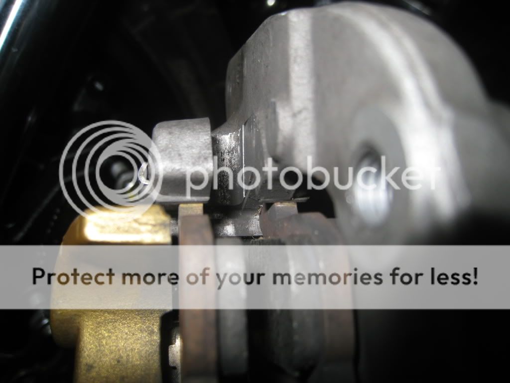

The pads look fine to me. They've done 3000 miles.
https://i951.photobucket.com/albums/ad356/AdrianP2201/Hornet%20Crash/IMG_1557.jpg?t=1284902013
https://i951.photobucket.com/albums/ad356/AdrianP2201/Hornet%20Crash/IMG_1559.jpg?t=1284902338
I don't know how to describe this but it is as if the pad is not coming out enough. Where that silver straight line is that's where the disc is touching...

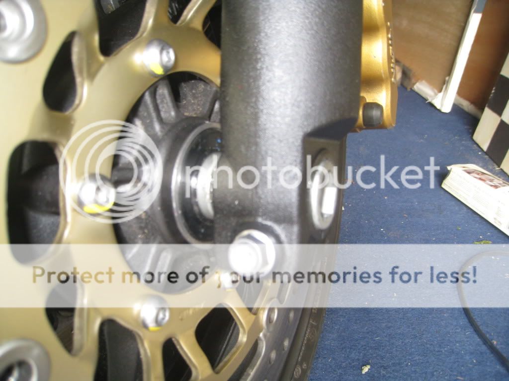

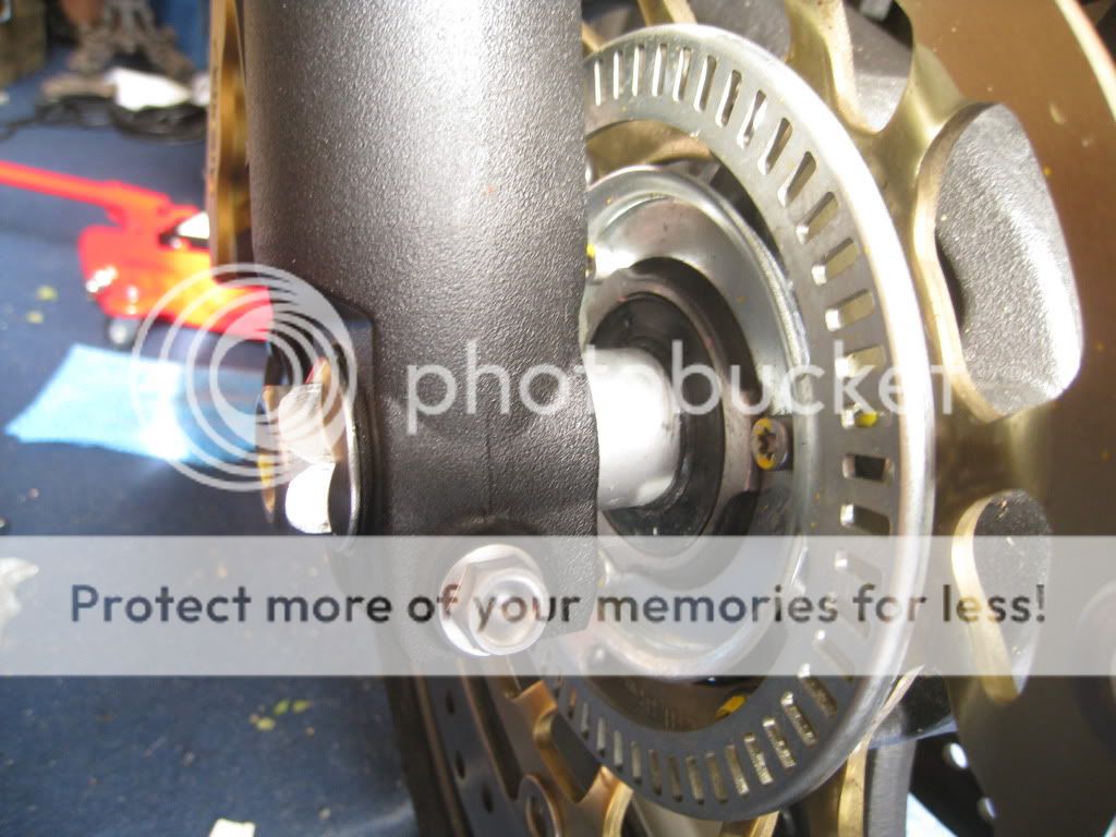

yen_powell wrote:
The only way I can make my bike front wheel do that is if I don't put it back on straight. How is your front axle fitted, does it have clamp at one end?
Here it is mate.
https://i951.photobucket.com/albums/ad356/AdrianP2201/Hornet%20Crash/IMG_1565.jpg?t=1284903877
https://i951.photobucket.com/albums/ad356/AdrianP2201/Hornet%20Crash/IMG_1562.jpg?t=1284903893

Pete.
PostPosted: 13:51 - 19 Sep 2010    Post subject: Reply with quote
1888 wrote:
No chance you forgot to put a spacer back in or at the wrong place. the whole thing looks close to me.
Yep the wheel is spaced wrong. If your two spacers are of different length, you might have put them the wrong sides.

PostPosted: 14:54 - 19 Sep 2010    Post subject: Reply with quote
Done it. Very Happy
The spindle wasn't pushed in enough.
Had to hammer it in a bit with the mallet.
