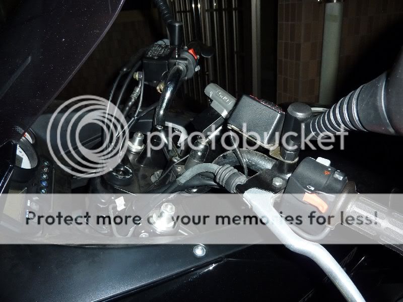

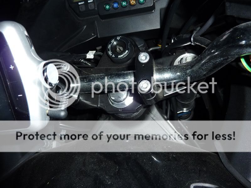

Can you undo the bolts holding the bar clamps and swivel the bars back towards you?
londonbill This post is not being displayed because the poster is banned. Unhide this post / all posts.
kawashima
Joined: 03 May 2005
PostPosted: 14:00 - 26 Sep 2010    Post subject: Reply with quote
I think I can do it!!
Bike tool kit didn't have hexagon wrench for that bolt, I will buy wrench set and try it!!
Thanks!!
https://i21.photobucket.com/albums/b295/kawashima_/fromtop.jpg
https://i21.photobucket.com/albums/b295/kawashima_/fromside.jpg
