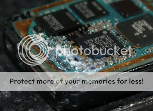

Clean off the board with water and a toothbrush
Use hairdryer on it, high heat, low fan and cook it for a few mins, it can, does and has dry out the board but also depending on how hard you try can re solder joints but try not to remove components by blowing them away.
Her's one i made earlier.
The older phones used to take it well, built like bricks, new phones are a bit too weak to handle the abuse.
https://i370.photobucket.com/albums/oo141/bramble43/Dsc02288-500.jpg
https://i370.photobucket.com/albums/oo141/bramble43/Dsc02290-500.jpg
https://i370.photobucket.com/albums/oo141/bramble43/Dsc02292-500.jpg
