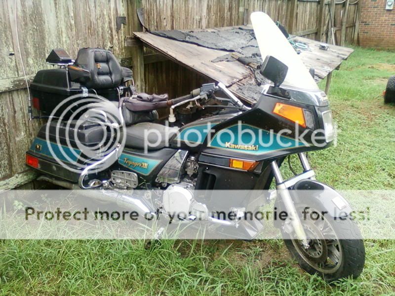

OK, another one followed me home. Actually several have followed me home since I last posted, but all were for part out or repair / resale........... till this.
First off, it's a freakin touring bike, but I want one for certain 2500+ mile trips I have planned, so I bought it.
https://i583.photobucket.com/albums/ss279/Volvacious/Cycles/downloadfile-1.jpg
It's in need of a decent set of carbs (these are repairable, but would rather find some that some gorilla hasn't already had holt of), starter solenoid, backrests need recovered, clutch needs redone (easiest part of it all) and it's in SERIOUS need of a good clean and polish.
Previous owner noticed the clutch slipping at hard acceleration and just parked it last fall....... sadly, out in the weather.
After some tinkering and cleaning of the fuel tank and removal / cleaning of the carbs, it runs, but really needs a better set of carbs to rebuild. I can use the ones I have if I can't find a set decent enough, just don't want to.
Anyway, I'll be posting up a project thread on her when I get some more parts (cash) collected up.

It's a 1993 Kawasaki Voyager 1200, big brother to the Concours.
Weird Kaw/clairion stereo, elec. cruise control, giant bags and trunk, monster tiller bars, onboard adj. air ride.................. and well, it's certainly different! lol
Pic shows it as it sat when I bought it. It looks no better now Smile

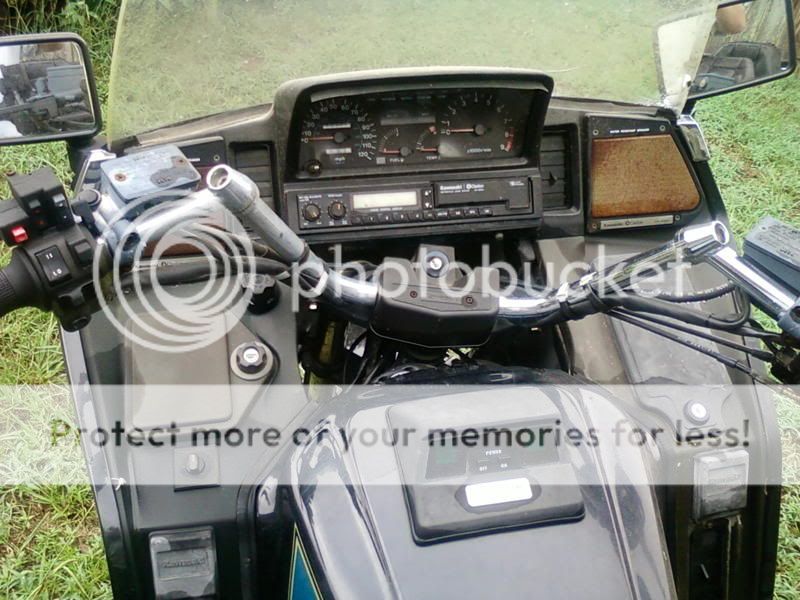

Oh, a pic to show how much crap the factory can shove in a fairing. (This is the big brother to the concours for comparison).
https://i583.photobucket.com/albums/ss279/Volvacious/Cycles/downloadfile-4.jpg
