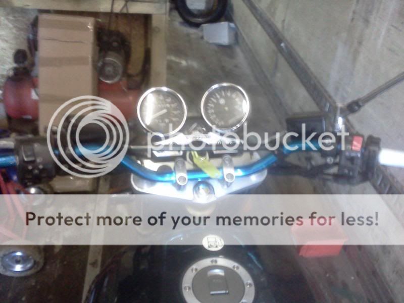

so today i picked it up and inspected the damage
bent bars altho not obvious in this pic
https://img.photobucket.com/albums/v336/mad4it028/IMG20101020_001.jpg
clocks and lights
https://img.photobucket.com/albums/v336/mad4it028/IMG20101020_003.jpg

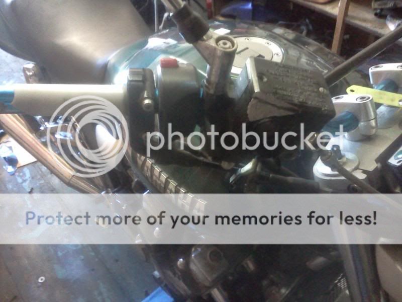

front master cylinder and throttle
https://img.photobucket.com/albums/v336/mad4it028/IMG20101020_004.jpg

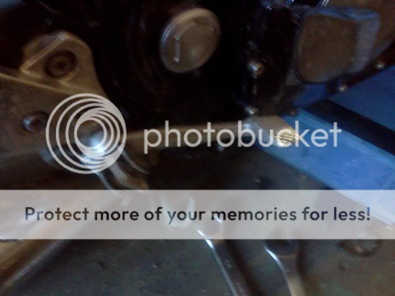

right peg and brake lever
https://img.photobucket.com/albums/v336/mad4it028/IMG20101020_005.jpg
so then i set about putting it right with parts of other bikes i already have

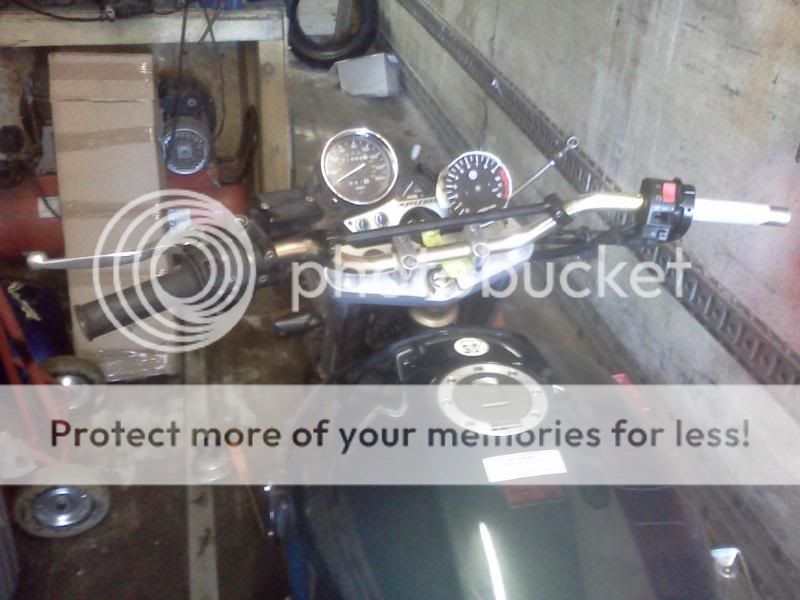

1st up handle bars off a honda dominator
https://img.photobucket.com/albums/v336/mad4it028/IMG20101020_006.jpg

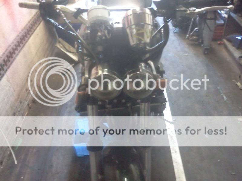

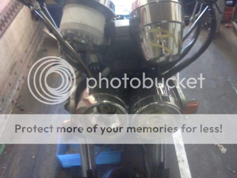

headlights off an old streetfighter i broke
https://img.photobucket.com/albums/v336/mad4it028/IMG20101020_007.jpg
straghtend the brake lever carfully with a spanner and levers
https://img.photobucket.com/albums/v336/mad4it028/IMG20101020_008.jpg

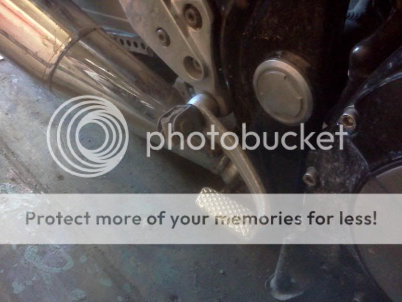

i also fitted a bandit footpeg which was almost identicle to the xjr and had a go round the yard.
to my disapointment the bars still sat to the left bugger bent forks i thought
so put kettle on and had a think,i know losen off the yokes centralise the front wheel and retighten
took it up the lane its now perfect engine is smoth and strong,
needs indicators fitting and mot and shes good to go and im a happy man oh and clocks of course
