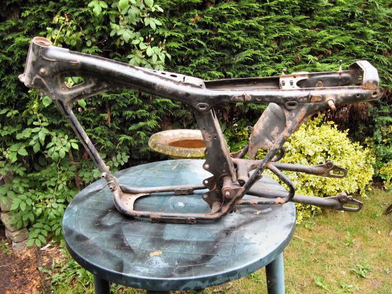

Thanks for the replies. As requested here's a pic of the stripped down frame prior to cleaning up - ye gods what a mess, but it's solid and salvageable.
https://i232.photobucket.com/albums/ee135/warsteiner_yzf/Frame0.jpg
Swinging arm had still to be removed - resisted all efforts including heat, large hammer, soaking with diesel even a piece of scaffolding pipe levering the wrench wouldn't shift it - final solution was to cut it out which meant losing the pivot bolt.

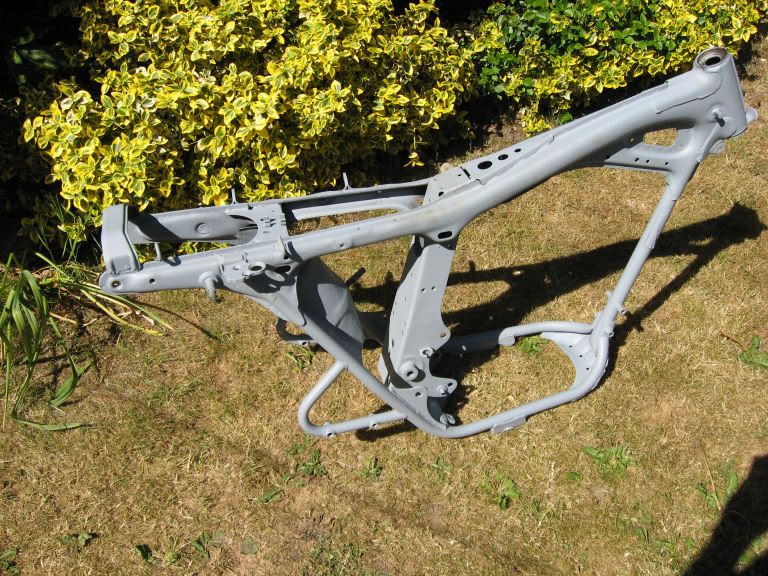

The frame is now hanging in the garage being painted. but here's a pic of it primed
https://i232.photobucket.com/albums/ee135/warsteiner_yzf/Frame1.jpg

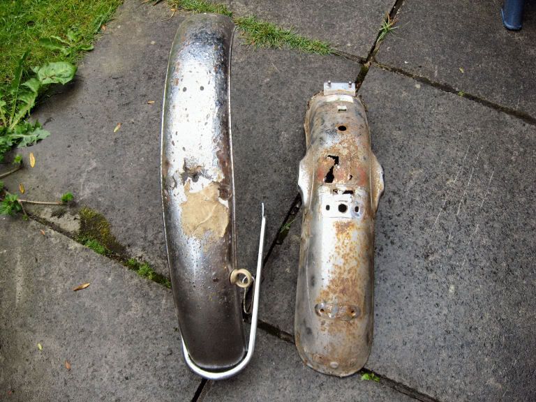

BONUS pic of err-um absolutely wrecked mudguards
https://i232.photobucket.com/albums/ee135/warsteiner_yzf/Mguards1.jpg

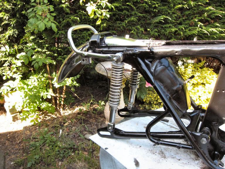

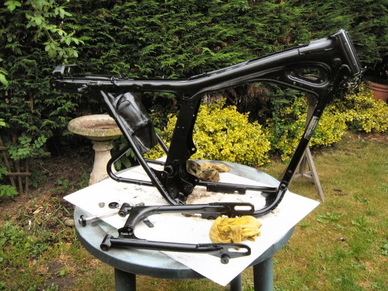

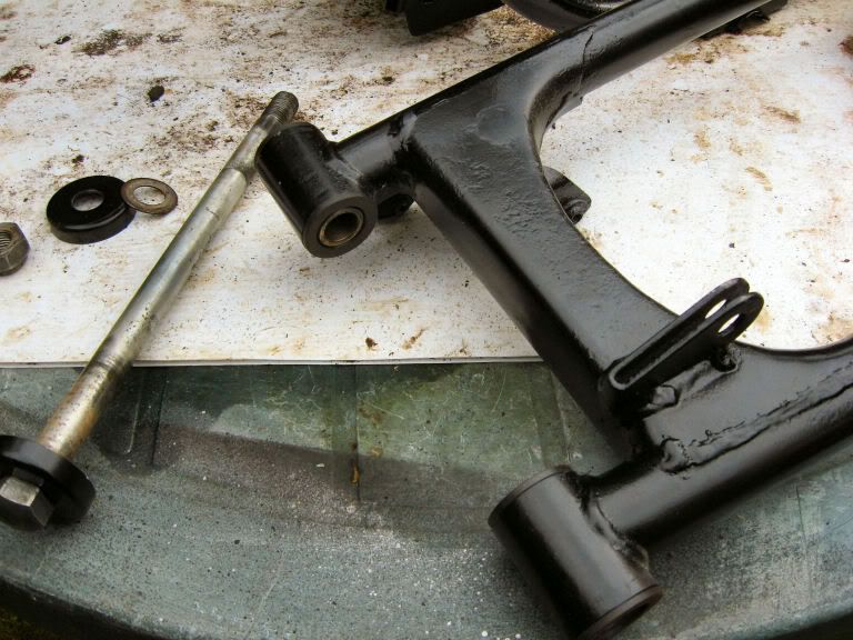

The frame and swinging arm have been painted (aerosols)and having got my swinging arm pivot bushes - 4 off - from David Silver (£25 incl delivery) I pressed them into place using a vice and a couple of blocks of wood. Luckily the steel pivot sleeves although not A1 are serviceable - a good job really even Silver's can't get them, I would have to have got an engineering shop to knock a couple up. Withe the pivot itself torqued up there appears to be no play so pretty pleased with that.
https://i232.photobucket.com/albums/ee135/warsteiner_yzf/Frame02.jpg
https://i232.photobucket.com/albums/ee135/warsteiner_yzf/swingarm.jpg
Now it's onto more reassembly - the rear shocks I got from Ebay for £15 - original Showa and are very clean.
I have also bolted on a rear mudguard, also from Ebay, that set me back £60 but is well worth it - it's super clean, I believe the seller imports used parts from America.
https://i232.photobucket.com/albums/ee135/warsteiner_yzf/assembly.jpg
The front mudguard may be more of a problem, they REALLY are rare, but I may have a solution a mate gave me an old mudguard off a Honda CB250 (G5?) and it is about the right size - my plan is to cut off the mounting stay and Replace it with the stay off my knackered CB200 mudguard- will it work ? Dunno yet!!!

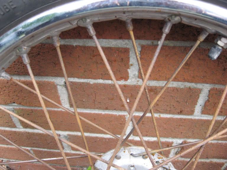

I have also had a go at cleaning up the wheels - the spokes are rusted to hell. I started by rubbing them with steel wool soaked in distilled vinegar then moved onto coarse wet'n'dry paper and solvol and finshed off cleaning up the spoke nipples with a sand blaster - not perfect but it'll do. NOTE this is a "before" pic
https://i232.photobucket.com/albums/ee135/warsteiner_yzf/wheel.jpg

Thinking about the spokes!.
What I did with mine on an old GT250 was similar to what you have done.
I then lacquered them once they were shiny.
was`nt the best solution, but it did keep them servicable for a few years and kept a bit of the rust at bay. Thumbs Up
