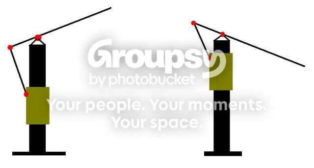

Looks like a class 1 lever to me.
You have a pole with a pivot at the top. Lever goes across this pivot - handle at one end, connector at the over. You then have a linkage from the connector that drops down and pulls up on the 'slider' that is stuck in the frame.
Off to mspaint I goes...
MarkJ
Joined: 11 Apr 2006
PostPosted: 18:02 - 05 Oct 2010    Post subject: Reply with quote
https://i47.photobucket.com/albums/f186/markjackson13/lever.jpg
Red dots are pivots, the black bits are metal, and the gold bit is what's attached to the bike. Left diagram is the bike on the ground, right is it in the air.
Looks to me as though it's held at the top by a hole in the main post and a spring loaded pin that pops into this hole when it reaches the top.
Edit: Also, (and I think this is correct) if we look at the main handle at the top, if the handle is four times longer from the pivot than the other side then you have to put four times less effort in to lift the bike, so longer handle = easier lift

2:22 to 2:28 shows exactly how the works line up Thumbs Up
Same as in MarkJ drawing.

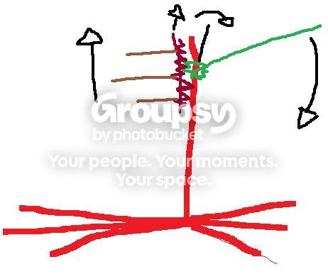

Baically, if i were going down this route, i woud make a mechanism simular to this:
https://i1183.photobucket.com/albums/x474/0l0dom0l0/PaddockStand.jpg
This is a close up of the mechanism. the gold cog is the one attached to the handle.

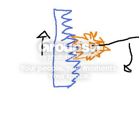

https://i1183.photobucket.com/albums/x474/0l0dom0l0/Paddockstandmechanism.jpg
the blue bit is what you would attach the tubes that lift the bike up to.
hope that makes sense.

If the cog was free to rotate that wouldn't work.

I can see it now, not sure why I couldn't before... think I was looking for some kind of clever internal mechanism, but it's actually a lot more straightforward than I thought.

I see what you mean, but I don't think it would give me quite as much lift movement as the other connected rod system. Do love the cog drawing though Laughing
