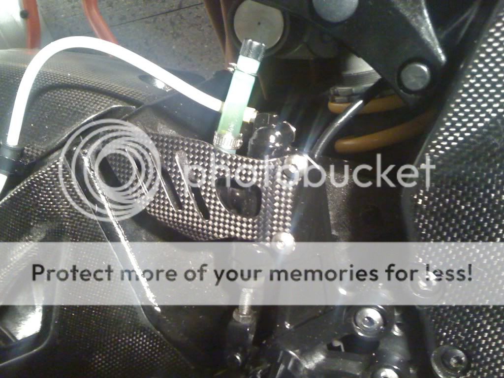

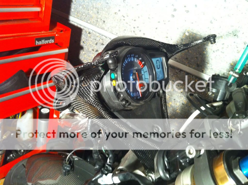

IF I had scales I'd go weigh my stock 4 inch black tube, with the reservoir on the end. I'd then go and weigh my 2 inch tube. It may on;y be a few grammes, but it's still a difference especially with somebody like me. BUT obviously it adds to the bling factor too, much better than an ugly square/pot reservoir.
On the right ---->
https://img.photobucket.com/albums/v707/lllN30lll/IMG_0694.jpg
Rear
https://img.photobucket.com/albums/v707/lllN30lll/IMG_0338.jpg

You need at least 1 inch of air in the tube to allow for when the fluid gets hot. If not, you'll do what I did and it will lock your brakes on when the fluid reaches the bung Laughing
But I have them short as it's a personal preference, I'm sure they give you about 6 inch of tube to use. Some have them 2 inch, some have them a foot long, personal preference TBH.

lllN30lll wrote:
Nice colour mod on the cluster!
