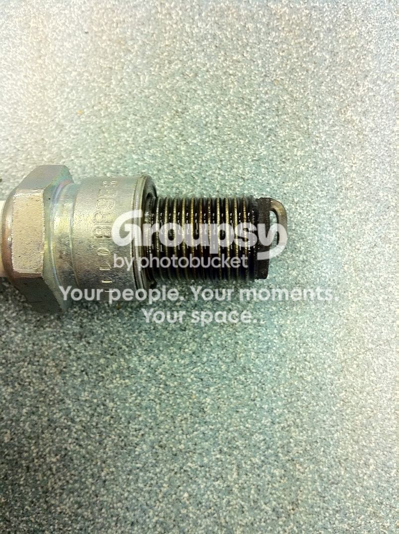

Right, checked my spark plug, looked fine to me, got a pic of it. Scrubbed it up with a wire brush and refitted, no change. Put the battery on charge over night, will fit tomorrow morning and see if its made a difference.
https://i76.photobucket.com/albums/j31/MattZani/fdbd77e1.jpg
Ok so how hard would it be for me to do the top end rebuild? would it be an engine out job? Would give me a chance to paint up the exhaust and decoke it too i guess...
