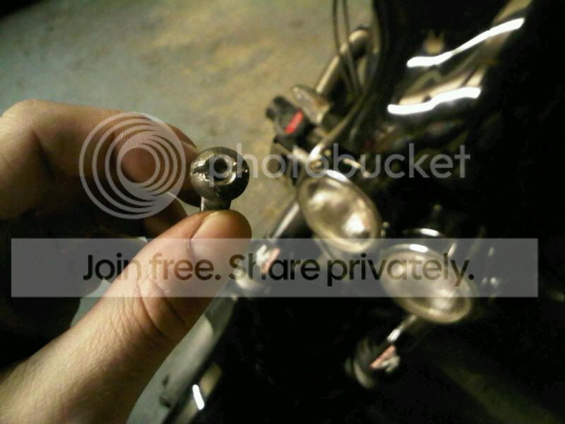

Well, due to the numpty that put on the dominator headlights onto my hornet (before i bought it), the bolts holding the headlights in are rounded off.
https://i2.photobucket.com/albums/y41/doovydoo/utf-8BSU1HMDA0NjUtMjAxMDEwMTQtMTMwNy5qcGc.jpg
I want to fit a screen, which mounts in between the headlight bracket and headlights, with the bolt holding it all in place. I also have new bolts ready to go in, i just need the old ones out!
ideas please?
I have thought of cutting a groove into the bolt head (i dont have a dremel though) and trying to undo it through that.. might try later with a small saw but dont know if it will get to it. dont want to try drilling really..
thanks in advance Smile

I have issues with this in the pasts. The easy way out with a bit of elbow grease would be to buy a good quality needle file, file to parallel flat spots on opposite ends of the nut then use a small Stilson wrench to release. https://www.google.co.uk/products?hl=en&q=Stilson+wrench&um=1&ie=UTF-8&ei=Y9HCTKTzDYyC4Aaq2-i5Aw&sa=X&oi=product_result_group&ct=title&resnum=3&ved=0CBwQrQQwAg
Other than that it's drills taps and dies.
That needle file in tool box has saved more times than I care to remember.
Good luck!
You could even file a groove straight through the middle and use an impact screw driver. Another tool that has saved me loads of times.

drill a hole straight into the center and buy a easy out.
are you sure you cant get a allen or hex key to grab there? appears to be enough to grab onto!
they are only soft bolts you could use a old flat screw driver and hammer by hitting the side of the bolt with screw driver and tap it around with the hammer.you will need to cut into the side of the bolt so the screw driver bites in while you hit it with the hammer.

Vincent wrote:
You might be able to wedge the right size torx head in there.
This.
Tapping a slightly oversize torx bit in will allow you to undo this.
I've got a set, if you need to borrow some.

thanks for replies everyone.
turns out the one in the picture had just enough left to turn with the right size allen key, but the other one is really rounded.
i have tried a junior hacksaw but due to bracket positioning and indicator placement it's not really possible.
have tried the screwdriver / hammer combination too but not really got anywhere (didnt really give a proper go)
will go for the torx bit idea! thanks nowhere.elysium, i'm slightly disturbed by your knowledge of my limberness.. perhaps i drank more that night than i remember.. Wink

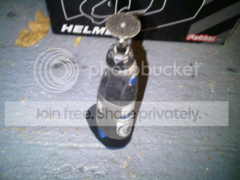

well i had another bash at it this evening.
with the help of my friend, Mr Dremel (borrowed)
https://i2.photobucket.com/albums/y41/doovydoo/utf-8BSU1HMDA0ODMtMjAxMDEwMjMtMjAzMC5qcGc.jpg
resulting in this
https://i2.photobucket.com/albums/y41/doovydoo/utf-8BSU1HMDA0ODktMjAxMDEwMjMtMjE0OS5qcGc.jpg

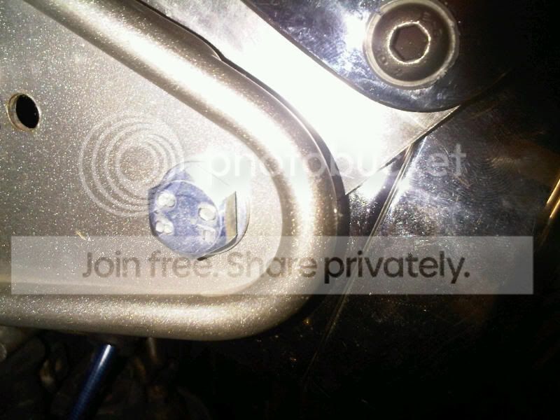

oh and just to prove i'm not as much of a 'bodge-er' as i used to be...
https://i2.photobucket.com/albums/y41/doovydoo/utf-8BSU1HMDA0OTItMjAxMDEwMjQtMjA1MC5qcGc.jpg
new headlight bolt (both sides too!!)
