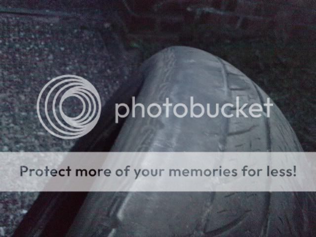

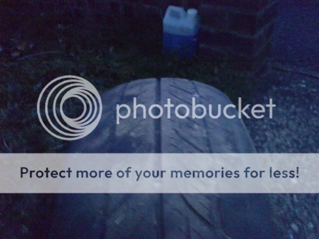

Tyres: Fronts seem to wear the outside edges, rears wear evenly allover. When i bought the car, it had old tyres on so i could see the wear easily. Fiestas tend to have bad camber issues when the front lower arms go, this would show on the tyres. I have obviously put decent tyres on now.

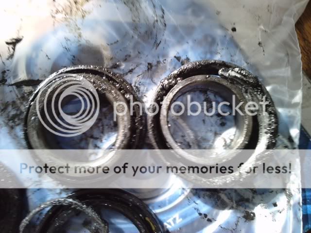

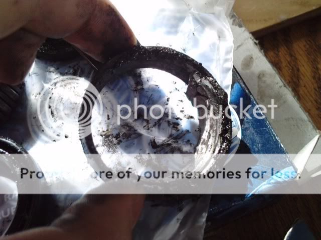

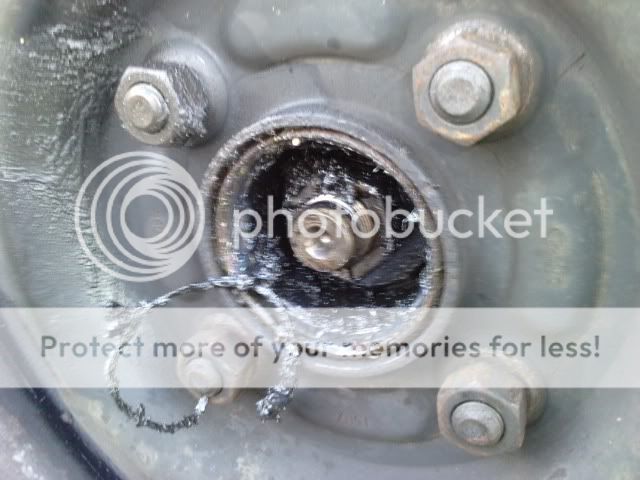

Ive taken it to 2 different garages now.
The one that collapsed ive still got. The other one that went, but didnt collapse i threw away :/

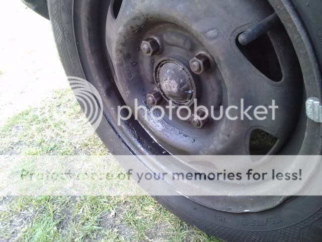

https://i279.photobucket.com/albums/kk125/MartayP/P110510_16280001.jpg
^grease run down wheel^
https://i279.photobucket.com/albums/kk125/MartayP/P110510_08490002.jpg
https://i279.photobucket.com/albums/kk125/MartayP/P110510_16270002.jpg
https://i279.photobucket.com/albums/kk125/MartayP/P110510_16270001.jpg
^you can just make out melted/worn out rollers in there ^
Tyres that came off front when i bought the car.
https://i279.photobucket.com/albums/kk125/MartayP/P170410_20260001.jpg
https://i279.photobucket.com/albums/kk125/MartayP/P170410_20270001.jpg
