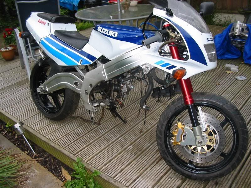

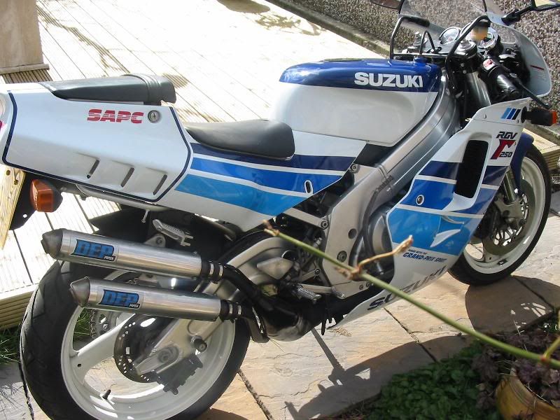

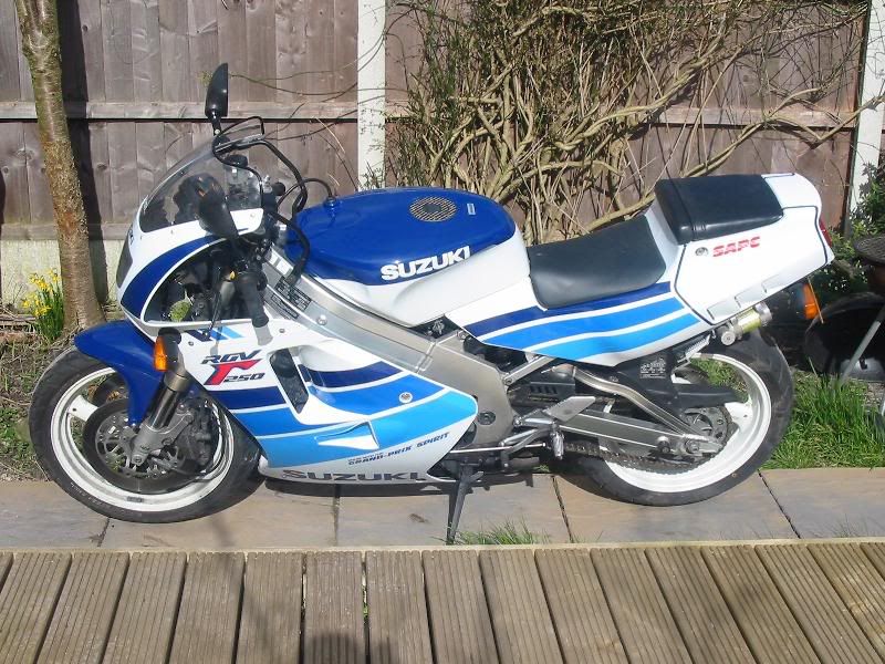

I have a few RGvs in various states of disrepair, this M model Vj22 I bought for £650 18 months ago, it needed as new rear tyre and then went straight through the MOT. I rode it for a few thousand miles and then it blew a head gasket. While I was replacing the head I thought I would treat it to a new top end. I also modified the power valves as one of the pins was loose.
https://img.photobucket.com/albums/v106/gixerboy1/rgv.jpg
https://img.photobucket.com/albums/v106/gixerboy1/right.jpg
Now I am ready to put the engine back, in I decided to start on a project to make the bike lighter and a little more modern looking while keeping the rgv shape. The earlier RGV weighs 8kg less as standard, while this model has steel subframes, so I thought I would put it on a diet and see just how much weight could be lost.

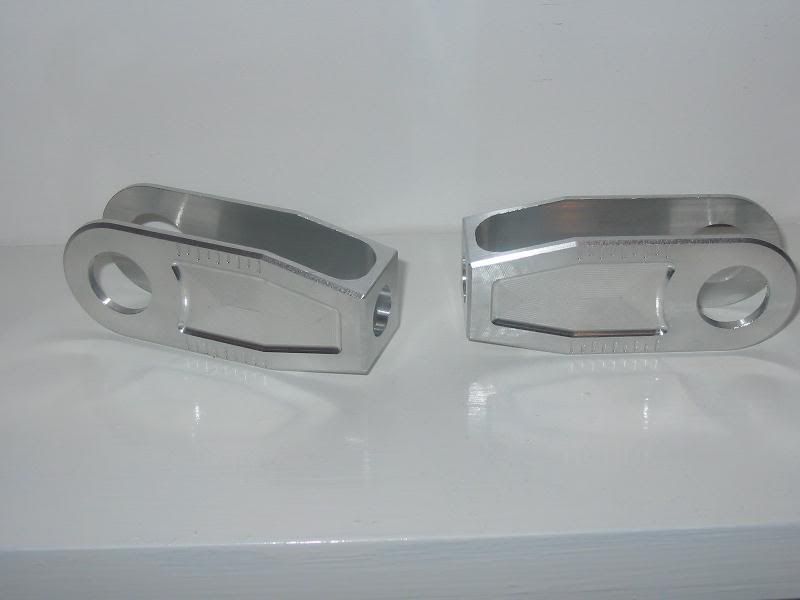

I also fitted a set of aluminium chain adjusters that I made (200g saving)
https://img.photobucket.com/albums/v106/gixerboy1/chainadjusters.jpg

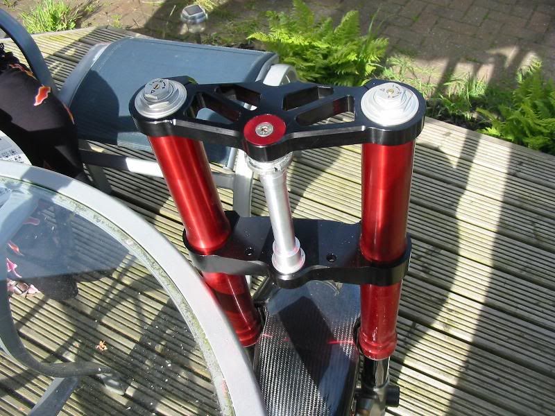

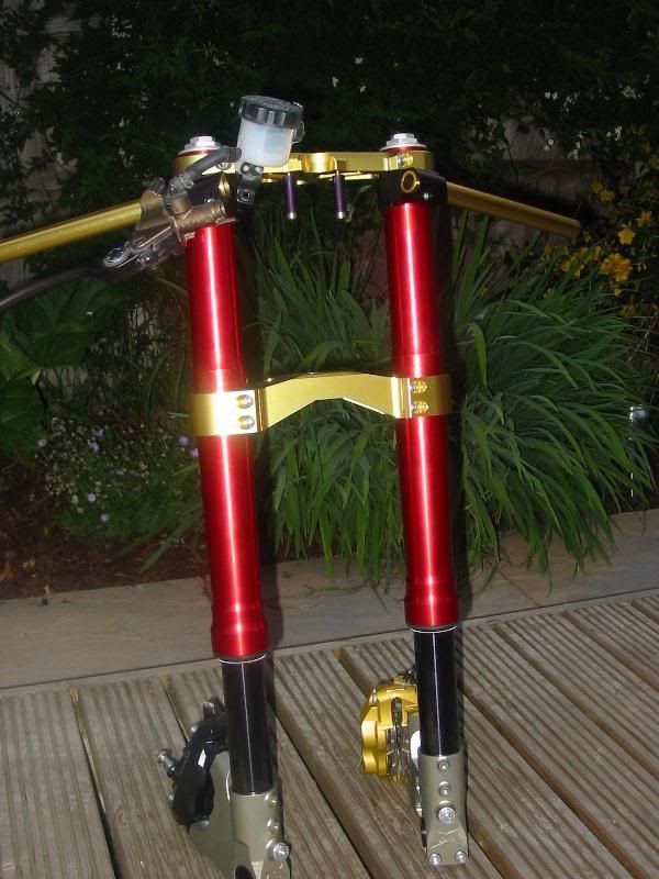

I decided to use a set of Aprilia RS250 wheels(not weighed them yet) and a set of Marzocchi forks (2kg saving) I had on one of my other rgvs. I made the yokes to hold the forks (a weight saving of 1.8kg) and turned the wheel spacers.
https://img.photobucket.com/albums/v106/gixerboy1/rswheels.jpg

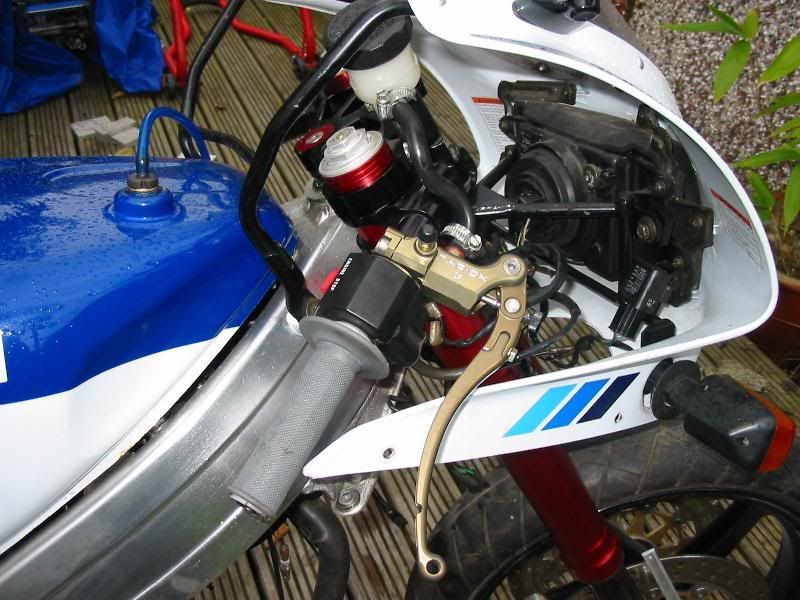

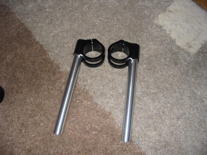

I also fitted a set of clip ons I made (580g saving) and a radial master cylinder I got from ebay cheaply.
https://img.photobucket.com/albums/v106/gixerboy1/master.jpg
https://img.photobucket.com/albums/v106/gixerboy1/anoclips.jpg

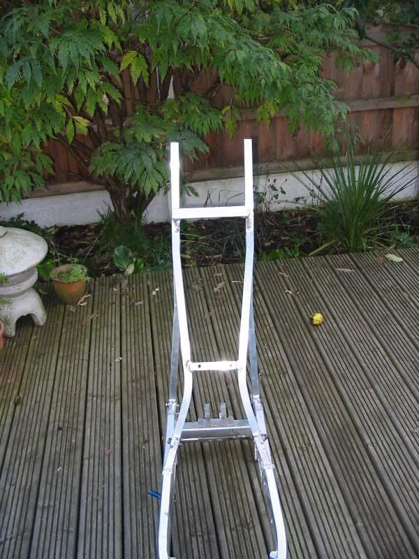

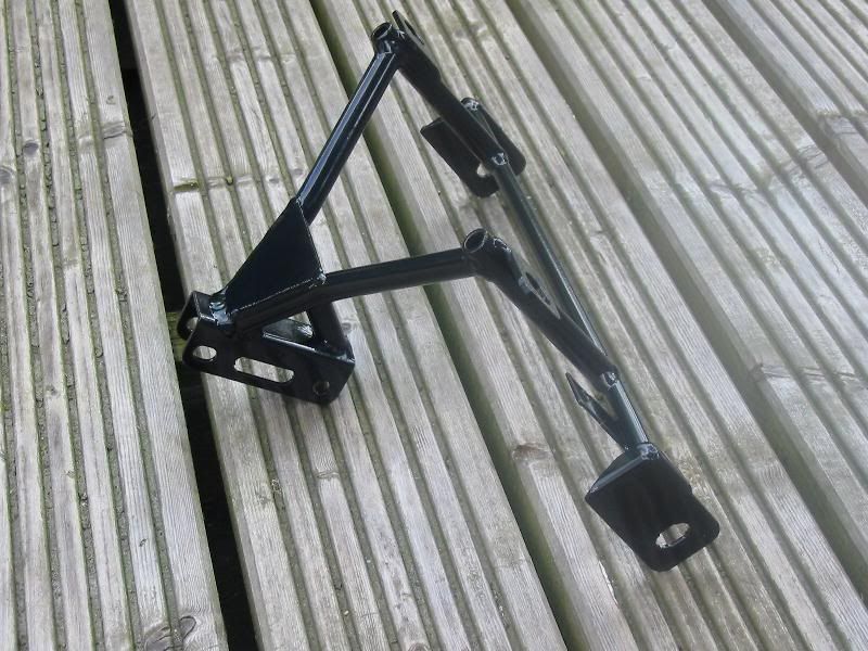

The Aprilia wheels weigh less than the Suzuki ones, I would be tempted if a set of Tz magnesium wheels turned up at the right price but cant really afford a set of wheels new. I am halfway through making an aluminium subframe already. I already have a few things on the go to get rid of some of the heavier road stuff, but will post when its fitted.
https://img.photobucket.com/albums/v106/gixerboy1/subframe2-1.jpg
https://img.photobucket.com/albums/v106/gixerboy1/subframe.jpg

You MADE those chain adjusters and clip ons?! F**k me they're pretty pukka!
Got a close up of the yokes as well?
I'm assuming you work in a metal working shop of some kind Wink
I like the look of those forks and new callipers and discs on the front as well Drooling
https://img.photobucket.com/albums/v106/gixerboy1/blackyokes.jpg
https://img.photobucket.com/albums/v106/gixerboy1/blackyokes1.jpg
And here they are when I had them anodised gold. Bit too bling though so I had them redone in black.
https://img.photobucket.com/albums/v357/gixerboy2/forks1.jpg

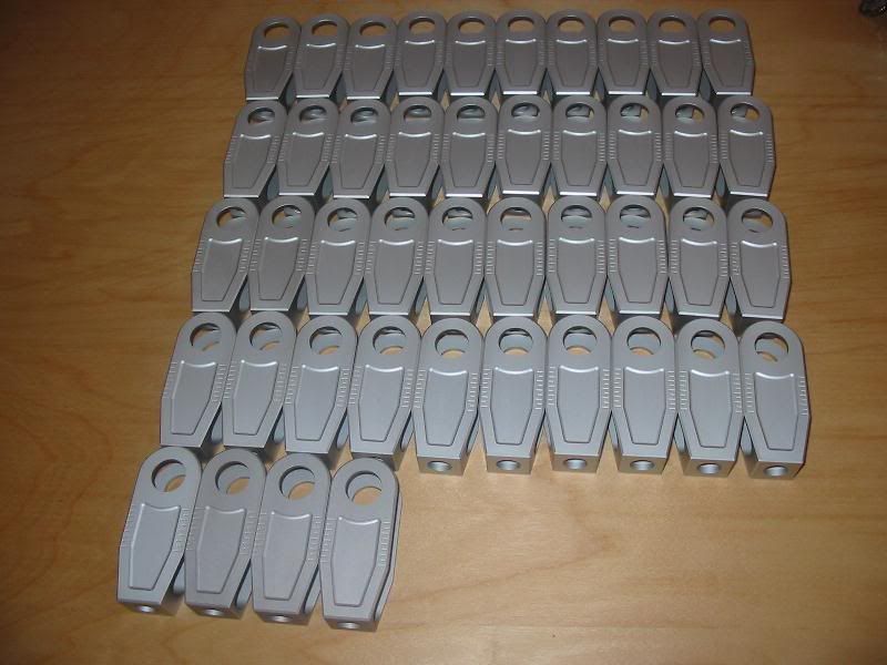

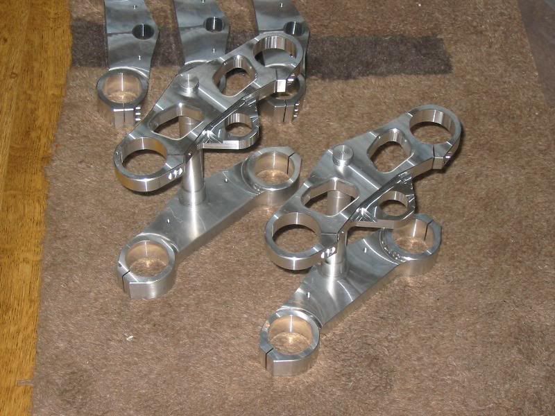

I used to do a bit of batch work, but I tend to just design the stuff that I sell and send it out to be made, I only make parts for my own bike now.
These are some of the things I made to sell.
https://img.photobucket.com/albums/v106/gixerboy1/yokes1.jpg
https://img.photobucket.com/albums/v106/gixerboy1/d083aec4.jpg

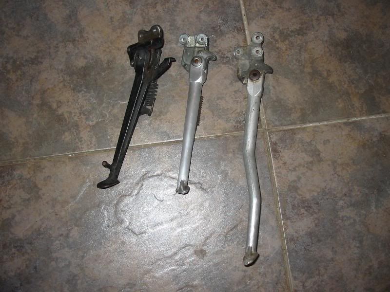

I have finished modding the mito stand and that will be fitted at the weekend:
https://img.photobucket.com/albums/v106/gixerboy1/sidestand.jpg
The stand on the left is the standard RGV one, the one in the middle is the mito stand I have modified and the one on the right is a standard mito one. The Modified one weighs less than half the standard RGV stand.
I have had a bit more welding done to the aluminium subframe. A few more brackets have been put on and some of the mounting points for the bodywork. The battery box has also been put on. The engine has been rebuilt and is ready to go back in the bike now.
https://img.photobucket.com/albums/v106/gixerboy1/subframe5.jpg

i fitted the mito sidestand to mine and i get a 1kg weight loss.
