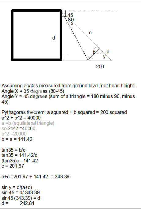

https://i48.photobucket.com/albums/f216/stinkwheel/trig.png
Fukin' maths!
Stinkwheel used his head, (but a scientific calculator, not Trig tables)
EDIT: Also. I've drunk 5 pints of magners.
EDIT 2: I should also add, it's been 16 years since I did maths and I also claim full marks for showing my working.

Slightly different method to Stinkwheel
Although I guess I lose marks for not using a ruler Mad

Awesome SOH/CAH/TOA mnemonic Very Happy
