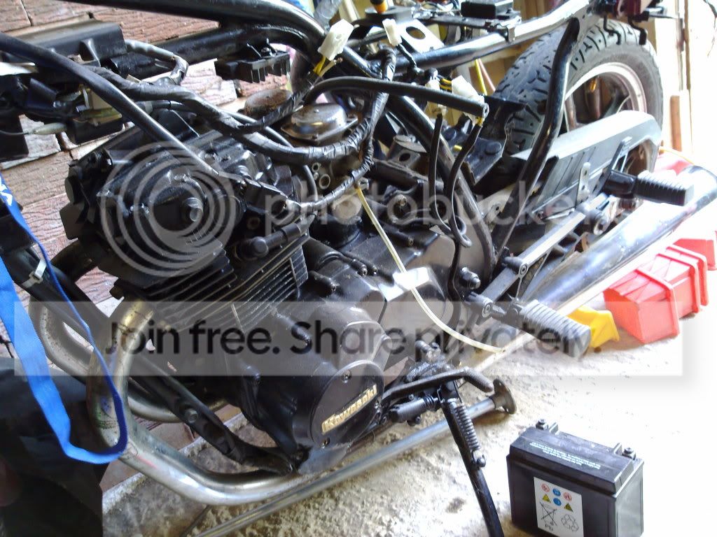

I recently aquired a 1990 Kawasaki er 250 twin scorpian. The bike is in good condition apart from the electrics, there is barely any rust and only surface rust in small areas. It is missing a few bolts, was not running and has been stood for a number of years
partially stripped down to see whats needed
https://i515.photobucket.com/albums/t353/franscorsac/02052010145.jpg
The bike only has 15k miles on the clock and the engine is looking clean.
https://i515.photobucket.com/albums/t353/franscorsac/02052010147.jpg

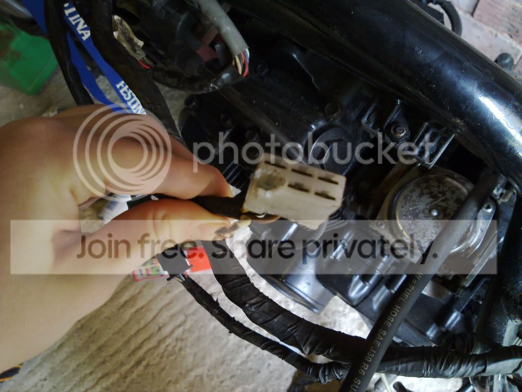

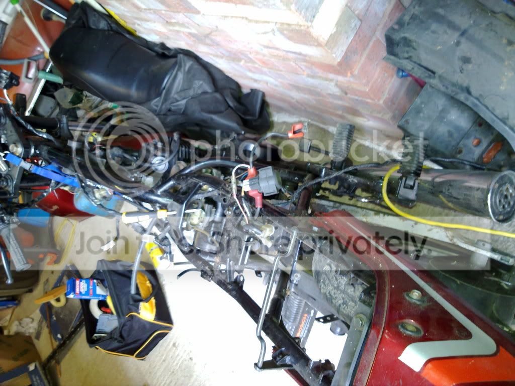

there were major problems with the electrics, lots of botching had been done to the loom meaning there was no ignition, no sign of life at all which i have now fixed, just need to re wrap the wires to make them waterproof which I will do at a later date incase more work needs doing.
https://i515.photobucket.com/albums/t353/franscorsac/02052010139.jpg
https://i515.photobucket.com/albums/t353/franscorsac/Photo-0094.jpg

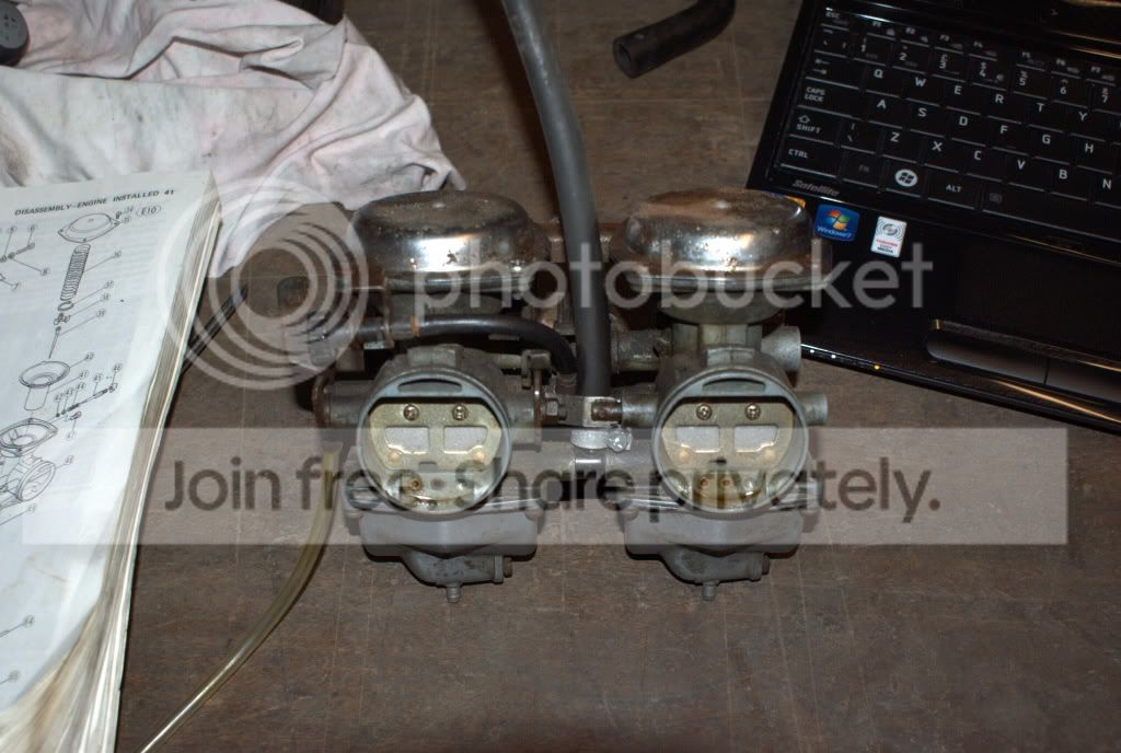

Also i need to take the carbs off to give them a good clean, and to also attach the acceleration and deacceleration cables to the carb as these are disconnected ... I need to know , are the two cables are the same? just normal throttle cables? as I only have 1 at the moment.
I have removed the air box and breather tube, I now need to disconnect the carb from the block ... the manual shows it being connected via a jubalee type clamp
https://i515.photobucket.com/albums/t353/franscorsac/Bike%20restoration/DSC06695.jpg
when looking at the carbs however they seem to be connected via a screw either side
https://i515.photobucket.com/albums/t353/franscorsac/Bike%20restoration/DSC06673.jpg
these are in such an awkward place i cant get a screwdriver or bit in at the right angle to undo them ... any ideas?

Someone did them up, so I guess you need a different screwdriver.

Looks like the jubilee type clips are missing so nothing holding the carbs on at the moment. The screws I think you are referring to hold the carb rubbers to the engine and do not need to be removed to take the carbs off (and once the carbs are off they should be easy to undo if you need to).
As to dropping nuts into the tank, thread them loosely on some string before putting them in, and keep hold of the string.

Not sure nuts will actually remove the loose rust from inside the tank, it just gets the flakey bits off of the inside metal of the tank, not sure how to remove it from the tank completely!
Also as kickstart said, it looks like the jubilee clips are missing so the carbs should pop out of the rubbers with a little wobbling. Jubilee clips would be where the arrow is pointing.

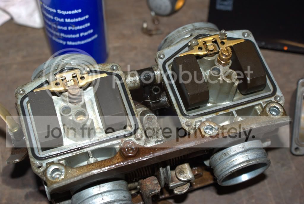

ok so I got the carbs to strip and clean
https://i515.photobucket.com/albums/t353/franscorsac/Bike%20restoration/DSC06703.jpg
https://i515.photobucket.com/albums/t353/franscorsac/Bike%20restoration/DSC06704.jpg
According to the manual this pipe is a breather pipe ... the over flow pipes are missing and the other breather tube is missing so im guessing i need to get some new ones
Ok so when i opened the bowls, the left bowl and float is completly bone dry where as the other is soaked ... does this mean the jets are blocked?
https://i515.photobucket.com/albums/t353/franscorsac/Bike%20restoration/DSC06708.jpg
https://i515.photobucket.com/albums/t353/franscorsac/Bike%20restoration/DSC06710.jpg
I have never cleaned a carb before, i am just doing this from reading so any advice would be great. I took out the floats and the little piece that fits on to them

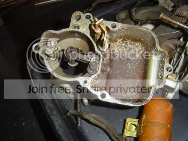

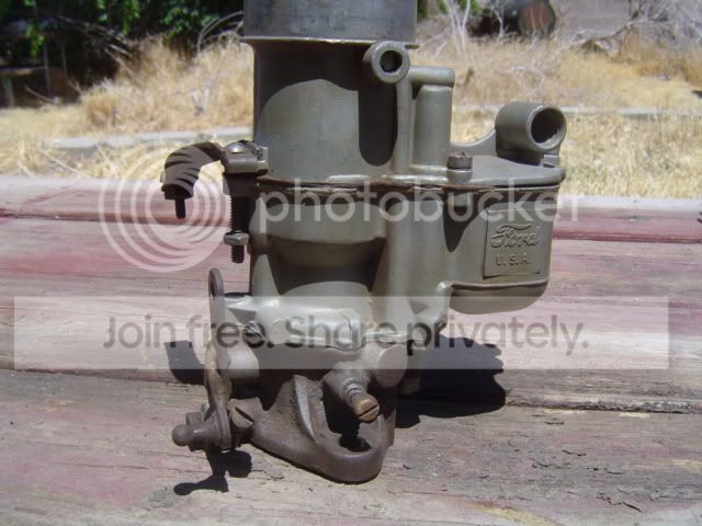

I use a homemade $5 soda blaster for cleaning carbs... This is from my '43 Ford.
Before:
https://img.photobucket.com/albums/v317/ZRX61/G8T%20Project/5-19-10-8T012.jpg
https://img.photobucket.com/albums/v317/ZRX61/G8T%20Project/G8TCarb003.jpg
https://img.photobucket.com/albums/v317/ZRX61/G8T%20Project/G8TCarb005.jpg

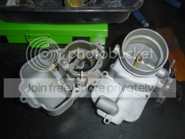

After:
This pic is after plasticbead blasting, the other 2 are after soda.
https://img.photobucket.com/albums/v317/ZRX61/G8T%20Project/5-19-10-G8T001.jpg
https://img.photobucket.com/albums/v317/ZRX61/G8T%20Project/G8TCarb009.jpg
https://img.photobucket.com/albums/v317/ZRX61/G8T%20Project/G8TCarb010.jpg

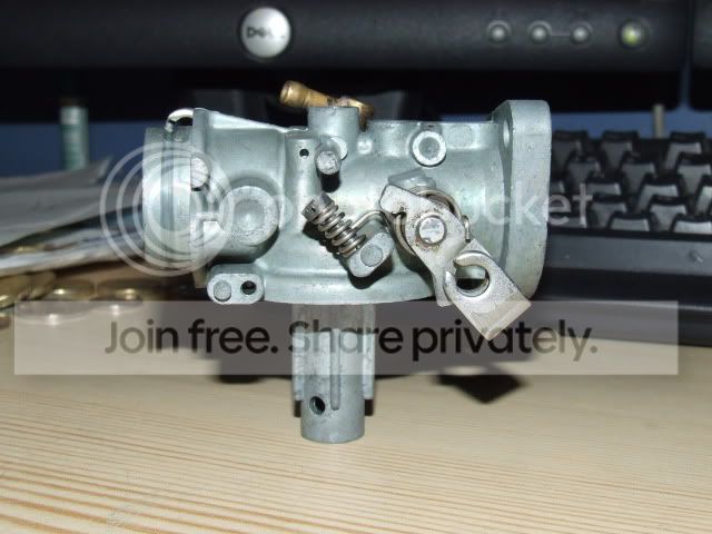

This is my Chaly carb after an ultrasonic clean in cola:
https://i15.photobucket.com/albums/a376/ms51ves3/DSCF2837.jpg
