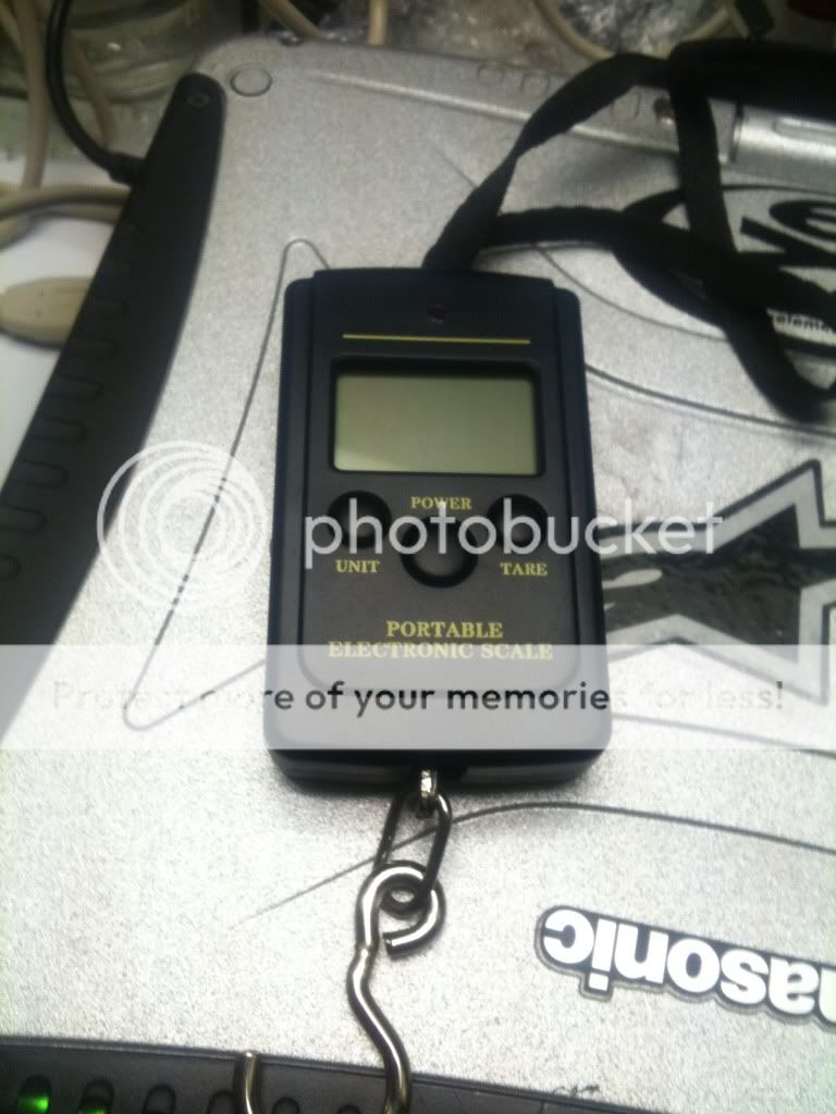

ive bought myself a £5 hand held digital scales. apparently from hong kong, which arrived today. I took it apart to have a nosey at it. The build of the strain gauge lever isnt what i expected but will benefit me as i can make the parts i need to fix into the gear linkage then bolt is in place. (you will see by the pictures)
so first things first. I gave it a 3v supply and hooked my work bag on it for a test. 10.77kg. so when i have it hooked up i can use that as a general reference. not that im interested in any specific weight value.

step one, get the digital scales
https://i1112.photobucket.com/albums/k493/steven_191/strain%20gauge%20quickshifter/IMG_1018.jpg

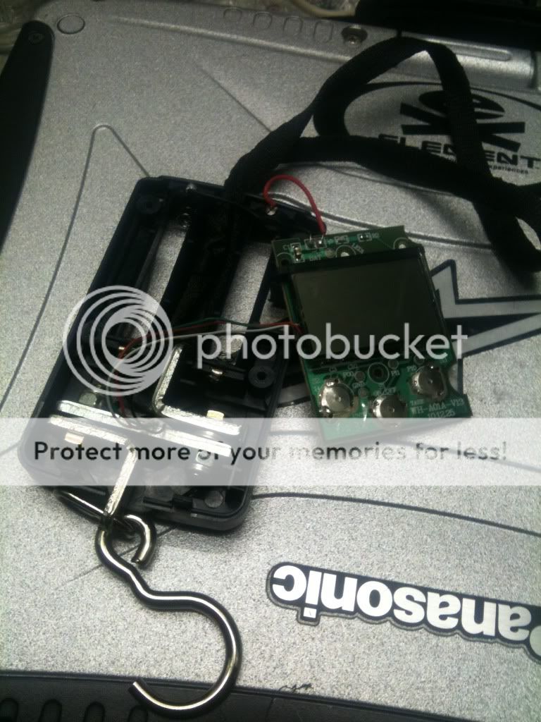

step two, take it to pieces
https://i1112.photobucket.com/albums/k493/steven_191/strain%20gauge%20quickshifter/IMG_1019.jpg

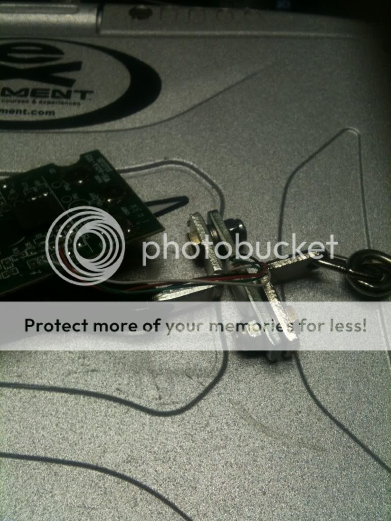

this is the strain gauge. it measures the force applied to the metal bar by its varying amount of 'stretch' on the sensor. (the sensor being a long thin bit of wire that changes resistance when stretched)
https://i1112.photobucket.com/albums/k493/steven_191/strain%20gauge%20quickshifter/IMG_1021.jpg

a microswitch isnt accurate enough.
well the high quality chinese solder broke off almost instantly just by looking at it.
the strain gauge is no longer connected to the pcb Thumbs Up
Ive tested the voltage and resistance across a few wires before it few apart and the only change i saw was that the resistance went from around 1005ohms to 1008ohms. so not much really.
https://i1112.photobucket.com/albums/k493/steven_191/strain%20gauge%20quickshifter/IMG_1022.jpg
ive just soldered it back together and its working again. still havent found any details on how its supposed to work though.
there was a constant 2.2(ish)volts on the red/black so that could be the supply.

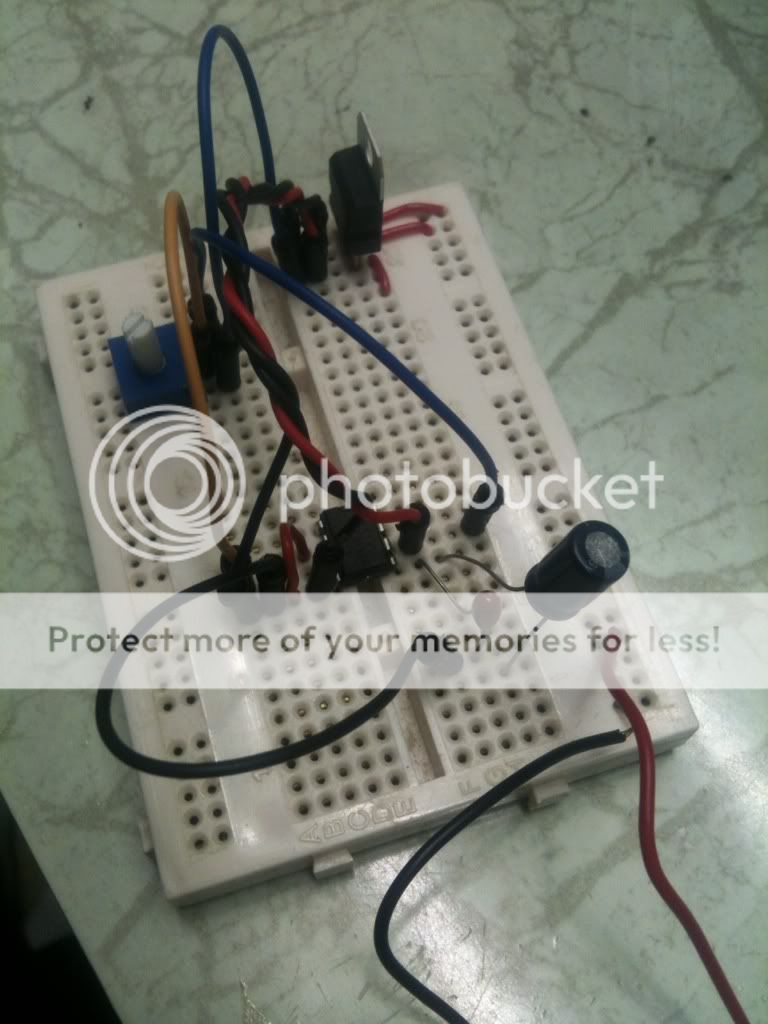

Well I've been having a play with it. I connected a resistor back from the output to one of the inputs. I did read a bit about the biasing but I didn't think that applied. I thought I could set it up so that the differential in the two inputs is what gets amplified.
i set it up as per this
https://www.daycounter.com/Calculators/Op-Amp/Op-Amp-Voltage-Calculator.phtml
and used the calculator to work out my resistors.
the op amp im using is a UA741
https://www.datasheetcatalog.org/datasheet/SGSThomsonMicroelectronics/mXssuwx.pdf
and the one i will be getting is
https://www.ti.com/lit/ds/symlink/lm386.pdf
although this isnt an op amp like the UA741.
also i did try having a capacitor between V+ and ground and lastly i was running this from a 9v battery through a 5v+ regulator. so the actually circuit was all 5v+ and ground. no negative voltage.
if you know how i need to set it up that would be helpful. cheers
edit;
i measured the volt out from each pin of the strain gauge to ground and they were both the same even under stress. but when testing between the pins i get around 5mV deflection. i need to amplify!!!!

I got some LM386 chips but as yet haven't got them working. I'm getting voltage out but it's not changing with the strain gauge.
I've wired them up according to Texas instruments schematics for -20 gain and -200 gain with the only difference being I don't have exactly the right capacitors. I'm rounding to the nearest eg. 220mf instead of 250mf and 0.33mf instead of 0.05mf and 10mf. Similar with the resistors really.
Not sure how much this effects things really. ???
Codemonkey
Joined: 18 Oct 2009
PostPosted: 09:04 - 24 Jan 2012    Post subject: Reply with quote
It would help if you could post a schematic of what you have. You could use that LTSpice application to draw one then post a screenshot or something ?
As for component values, well it just depends what components!
Really you'd be better off with a single rail Op-Amp. The thing you are using is an audio amplifier and the schematics shown in the datasheets (this one at least https://www.ti.com/lit/ds/symlink/lm386.pdf) are all for amplification of ac signals. You are trying to amplify a dc signal.
The datasheet attached shows a single supply (5V) strain guage amplifier on page 11 (Figure 16).

well thats the datasheet i have and ive tried the circuits with varying gains.
i just seem to get a constant output. Ive connected a pot to the input in order to have a bigger range on the output but its not doing much.
I have a 220mf cap in place of the 250mf and a 0.1mf in place of the 0.05mf.
I have some other chips i can try but if ive already killed one i want to be a bit more sure that i wont do it again.
Codemonkey
Joined: 18 Oct 2009
PostPosted: 20:24 - 24 Jan 2012    Post subject: Reply with quote
It would be really helpful if you could post a pic of your complete circuit schematic. You could have simply made an error in how you have everything connected but without being able to see things I'm running out of suggestions!
LTSpice can really help you here, its not hard to use, has "models" for many op amps already, and can be used to test your circuit without actually building it or potentially damaging more bits. Alternatively, you could just use it as a simple cad package to draw the schematic.

PostPosted: 22:47 - 24 Jan 2012    Post subject: Reply with quote
https://i1112.photobucket.com/albums/k493/steven_191/strain%20gauge%20quickshifter/4bcf757c.jpg
i was talking about the texas instruments pdf. the only thing this is currently missing is where the output is going. I normally connect a lead and clip the volt meter onto it. I also tried a buzzer so that i could ground the other end and make sure it wasnt because of an open circuit. but it was a 6v buzzer and only had about 4.5v coming out. buzzed ones very quickly then nothing. I also tried a small piezo element but that has a slight click when voltage is applied but no sound.
nowhere.elysium
The Pork Lord
Joined: 02 Mar 2009
PostPosted: 12:40 - 25 Jan 2012    Post subject: Reply with quote
I'd use an LED instead of a buzzer - you get a more definite response, and they're designed for 5v instead of 6v, which will help.
steven_191
Joined: 31 May 2009
PostPosted: 14:25 - 25 Jan 2012    Post subject: Reply with quote
Yeah I tried an led too. It lit up but didn't vary. I'll probably try another chip and see what happens. Can you see any problems with how I've wired the breadboard?
nowhere.elysium
The Pork Lord
Joined: 02 Mar 2009
PostPosted: 16:26 - 25 Jan 2012    Post subject: Reply with quote
OK - firstly, Codemonkey's advice of using spice is good. Take heed of it.
Secondly, from what I can see, this is how you've wired this up:
https://farm8.staticflickr.com/7165/6760450911_c3f8dd9022.jpg
I've just noticed (after running your image through a massive zoom factor) that I've put the notch at the wrong end of the chip.
However, would it not make sense to isolate the input from the variable resistor from the output from the chip?
If you could give us a more accurate diagram of what you've got, it'd help. I'm far from knowing what I'm on about when it comes to electronics, but it's easier to read diagrams than to decipher someone else's breadboard Laughing
As an afterthought; does a negative voltage input have to be from a separate inverted source, or can it just be hooked into ground? I've never been sure.
