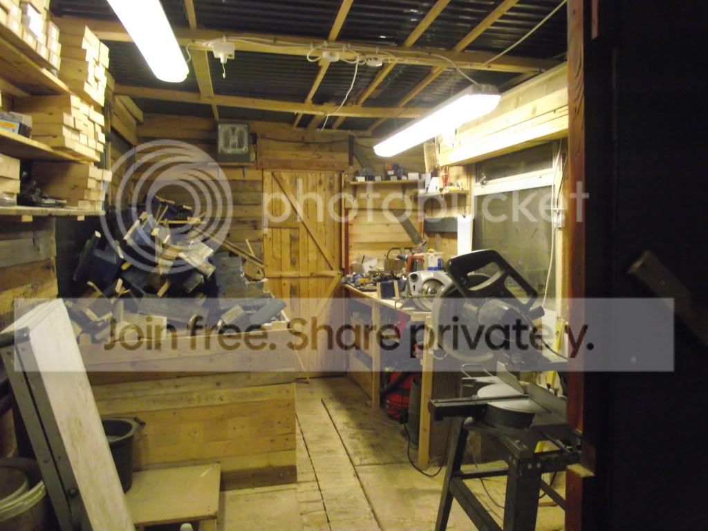

I've done a few shed's in my time. The picture below give's you an idea of a the bench I build. It depend's how you want to go about it. I get my wood from palate's from my local industrial estate. break them up, and you will have enough wood to make, any size you want. As for hight. Build it to the hight of the top of you pelvis bone. That's about the right hight to reach under to get any thing out. And high enough so you don't have to bend down to far. You can get angle shelf brackets. To anchor it down, and for any other right angle. This is important. Use screw's and not nail's to put it together. That way you can easily take it apart if you need to change it. A good size screw's are No6. You will need to put a pilot hole before screwing. And a power driver is a good idea. Believe you me, it's not as hard to do a you first think. I can put up a link to an album. When I built my shed last year.
Where are you? I'm in Norfolk. I may be able to help you.
John933
https://i156.photobucket.com/albums/t26/John933/Shed/ShedBuild57.jpg
