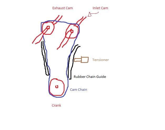

You won't create excess wear on the tensioner because its just a ratchet system, there is nothing to wear. The other end of the ratchet pushes on a rubber guide plate for the cam chain.
I haven't tried the technique myself, but it was recommended to me by a Yamaha mechanic. When rebuilding the engine on my Fazer, I was worried about over tightening the cam chain. He basically said its almost impossible for the automatic tensionsers to over tighten one.
He then went on to say that any bikes they had that came in with rattly cam chains, they used the technique I described to just take up the slack.
The only time it becomes a problem is if it clicks twice. That would then be over tightening the chain.
The system works like this:
https://i1183.photobucket.com/albums/x474/0l0dom0l0/Camchain.jpg
Hope that helps.

It won't create excess wear on the follower because the chain is now correctly tensioned. So that's irrelevant.
It won't over tighten the chain because the chain is loose in the first place. That's why its rattling. Its also not a 'bodge'. Its a known fact that the automatic tensioners get stuck between teeth, like in this case. As long as it isn't moved more than 1 click its just allowing it to select the next level and taking the chain to its correct tension.

I'm not being aggressive, but I am putting up an argument against your mechanics cure all bodge that if followed could cause excessive wear and failure of a component further down the line and your blind belief that it is a proper cure.
and how exactly do you know that the tension is now correct??
Again just because a chain is quiet doesn't mean it's at its correct tension in fact the quieter it is the more chance that it is overtight. Of course it can be between teeth as wear occurs but it will move up a tooth eventually if everything else is working properly, which brings me to my final point.
0l0dom0l0 wrote:
Also with your comment on the mechanics, that's a load of rubbish tbh. A bike that's done less than 80K miles shouldn't need the cam chain doing. I think I'd be questioning if I took a bike into the dealer and they told me it needed a new cam chain after 12K miles. So its not a way to make a quick profit. It will more than likely cure the problem. If it doesn't, then the next step is a new tensioner.
No one has been telling the OP he needs a new camchain but it would probably need an earlier camchain if you keep forcing it onto the next tensioner tooth, it is a bodge as you and the "mechanic" are ignoring the fact that there may be a problem with tensioner, blades or chain but completely ignoring it and BODGING the tensioner as a cure all.
Of course it's quick profit, not bothering to find the cause and just overtightening the chain will quieten it down "curing" the noise but will also cause premature wear of components.
