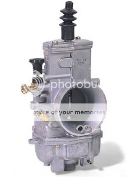

https://i623.photobucket.com/albums/tt314/clancy_07/Motorcycle-Carburetor-Troubleshooting-2.jpg
will look something like that, roughly. with a load of hoses connected to it, it will be underneath the fuel tank. probably about the size of your fist. its one of those small gold screws you need to turn mate, just turn it small amounts and slowly to make sure you have the right thing
