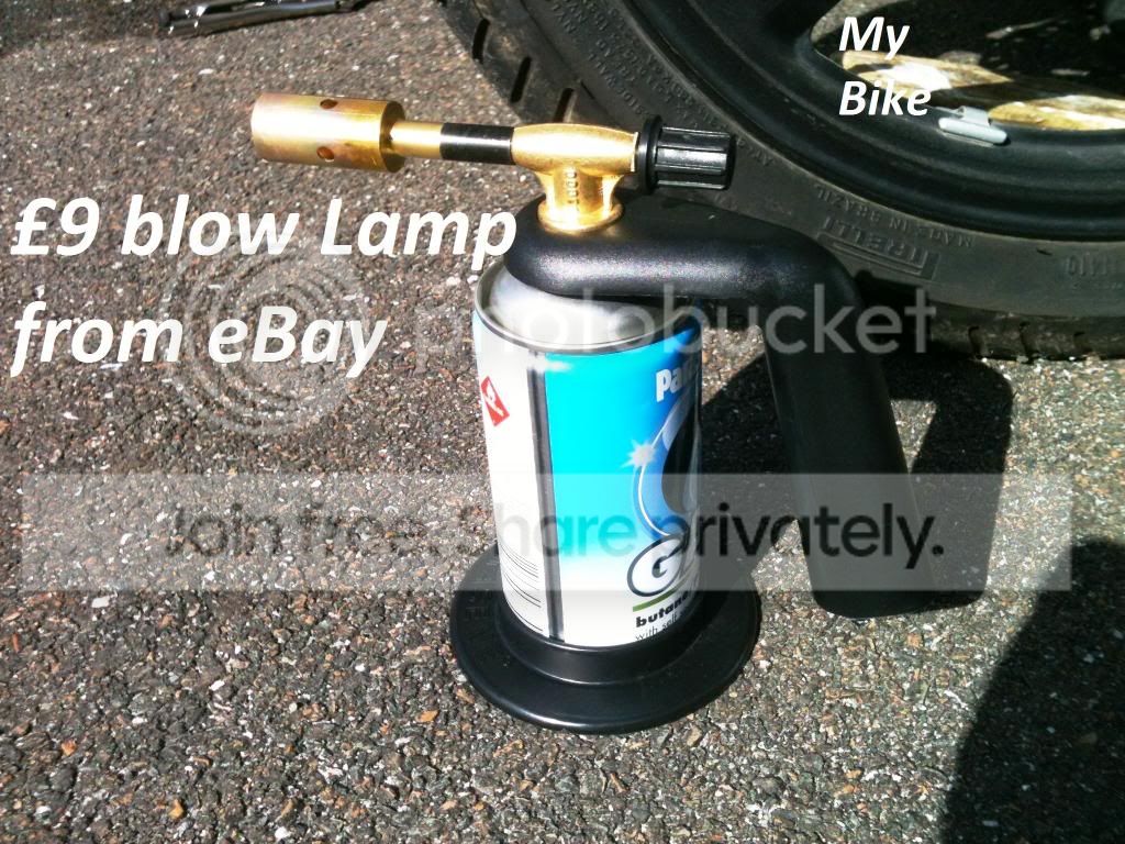

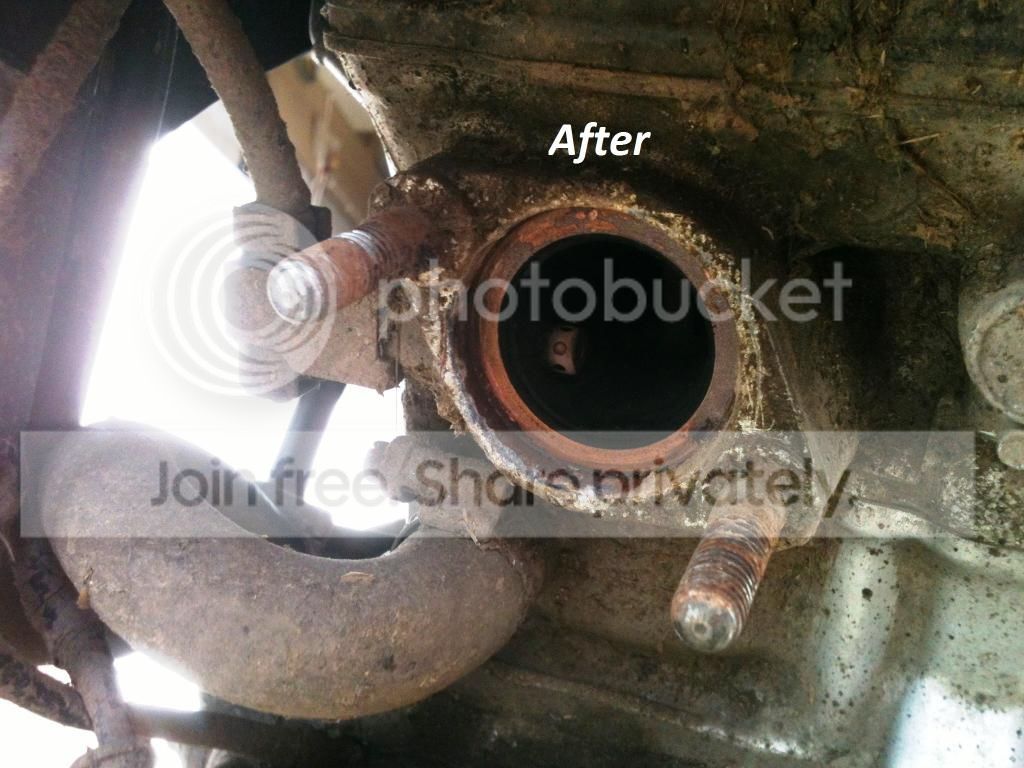

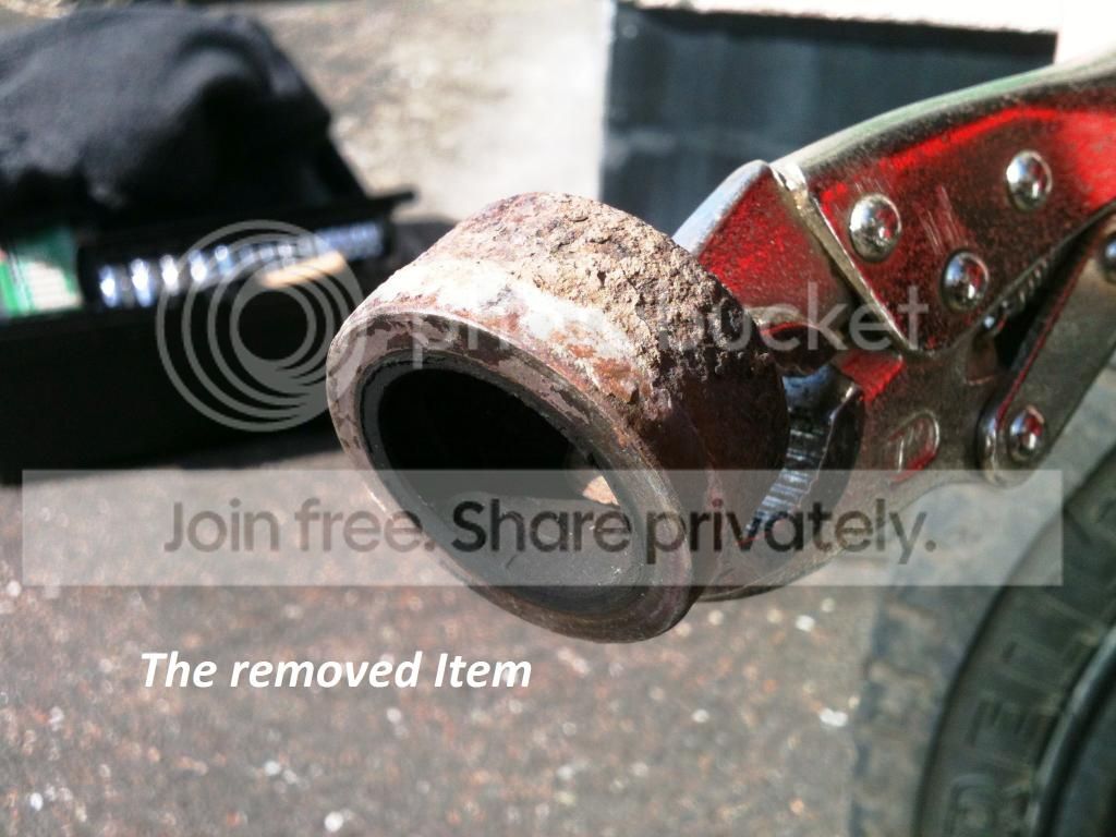

PostPosted: 21:23 - 09 Mar 2013    Post subject: CBR125R Downpipe removal made easy Reply with quote
Take 1 x cheap Blowtourch
heat area for 1 minute
A gentle tap
Remove
what to expect below

Hope this has been of some help Very Happy [/img]

Regardless of age, the only reason is due to lack of giving a fuck... the state of that engine Shocked
