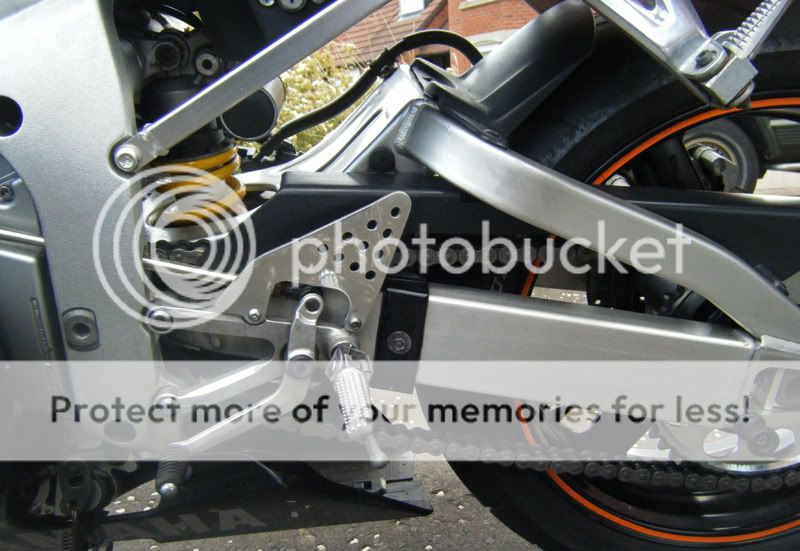

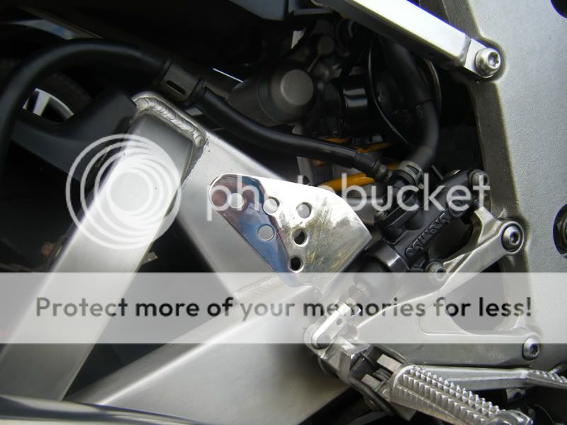

Polished Heel plates

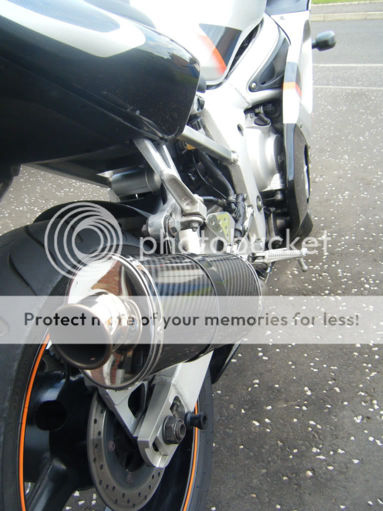

Stubby Carbon Exhaust

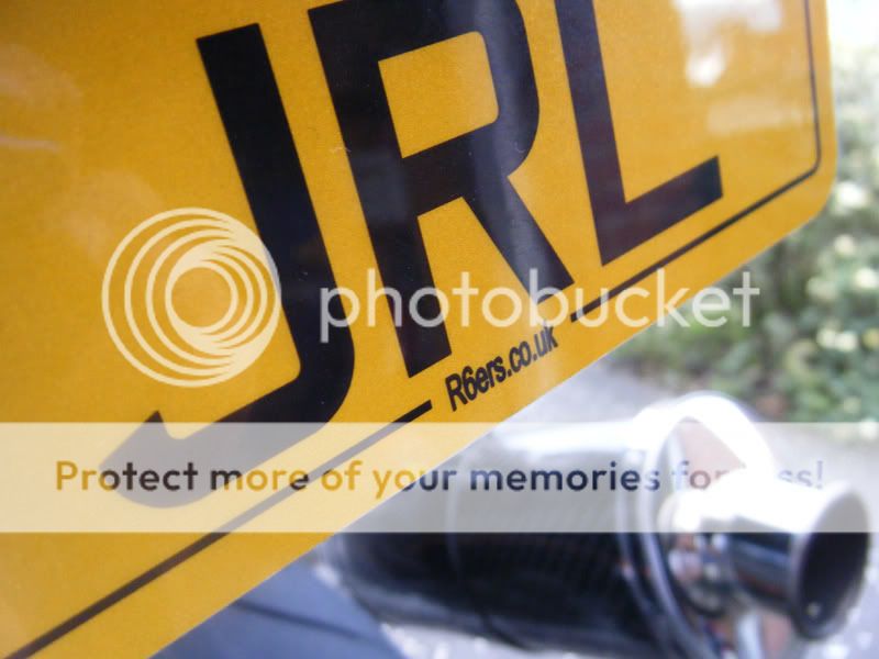

A silly small number plate with the club address at the bottom!

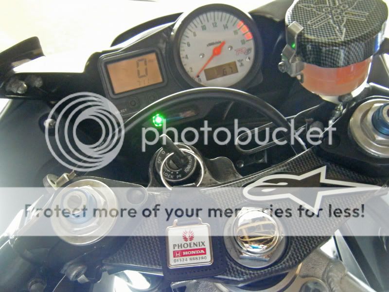

Carbon Fibre yoke cover and resivour cap

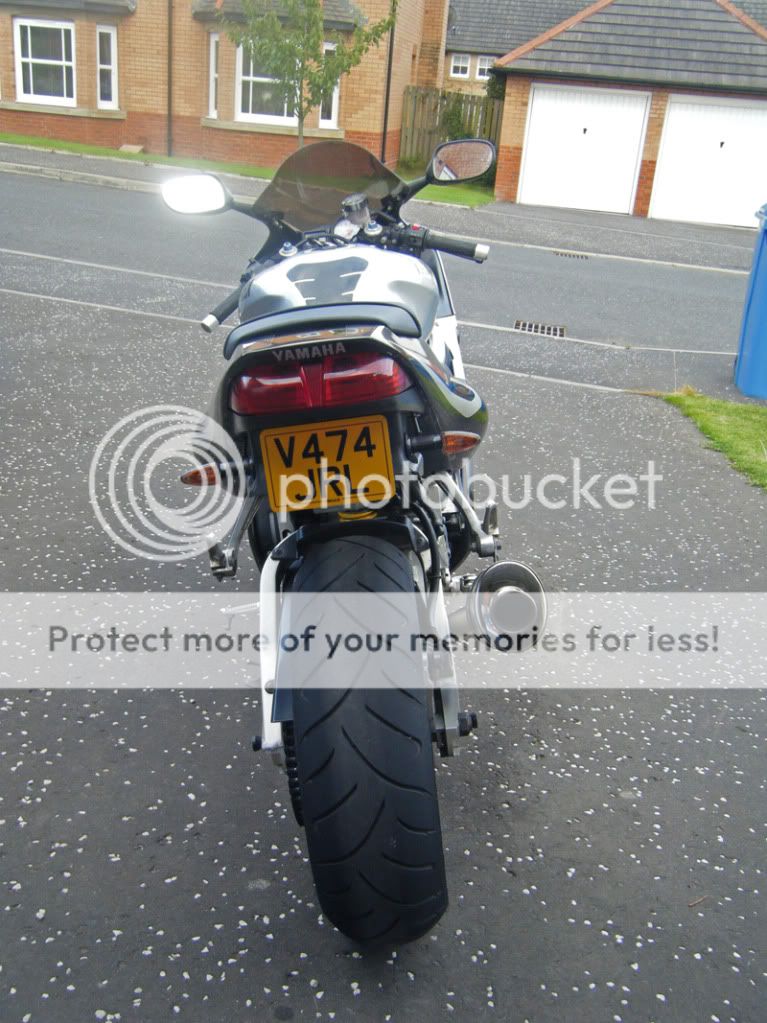

How she stands at the moment

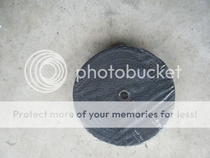

Next mod ( possibly tommorow ) Exhaust wrapped manifold

looking good. Shame about that fake carbon though. Hate it personally. Whats the idea behind that exhaust wrap? I've seen it on a few bikes but have no idea what it does.

The exhaust wrap helps the gases flow better and avoids heat loss, i am doing it mainly cause my manifold isnt shiny so it will hide it Laughing

ok wicked, Any idea how it helps the exhaust gasses flow better? Karma

looked better standard Thumbs Up

It doesn't, since bikes have no problem with heat dissipation off the headers anyway.
It's designed for cramped car engine bays really, where the hot manifold heats up the whole engine bay, and therefore also the airbox, which in turn heats the air inside and hot air is less dense, so less power.
On a bike it's not a problem since the headers are far better cooled, and the airbox is no where near the headers. There's also the arguement that hot air flows faster, but perhaps only very slightly, if at all. (Personally I'm not convinced it gives you a true gain)
The only thing it's good for is trapping moisture and rotting your headers, or protecting you from burns if your exhaust pipe is routed near your legs.
If it were truely that good then it would be used in Moto GP.

Ah welll, i am mainly doing it to keep my headers in better nick and help prevent any cracks/leaks for as long as possible Smile

I did think that if it was that good then why aren't any of the guys on track using it Thumbs Up Sorry for the thread hi-jack Dave, I'll let you have your thread back now Mr. Green
And I like the carbon can etc. Its just that reservoir cap that destroys it for me tbh. But as you said, each to their own. Good work anyhoo

Yeah, the only flaw in that plan is that when they get wet they trap the moisture right next to the pipe and it also takes longer to dry, so they still rot. Thumbs Up

polished rearsets and yoke and reservoir cap are gay as fuck, and the small plate looks rediculous as you still have the massive block of an undertray. cut that down or get a tail tidy. even better, a 5MT undertray.

lol its got a long way to go, and it does look better than how it did stock

only on the exhaust front. everything else is pretty gash

Lol to be fair mate the exhaust wrap is a bad bad idea.
The zhorst and that nice and subtle.

Don't get me wrong, if you like it then go for it, but wrapping the headers will do nothing to stop corrosion, if anything it'll accelerate it.

Very uncommon colour, although I would have thought that a Titanium or SS end can would have broken the black at the rear and provided it with a contrast.
Exhaust wraps are also used on endurance bikes where the engines run for 8+ hours on end so there would be some beneficial effects from thermal insulation. I remember seeing a few phase 1 bikes having their headers wrapepd in them.
Corrosion prevention, just spray it with ACF50 OR do the Craig treatment and rub it down with emery.
