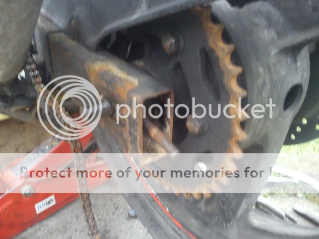

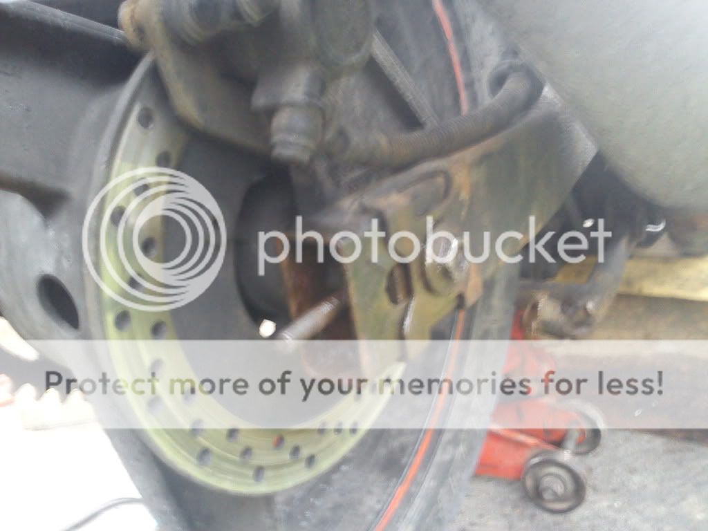

So today we set out to get the rear wheel off.
Wasn't as easy as I thought.
The Spindle will NOT come out.
used a load of WD40 on it, tried using wrenches, sockets... all sorts.
But it just won't budge.
The wheel will spin round without it moving, and the wheel can move back and forward with the adjusters.... so i don't know why it won't come out.
Can anyone enlighten me as to why it won't move?

Or failing that a proper hammer and a bit of wood against the spindle.
Hit it you girl.
You can't "unscrew" it since it isn't threaded inside the wheel. A rubber mallet's always done the job for me.

Helps if you lift the weight of the wheel with one arm as you whack to take some weight off the spindle and it'll slide out more easily.
When other end is proud by a few inches (depending on the strength of your whack and how stiff it is) just pull it out with your hands (may need a jiggle at this stage).
Don't forget to grease it when you put it back in. Thumbs Up
PostPosted: 17:57 - 29 Jan 2011    Post subject: Reply with quote
The spindle has probably seized to the inside of the bearings or to the bearing spacer.
Belting it might help but it will be quite easy to trash the thread on the spindle (you can try putting the nut on but not all the way down, so you land up smacking the nut).

Probably a good idea as you will put a load of side loading on them when taking the spindle out (if you can get it out, not unknown to have to cut the spindle).
PostPosted: 18:20 - 29 Jan 2011    Post subject: Reply with quote
I've had this before.
There will be a (surprisingly small) amount of corrosion on the spindle and a correspondingly small amount of corrosion on the inside of the alloy calliper hanger. This'll be where it's hanging up.
I'd apply some penetrating oil to this bit and try to tap the spindle or the hanger back and forth a bit.
Applying some heat directly to that casting would probably help matters a lot but be aware too much heat could damage the bearing seals. Freeze and release spray might help too.
I do recall I landed up clouting it out with a big hammer by putting the nut back on the spindle, resting a block of hardwood against it and giving it a few big hits with a lumphammer. Just be careful you don't damage the threads.

Ended up duct taping a bit of wood round the swingarm so it was up against the spindle and absolutely smacking it with a sledgehammer Thumbs Up
Got it out eventually Laughing
No damage to the spindle, no damage to the (surprisingly good condition) bearings. it was seized to the spacers, managed to free it off with the hammer and turning it on the other side.
