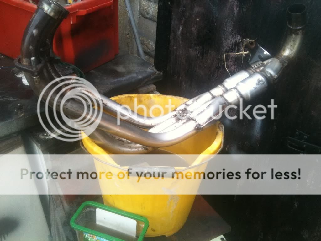

Brick acid works well.
Spray on with a bottle, or brush on. Leave for 2 mins, rinse off with hose.
I will try to find an old thread I remember where a guy cleaned his hornet exhausts with brick acid. The difference was crazy!
Also, if its high grade stainless it wont be magnetic as above ^, but if its low grade then it will be magnetic. The stainless isn't a coating, its all the way through, so don't worry about taking a bit off!
EDIT: Here is the link, but I have stole the pics. Used Brick acid, then the autosol with scouring pads.
https://www.bikechatforums.com/viewtopic.php?t=200279&postdays=0&postorder=asc&highlight=hornet+exhaust&start=25
Before:
https://i770.photobucket.com/albums/xx346/ThatHornet/51a59ac0.jpg
After:
https://i770.photobucket.com/albums/xx346/ThatHornet/a52fb838.jpg
https://i770.photobucket.com/albums/xx346/ThatHornet/12240d74.jpg
