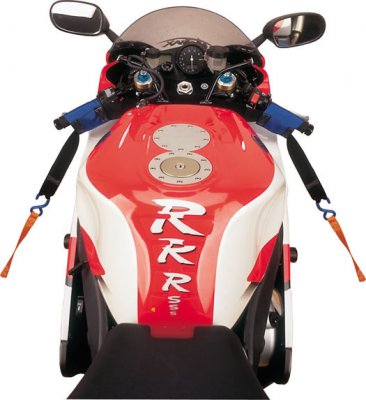

Ratchet strap it down - either hooked onto the headstock or with a bar-strap like this:
https://www.sportsbikeshop.co.uk/product_images/barstraps1.jpg
Once the forks are compressed it won't go anywhere.
As you're local to me, i can give you a lend of some straps if you need them, may even have a scaffold board around so you can load the bike in to the van.
If you need a hand, just ask.

Myself, G, Bendy, Danny, and various other forum regulars have moved bikes in vans before on many occasions.
The way I do it is this:
I usually use a proper bike ramp to get the bike into the van. I usually need assistance for this.
Once in the van I push the bike right up against the bulkhead in the van or up against the passenger seat, and either use a cable tie to tie on the front brake, or if using a handlebar strap, I make sure the handlebar strap is holding the brake on.
I get a mate to hold the bike upright while I loop ratchet straps either around the fork legs just above the lower yoke, or I use a handlebar strap as pictured above. There are usually tie down points in the van, and usually the bike is sat centrally between them. I hook the ratchet end of the strap over the tie down point, and take the long part to loop around the fork leg. I put the free end through the closed up part of the hook so that the strap cannot become unhooked through movement.
https://www.bikechatforums.com/files/ratchet_213.jpg
I then take the free end of the strap, pull it through the capstan part of the ratchet, pulling it back out towards the bike. I then tighten it so there is no slack but it is not fully tight. I do the same on the other side, then tighten both up equally until they are tight.
Your mate should now be able to let go of the bike.
Next, I take two more tie down straps and attach them to the rear peg hangers, grab rail or subframe. I make sure these straps go diagonally away from the rear corners of the bike so that they prevent the bike from moving forward and side to side. Having four straps is probably overkill, but I do it for my own peace of mind. Again I tighten them progressively so that the bike is not leaning over to either side.
This should hold the bike sufficiently for any journey.

Phoenix wrote:
I would definitely cable tie the front brake and not attach it to the strap in any way, the ratchet tension could easily be way more than you should be putting on the lever.
The handlebar straps I've used just hold the brake on with a loop of webbing, and do not put any tension on the brake lever.
No they don't but someone else suggested wrapping the tie down strap around the brake lever. Handlebar straps are good but they're expensive for just moving one bike, worth having if it's something you do occasionally, otherwise i'd just wrap it around the top or bottom yoke on each side.
PostPosted: 12:46 - 14 Mar 2011    Post subject: Reply with quote
I often slot the brake lever in to the handlebar straps when I use them.
