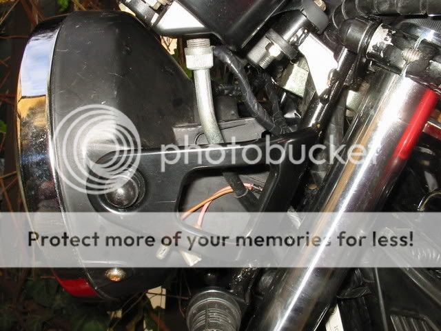

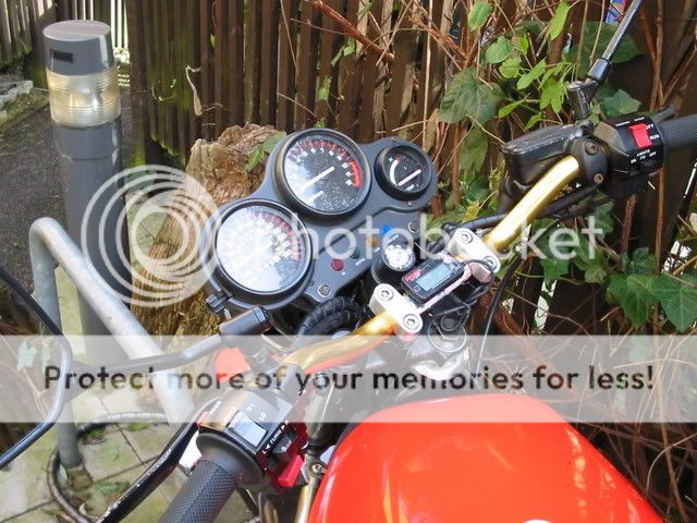

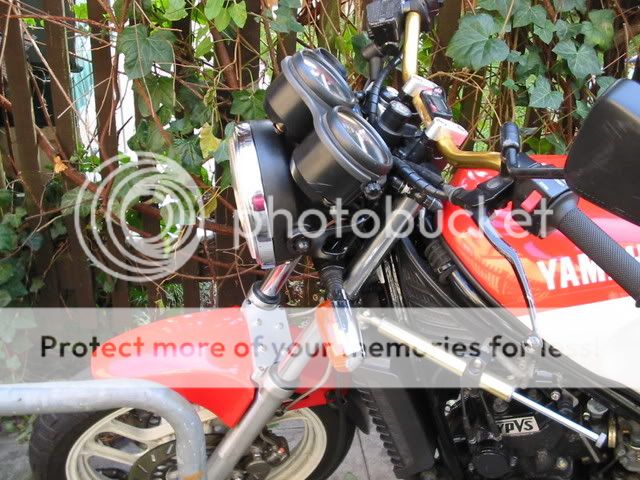

Mine uses standard clocks with an N2 headlamp and bracket. I'll dig out pics when I get home.

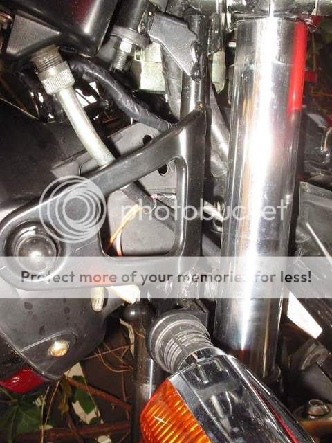

PostPosted: 18:20 - 24 Feb 2011    Post subject: Reply with quote
You can *just* about see from this picture, but there is a framework with four loops on it which slide over the fork legs. All of the gubbins is attached to this.

PostPosted: 18:59 - 24 Feb 2011    Post subject: Reply with quote
Yeah i think thats the same sort of bracket on the bike that i put a link too.
