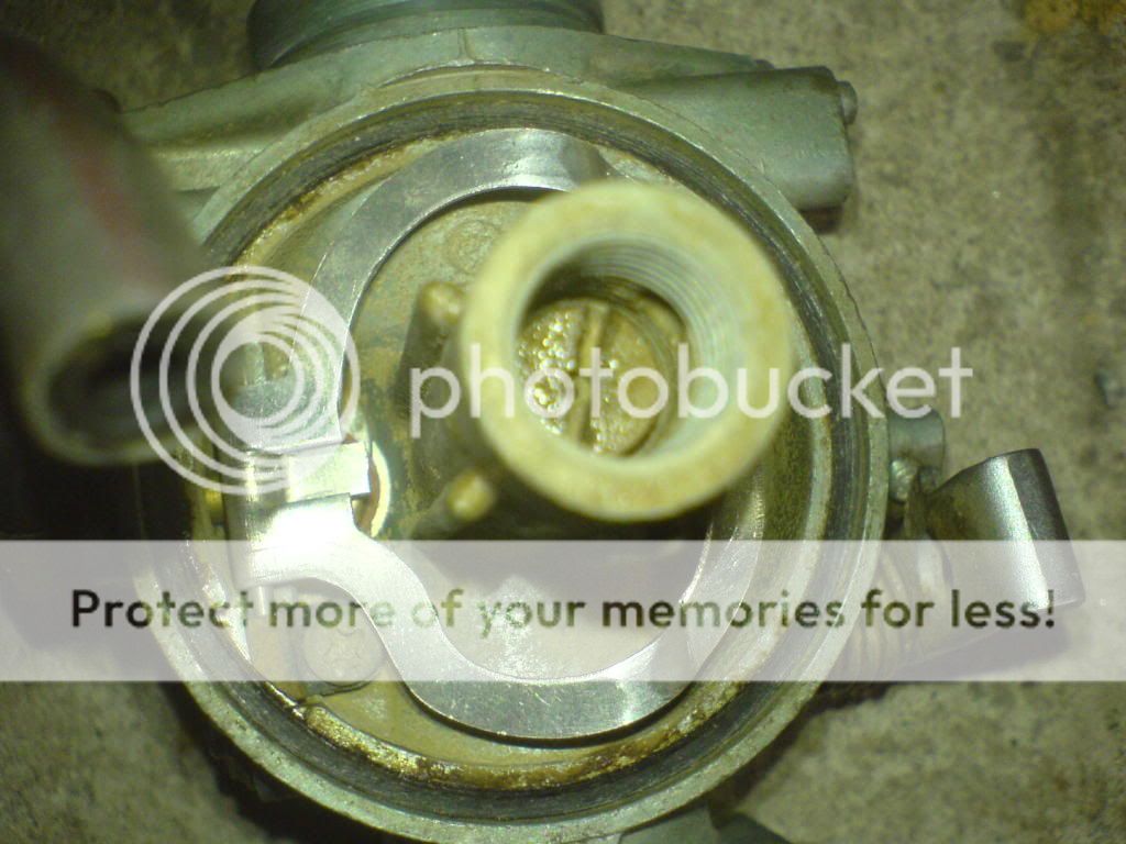

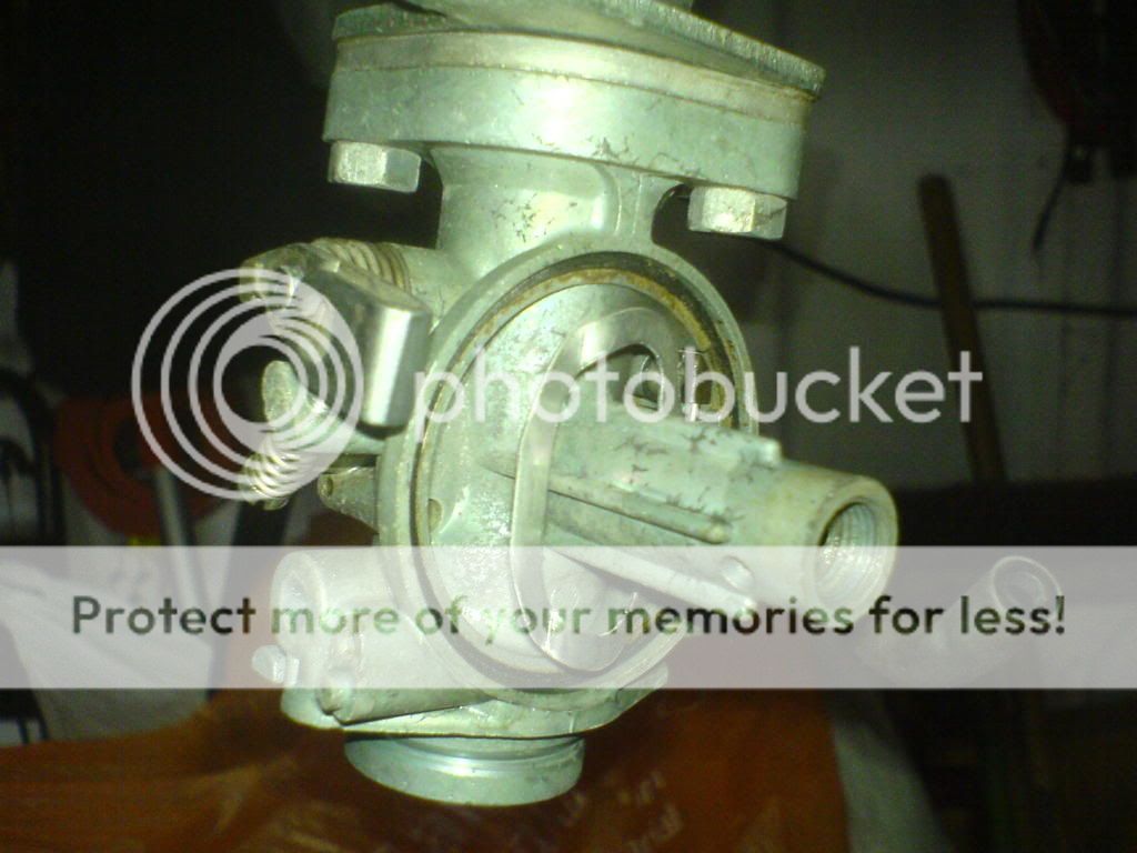

Cleaned some of the carb tonight in my ultrasonic cleaner using ASDA's Smart Price cola.
Before:
https://i15.photobucket.com/albums/a376/ms51ves3/DSC01150.jpg
After:
https://i15.photobucket.com/albums/a376/ms51ves3/DSC01151.jpg

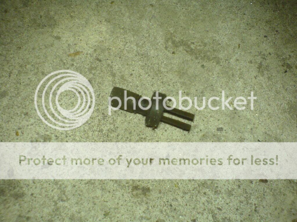

The choke mechanism was a bit stiff and it didn't shut properly (took about a second to flip from fully open to fully closed) so I removed it. There was some dried fuel on the end of it and it was tacky like semi-dried glue
Before:
https://i15.photobucket.com/albums/a376/ms51ves3/DSC01153.jpg
After:
https://i15.photobucket.com/albums/a376/ms51ves3/DSC01155.jpg
As good as new now.

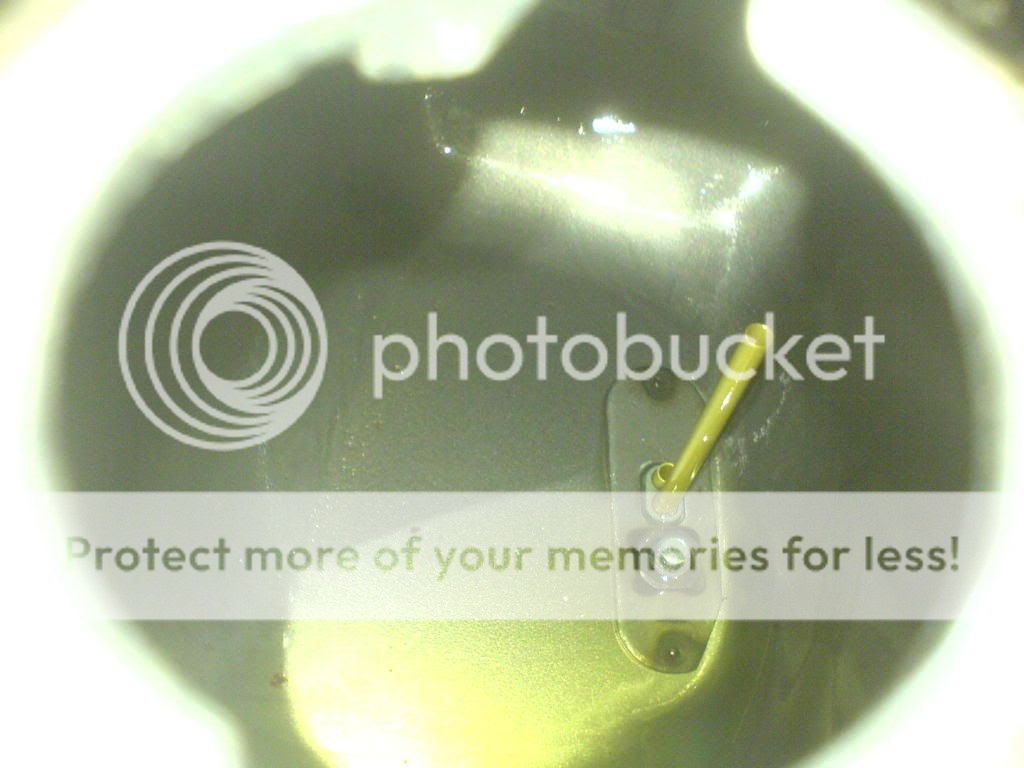

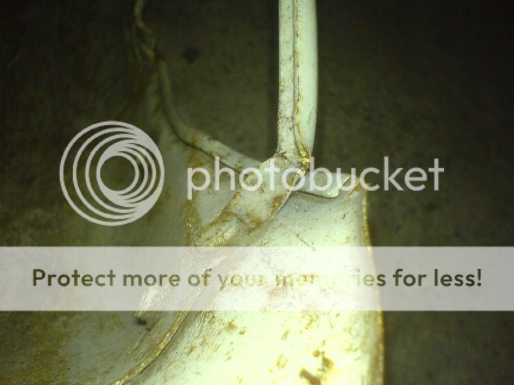

Forgot to upload a picture of the inside of the tank on my last post.
https://i15.photobucket.com/albums/a376/ms51ves3/DSC01156.jpg
Not bad considering it's 36 years old.

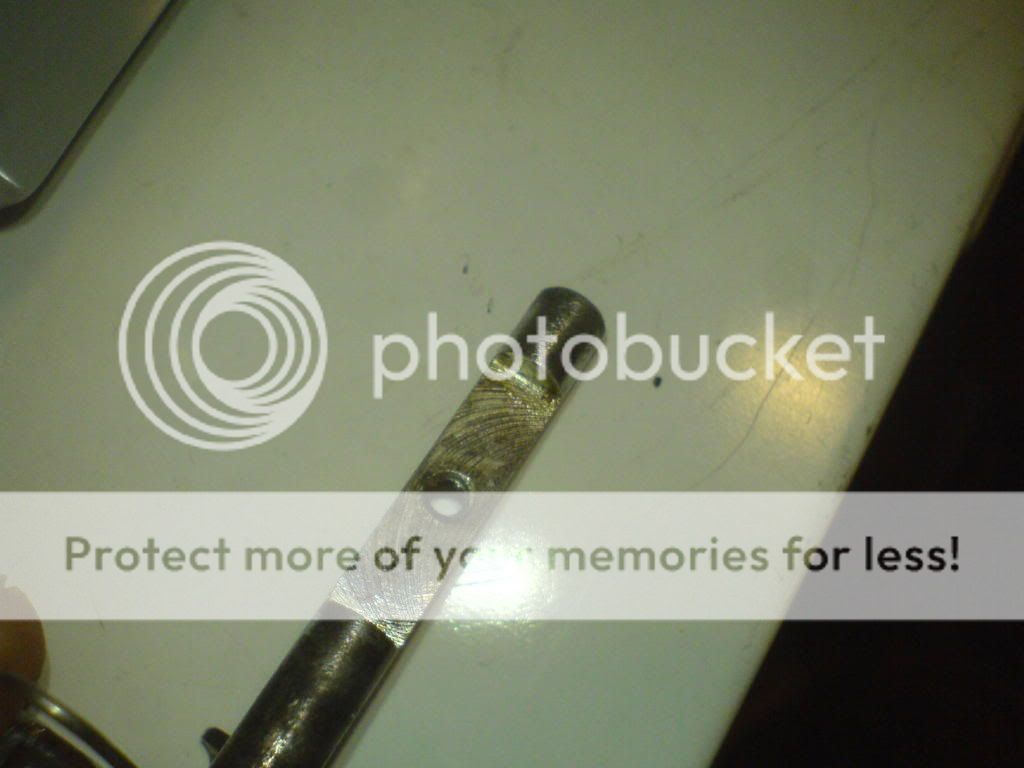

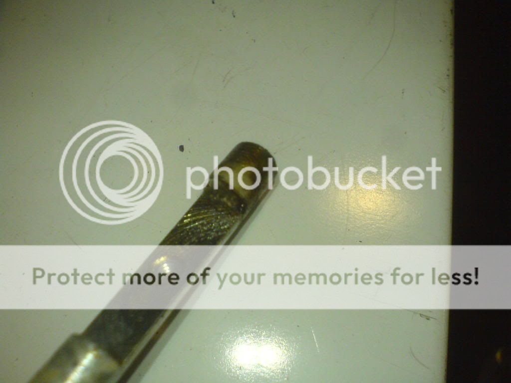

The speedo problem has been traced to the speedo cable. This is supposed to be attached:

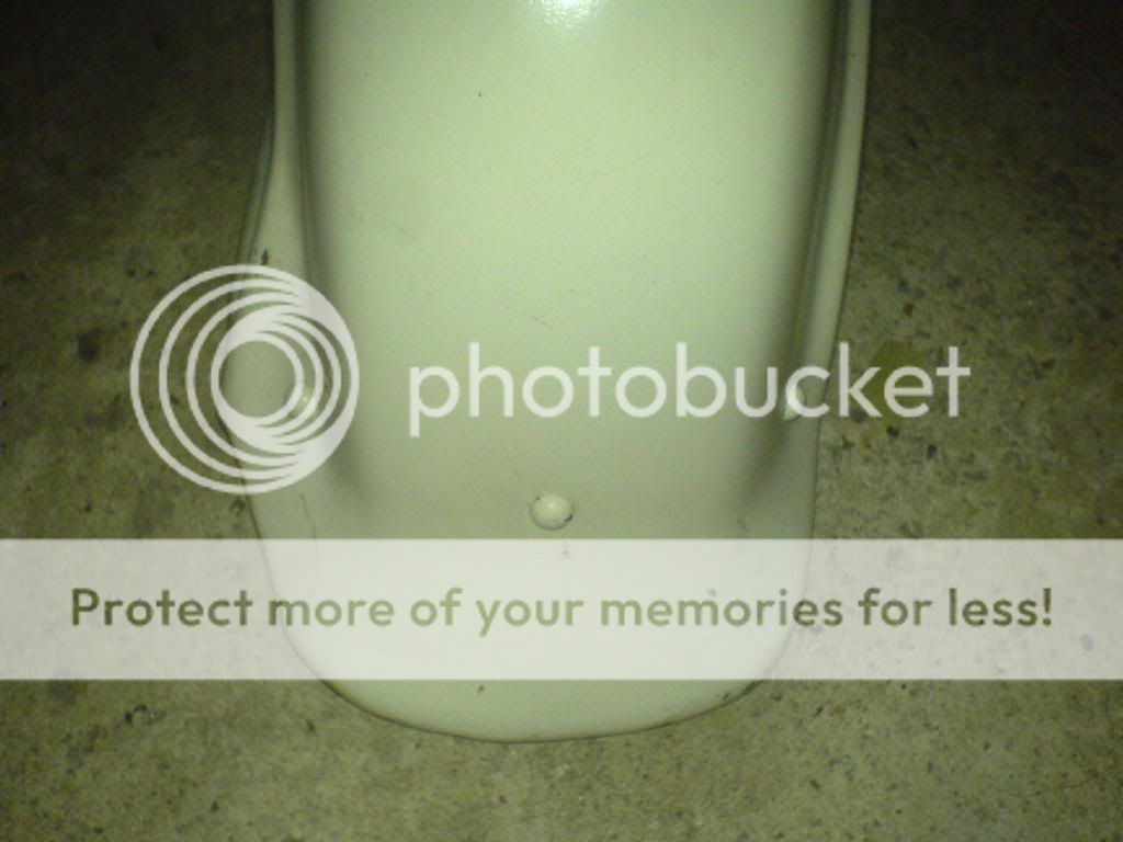

The mudguard has taken a bit of a bashing at some point, I'm not sure if I should try and straighten it out or just leave it.
https://i15.photobucket.com/albums/a376/ms51ves3/DSC01161.jpg
https://i15.photobucket.com/albums/a376/ms51ves3/DSC01162.jpg
And the good side to compare it with:
https://i15.photobucket.com/albums/a376/ms51ves3/DSC01163.jpg
I'm going to clean the mudguards up and give them a coat of underseal on the inside.

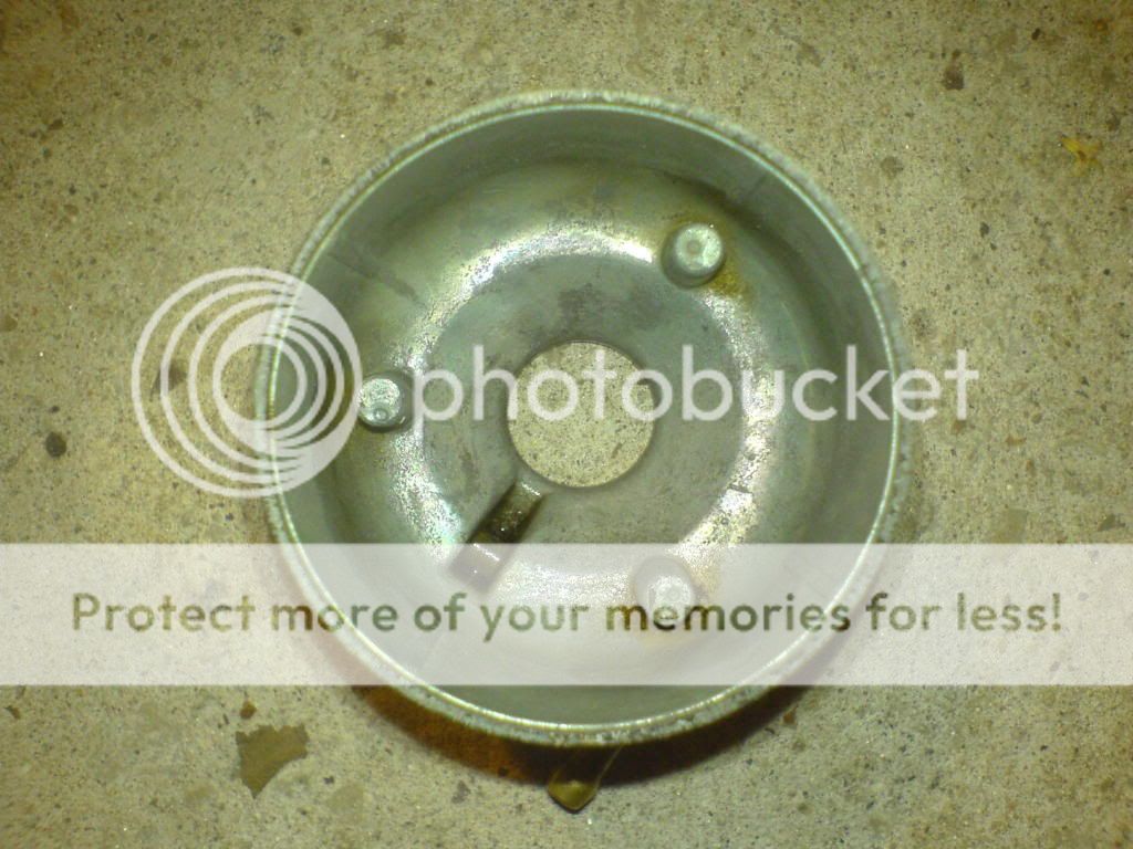

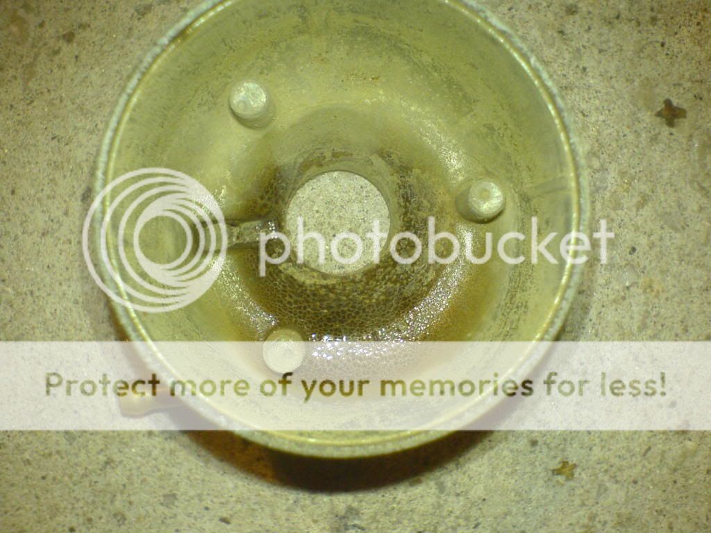

The front brake problem turned out to be just a badly adjusted cable, but as I have the wheel and brake off now I figured I may as well clean it. The drum has some surface rust but otherwise, it all looks good.

PostPosted: 10:14 - 11 Oct 2009    Post subject: Reply with quote
Where abouts are you? That looks like an easy repair, I'll get it out for you if you like?
PostPosted: 13:03 - 11 Oct 2009    Post subject: Reply with quote
I'm in Manchester. The only worry I have is that if you bent it back the arm may break off.
BenR
Joined: 23 Jun 2008
PostPosted: 14:50 - 11 Oct 2009    Post subject: Reply with quote
Shouldn't brake if it did again it would be an easy repair. Manchester is a bit far away though I'm in Hertfordshire lol! Laughing

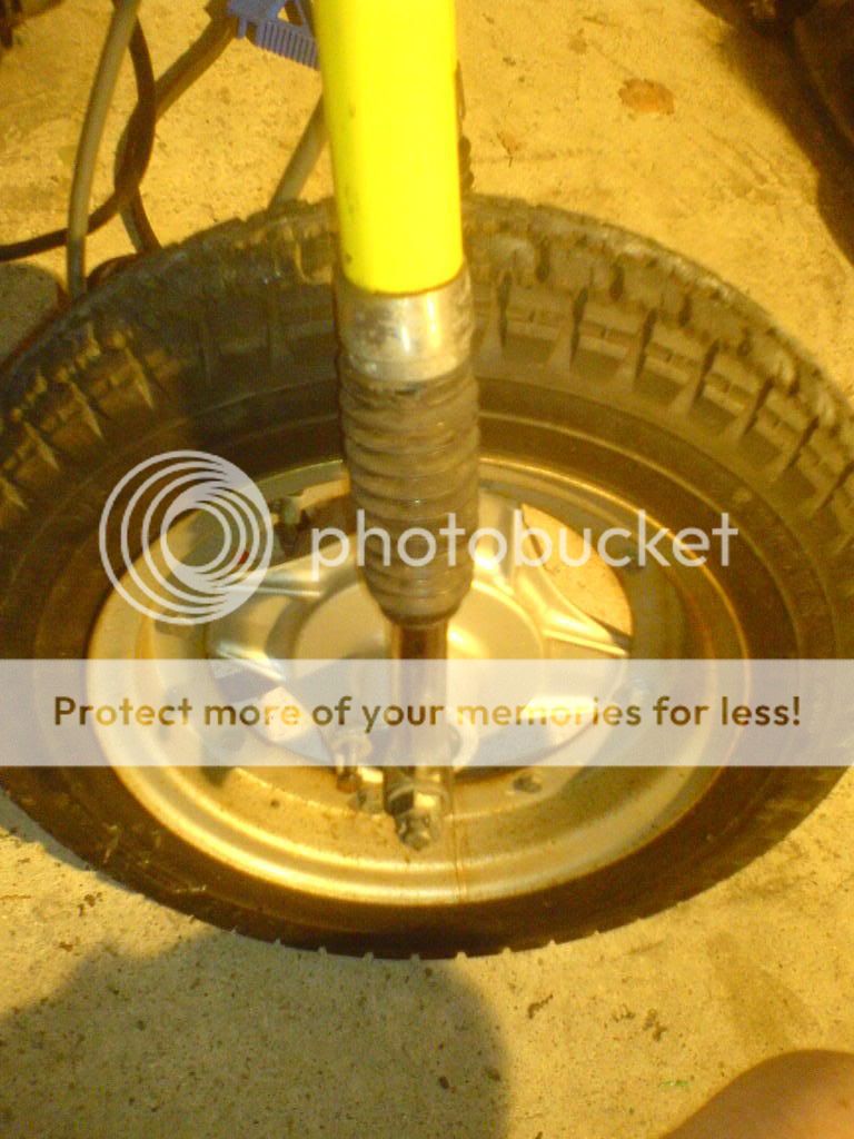

One of my suspicions has been confirmed, I noticed when looking at the bike at the guys house but thought maybe it was just my eyes, but it wasn't, the forks are ever so slightly bent.
https://i15.photobucket.com/albums/a376/ms51ves3/DSC01169.jpg
Suggestions?
Arrow Bend them back in place?
Arrow Take the forks apart and bend them?
Arrow Bending them back won't work, find some new forks?
Option one is my preferred method but obviously could damage seals and bushes.
