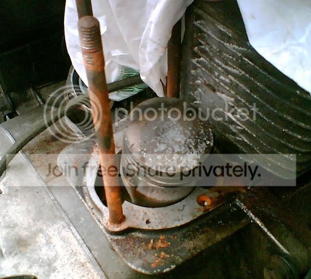

I caught this one just before it hoiled completely:
https://i48.photobucket.com/albums/f216/stinkwheel/piston.jpg
This was caused by the stator plate coming loose and slipping, radically messing up the ignition timing. There were still blobs of molten alloy on the top of the conrod

stinkwheel wrote:
You may need to split the engine and clean out the crankcases. It'll have peppered the small end and crank with blobs of molten alloy.
It's not a lubrication issue. That sort of damage is classic of either running super lean or having the ignition too advanced.
Thats very interesting.
I pretty sure your right.
I was going ask about cleaning out the crank cases.
