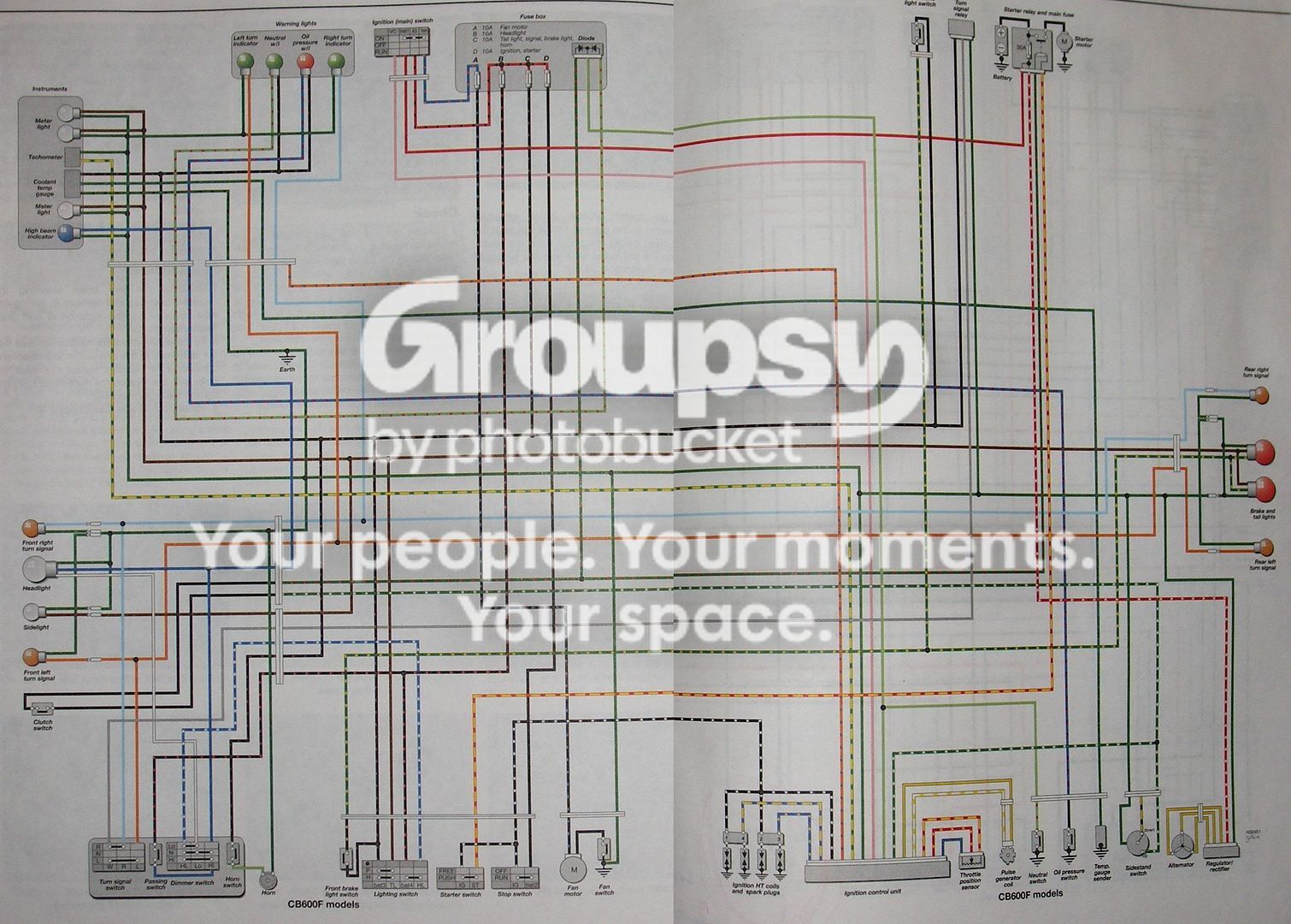

Also, Hmmnz has very kindly got a picture of the Hornet wiring diagram in this thread.
Click for the diagram.
