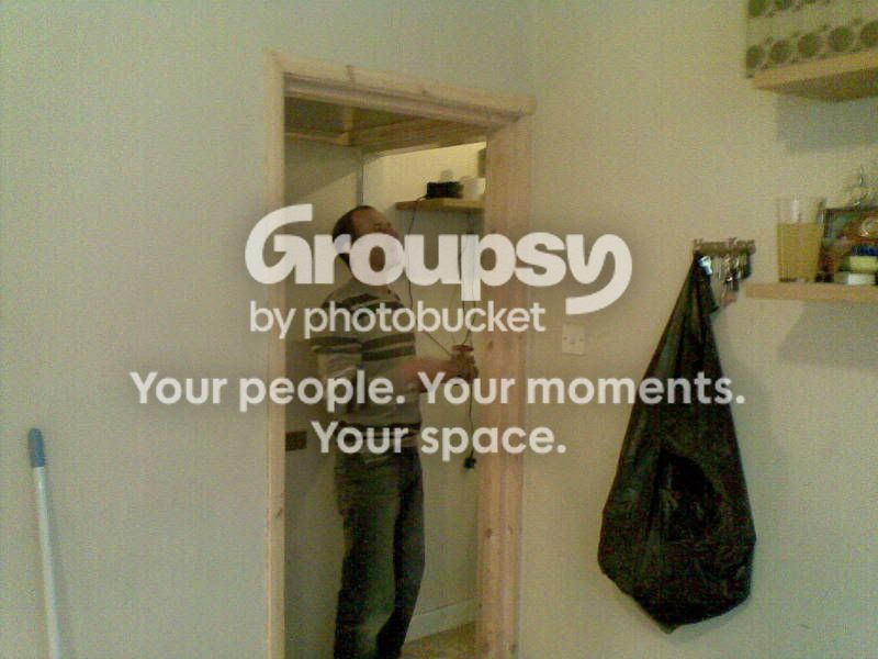

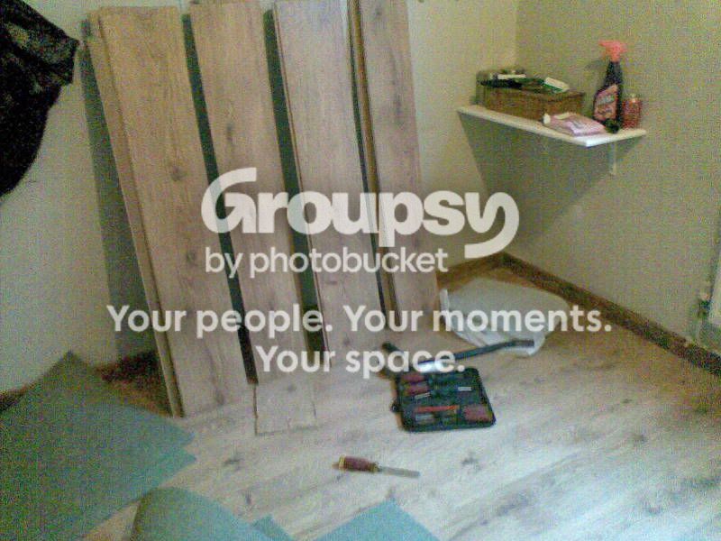

It depends just how far you want to go? My place has not got a drop of gloss paint in it any where. What I have done over the year's. Is rip the skirting board off the wall and binned it. Then plaster the wall down to the floor. Dam plasters usually miss the last inch or so. The with new wood. Drill the wooden skirting board and plug the wall and fix the wood to the wall with screw's. Slip a piece of wood under the board to give you a gap the slip the carpet under.
Instead of painting it use a light stain. paint sit's on top off wood so you can alway's chip the paint. And another covering of paint will not cover any chippings. Stain on the other hand penetrates the wood so can't be chipped. To re fresh. is easy. Just un screw a few screw's. Take out side re stain. wait until it dry's. And re screw back. Job done.
