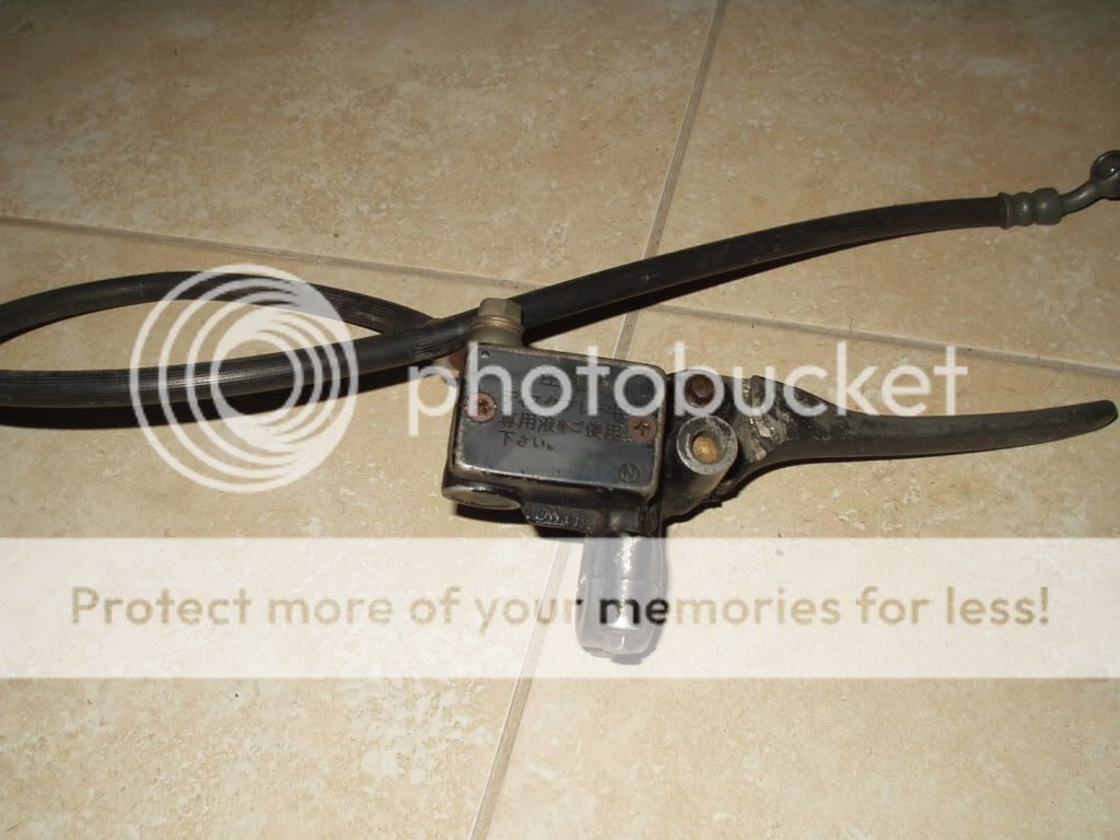

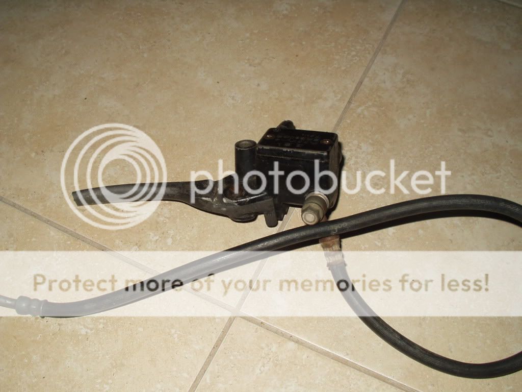

This is the master cylinder from my Yamaha RZR250 project bike.
Obviously I would like to get a new brake lever but I can't identify it.
Does anyone recognise it from another Yamaha model?
I have tried Wemoto, who list a brake lever for an RZ250, but it doesnt fit this master cylnder.
The resevoir top measures 52 x 34mm, it is a "Nissin" 1/2 inch and has the number "9k" embossed on the underside of the pipe outlet.
The brake switch tab on the lever is 18mm long. The pivot point on the lever is 10mm thick.
It is a mid to late eighties Yamaha, maybe it is the same as the TZR 125 or 250 maybe an FZR400. It is definetly not the same as an LC or a YPVS.
The reason I ask is that I now have a small collection of new brake levers from LC's & YPVS's none of which fit this master cylinder.
As a temporary measure I have fitted a master cylinder from an FZR600, it works just fine but is twice the size of this one!

I can help with eliminations and tell you I am almost certain it is not the same as the TDR250's, I would think that would eliminate the TZR250 too though that is a guess.

I don't know what it's from, but I can narrow it down by saying it's not from an XJ Maxim/Seca 650/750, an FZ 400/600 or an RD 350. It might be from an FZR.
That doesn't mean to say that the levers from these won't fit though, so I'll take a look at the levers I have knocking about when I get home tomorrow and see if they match that one. I don't think they will as the bit of the lever that "pumps" is in a different place afaik but worth a shot.

sorry to say but it looks awful honda to me, CB250RS or similar
and I've had lots of RD's

The switch tab does look very similar, but the master cylinder looks completely different. Very very roughly the pivot bit on the cb250 is 1.8cm wide if thats any help Very Happy

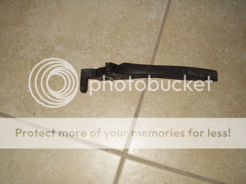

PostPosted: 21:23 - 04 Apr 2011    Post subject: Reply with quote
Had a look at an old catalogue and can't really recognise it (nearest possibility is RD80LC, but can't find a side shot of it to confirm it).
Could you post a piccy of the lever from vertically above without it mounted in the master cylinder.

Here you go Keith:-

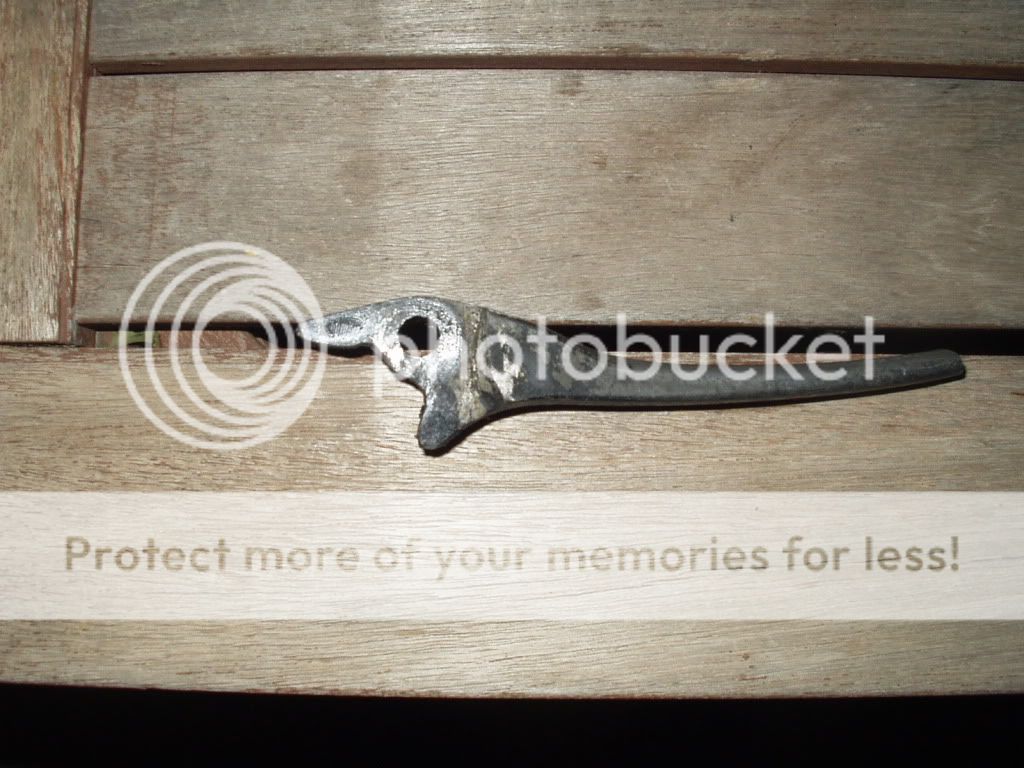

Possibly a CBR125 lever will fit?

Sorry misread that post. Embarassed
https://i645.photobucket.com/albums/uu172/Troodos-Pool-Guy/RZR%20250/MC06.jpg

https://cgi.ebay.co.uk/SUZUKI-DR-750-800-FRONT-BRAKE-LEVER-/380328112352?pt=UK_Motorcycle_Parts&hash=item588d5270e0
I think we may have a winner
https://cgi.ebay.co.uk/HONDA-XL125-XL-125-VARADERO-FRONT-BRAKE-LEVER-1074-/160496338175?pt=UK_Motorcycle_Parts&hash=item255e53c4ff

PostPosted: 22:22 - 04 Apr 2011    Post subject: Reply with quote
Looking through that old catalogue it doesn't look like any Yamaha ones. Does look like a Honda one used on the CB124TDC, CB250NB/NDB/NDC, CB250RSD, CM250T, CB400NB/NDB/NDC, CX500B, CX500EC, CX500 turbo, CX500C, GL500D and a few others.

Thanks Keith and everyone else, I'll look into the CB125 lever.

Thumbs Up I had a look at my friends cb125rs and it looks exactly the same as that Very Happy
