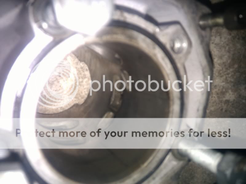

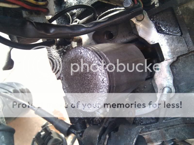

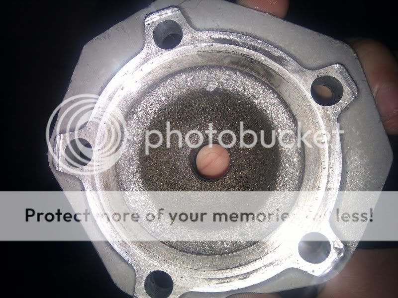

Nothing on Ebay at the moment that I could find that cheap, not looking healthy though
https://i34.photobucket.com/albums/d112/pitslayer/IMG_20110409_180502.jpg
https://i34.photobucket.com/albums/d112/pitslayer/IMG_20110409_200248.jpg
These marks are fairly deep, can't get the really deep one to show up.
https://i34.photobucket.com/albums/d112/pitslayer/IMG_20110409_200347.jpg
I have done worse though,
PostPosted: 22:42 - 09 Apr 2011    Post subject: Reply with quote
Deep scores are repaired by welding them up and remachineing before replating them.
Bit concerned about why it would get detonation though. Main cause would be low octane petrol or over advanced ignition timing. Lean mixture of serious over heating might trigger it if things are borderline but not sure they would be that bad with just a lean mix or over heating (ie, probably cause other problems first).

PostPosted: 22:26 - 10 Apr 2011    Post subject: Reply with quote
The bike only runs on Super unleaded, and has never gone above 78 degrees since rebuilding, it has been running sweet as a nut, starts on first press of button, never ridden till 50degrees never ridden hard till 70 degrees. It has been running sweet.
On closer inspection, crank/big end seems fine, and I have found out the bike was rejetted to run rich as there was a previous fault with the bike, so no real way it has run lean as it was set up to run rich.
The bike hasn't been touched since it was rebuilt 3,000 miles or so ago, as it hasn't needed anything, never lost any performance, never cuts out it runs like a 4 stroke, it only stays on choke for under a minute before it no longer needs it, doesn't die when idling.
And no I wont be using any emery cloth, a chunk of metal has taken one of the ports out and the piston has a fairly big chunk missing from it.

PostPosted: 16:16 - 11 Apr 2011    Post subject: Reply with quote
The one port has a big chunk taken out of it sadly for the price of a new barrel I think it would be more hassle than it is worth to fix it Crying or Very sad
suspicions firmly confirm oil starvation, took the oil pump cover off, undid the little screw in the middle, it dripped oil, opened throttle it piddled oil, put screw back on, took outlet pipe off, blew through it, not a drop of oil in there, nothing coming out the outlet side of the pump either.
PostPosted: 16:21 - 11 Apr 2011    Post subject: Reply with quote
The damage to the head doesn't look like anything to do with oil starvation. Which suggests the head was probably already damaged (which would also explain why it looks dirty, rather than fresh damage).
As to the barrel, a cheapo one will cost about the same as a repair and replate. An original from Aprilia will cost a hell of a lot more. The places that do the replates will probably be able to do a welded repair. Try PJ Engineering or Langcourt Engineering.
