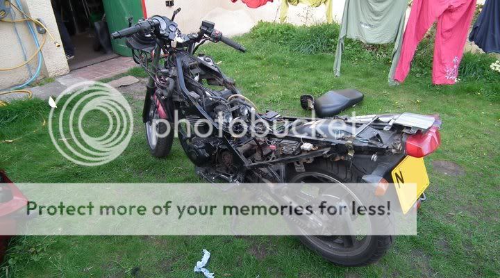

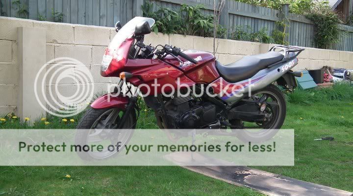

Hi all!
So after being on the CG since last June and passing in January.
I bought a '96 GPZ500S. Tax has run out last month and MOT expires later this month. It's not going to be on the road until July as I cannot afford the insurance until I get my 1 year NCD from the CG.
I bought it for a tad over 500 quid. It needs some things doing like the oblicatory service and replacing things which wear (probably front disc). I need to make some restrictors. I does need carbs ballancing too. Though I can only do that when it's had a service.

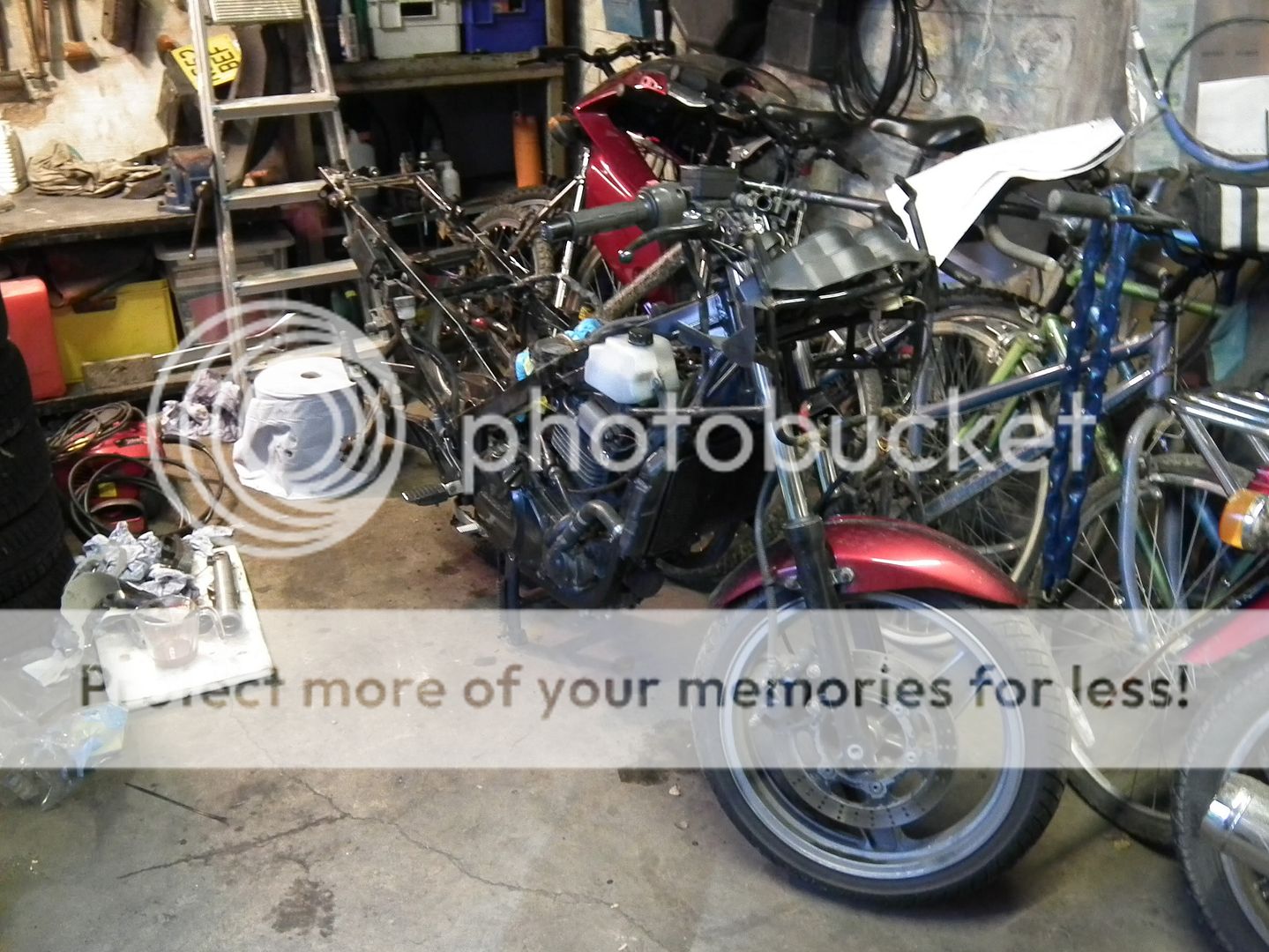

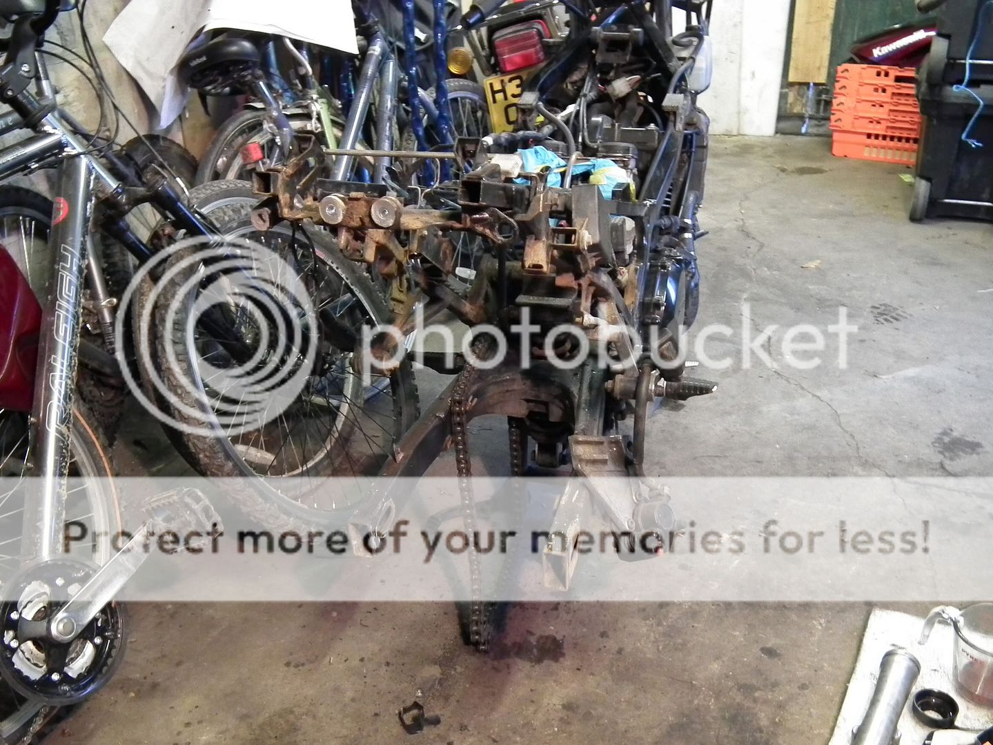

As you may see there is surface rust as per usual to the rear of the motorcycle, and it's going to have the same treatment as my CG. Two bolts did sheer and I'll have to drill them and either the bolts will cave or i'll have to make a new thread.
It's gonna get a few coats of hammerite smooth and it'll be good for another 15 years.

OK, You've bought a burgundy GPZ500S, like me. (mine was 97 and in better condition by the looks of it though, aside from the paintwork. But at least all of my panels were there Razz)
You've paid about £500 for it, like me.
You're having to wait to ride it due to insurance NCB, like me.
You've stripped it down to the frame, like me.
You've taken the rear wheel off and discovered a rusted swingarm, like me.
You're hammeriting said rust over, like me.
_______________________________________________
I suggest you use some rust converter inbetween rubbing it down and hammeriting it over. It'll only help! you can get a little pot on ebay for about a fiver (roughly).
Also suggest you remove the front mudguard and pop the bracket out. It'll be in a bad state. Rub, treat and repaint. Do the same with the rad grille.
Wish I'd kept a list of where I got everything for mine coz I got everything rather cheap (I'm a shopper arounderer).
All I can remember at the minute is as follows:
SJ Motorcycles on ebay for both sprockets (Both JT) cost about £20 delivered.
My chain was a "racelink" 114 link gold o-ring for £26 delivered that we cut down, also from ebay. (bare in mind that if you buy this, the "split link" supplied is a fucking spare link, not a split. It'd need to be rivited. And since fitting a closed chain to the GPZ means removing the swing arm... we just bought a separate splitty Razz All in all completely worth the save in money though.
Oil filter from ebay as well IIRC, about a fiver.
Front sprocket plate from wemoto. Delivery is more than the fucking plate. (not my best purchase, cost wise, but the best i found at a glance)
Didn't need plugs but they're available on fleabay for somewhere between 1 and 2 quid each (NGK DR9EA)
Good luck, it'll keep you busy till insurance is ready. Try not to make my mistake... don't finish it before you can ride it Crying or Very sad
Any Q's and i'm happy to try and help. Mine was a D7 model, what's yours out of interest?

Glenben92 wrote:
helpful stuff
Yeah- it was an auction Glen. 600 would have been my max.
The rust is not a problem, only a hassle. The swingarm is in very good condition. The area around the suspension is the biggest issue.
I'll be needing to take the swingarm off to get the new chain on- and I need to clean up the spring.
What rust removal tool did you use? When I did the exact same thing on my CG, I just prep'ed and brushed the hammerite on.
Regarding the bellypan, i'm not even sure if I would like one
I believe the engine is a D3.
Cool Dunk!
And James, sure!
Glenben92
Joined: 01 Jul 2010
PostPosted: 01:46 - 11 Apr 2011    Post subject: Reply with quote
I used ANCIENT Jenolite we had lieing around and then when that ran out I used the stuff I got from Ebay. As long as you use rust converter rather than rust eater, you're alright. Rather than eating through the rust that's there, it just turns it into carbon. Which kills it and causes zero threat to the metal.
https://cgi.ebay.co.uk/rust-converter-/300546058358?pt=UK_DIY_Material_Paint_Varnish_MJ&hash=item45f9f0e876
That's the one we bought, seems alright although didn't use much of it, the old Jenolite polished off the majority of the rust.
And obviously try and take as much as you can off with emery cloth and wire brushes. (i found the wire brush heads for the drill were absolutely excellent for the job)
If you're taking the swing arm off for the spring anyway then yeah you don't have to worry about open/closed chains. I'm starting to seriously doubt whether an O-Ring chain is worth it though.
https://cgi.ebay.co.uk/ws/eBayISAPI.dll?ViewItem&item=260719309920
(Don't forget the retaining plate from wemoto. It'll probably need replacing. Mine was in terrible nick.) You're supposed to swap em whenever you do the sprockets anyway so...
https://cgi.ebay.co.uk/ws/eBayISAPI.dll?ViewItem&item=250753617940
The chain is no longer for sale, just checked.
The brake pads I bought have now went up in price (I got my kyoto's for £15 delivered for a full set, they're now like £17 or something)
Hope this helps Smile
EDIT: Stats say it's a 104 link 520# chain by the way.. Just to save you researching it yourself Smile
(I say this because I didn't buy a standard, I bought bigger and cut it down to what fit.) I should really count how many links we removed and see if it adds up correctly... it should do. Bike works fine so i'm not bothered either way Razz

blurredman
Joined: 18 Sep 2010
PostPosted: 02:52 - 11 Apr 2011    Post subject: Reply with quote
I'll be buying standard from a shop i regularly buy motorcycle parts off.
I am under the impression however that you do not need the metal to be bare. But, when painting with hammerite, you merely need to make sure that the rust is solid and that it is not flaking and does not have flaking paint on it.
Rust converter to carbon?- how strong is the converted carbon?

Dazbo666 wrote:
...or as another alternative, maybe Hammerite Direct To Rust Primer etc??
That's what I did to the CG. Although rust converter might be a good idea for external bodywork. It is somewhat easier to just brush some good old hammerite on it, as it needs to be on anyway. Besides, aswel as being a thick type of spread, as long as the rust gets no oxygene (by way of chips and scrapes) then the rust cannot do any worse. That's what i've been lead to believe anyway...
DrDonnyBrago
Joined: 03 Jan 2010
PostPosted: 09:13 - 11 Apr 2011    Post subject: Reply with quote
It's not carbon.
Rust converters don't actually convert the rust into metal or carbon, they use phosphoric acid to dissolve the iron oxide (rust) but leave the iron (in the steel) alone. The iron oxide is then 'converted' to ferric phosphate which is black and looks a little like soot (carbon) but is very easy to remove giving you bare metal to paint onto. If you are using hammerite, I'd be tempted to bypass much of the derusting (just give it a good going over with a stiff wire brush) because hammerite is normally quite good when painted straight onto the rusty metal.
The only way to properly convert rust into metal is by using electrolysis (PITA to set up and use) and the only way to convert elemental iron into elemental carbon is by Nuclear fission and fusion (i.e. the somewhat warm processes that occur in the core of the sun) . Cool
HTH

The rear (that includes swingarm, rear half of frame and spring) have now had their first coat of hammerite, I will put a final one on tomorrow for spots I have missed or areas which are thin.
Then when I got the chain I can put them together, and the service can be carried out and get that engine running less rough by balancing the carbs etc. Then i'll need to find some sheet metal to make my restrictors.
Also, the front disc brake is decidedly thinner than it was and I can tell this by the ridge around the outside. Is there a minimum thickness needed for the MOT or does it merely have to be 'effective'?
I heard they had to be at least 4mm thick is this true?
In any case, I cannot figure out how to remove the axle bolt since it isn't one. How do I remove this particular rod?

The spring, swingarm and basically the whole of the rear have been hammerited and are back together. I may work on the front some time in the future. I'd have to buy a belly pan also- Both for looks and the limited protection they give.
Well i've decided to keep the front sroket and chain (they wern't bad at all really) and reconditioned them. Rear sprocket needs a change and so do the rear brake pads. I've yet to remove the front.
I've decided to just pack the cush drive with good solid, thick non-deradable cloth.
