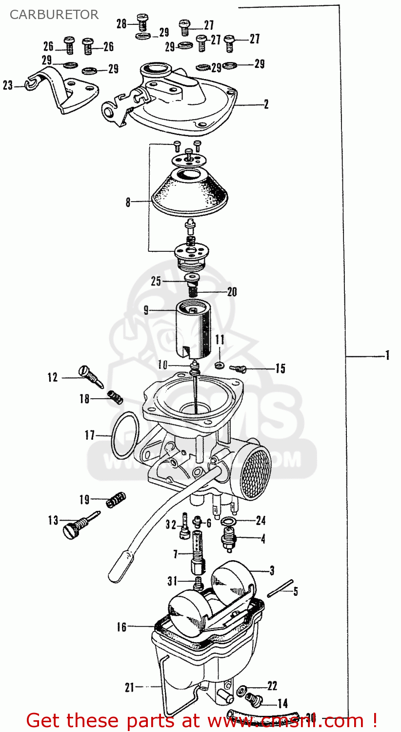

https://images.cmsnl.com/img/partslists/carburetor-cd125k3_bigma000124e13_f652.gif
should look something like this.
Sounds to me like you have taken the float bowl off the bottom, not looked at the slide, which if its the CV carb, which I believe it ought to be on later 12v CDI Benley, is controlled by a diagphram. (Part 8 in the pic)
