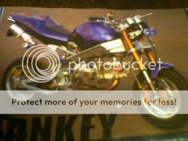

Random I know, But YEARS ago I used to read Streetfighters magazine and saw this in the mag, apparently it's a monkey bike too, any ideas?

I know this would be pornography but, why don't you get a second hand NOS kit off ebay?
https://img.photobucket.com/albums/v707/lllN30lll/56HJ0022.jpg
looks like a moded honda zb50 to me?
from the main frame that is, everything else looks custom
could be wrong though

Finished a night shift this morning and went straight to work for the next four hours solid, my back is killing me now! The main reason being having to redo work over and over again due to me not thinking first or not realising that it wont fit 'that' way and needs adjusting again and again...
First thing to look at was the rear brake light, it would come on but no brake light or brake light and no lights. I tried swapping the bulb round to no avail, I must have bought a bulb with slightly different lugs as it wouldn't fit when turned around. A new bulb is better than what I first thought was going to be chasing the loom checking switches and connections.
Front end was next.
This was a headache to fit due to me being a wally. I couldn't get the headbearings to fit so that the bars would turn, when done tight the yokes were solid? After 3 or 4 different fittings and various combinations of the bearings and covers I realised that the old bearings had left their covers behind and needed knocking out.
Brick Wall
After a couple of swift blows with screwdriver and hammer they popped out and the new bearings fitted. Amazing what happens if you look properly.
I need a spacer to give quite a large offset for the front wheel as it barely fits at the moment in between the forks and hits the brake caliper too.
Need a new light housing as the previous one was cracked when the wife crashed it head first into a wall. As his is where all the wires and connections get hidden I've left the old one attached for now instead of having spaghetti junction to contend with in a few days.
Other things needed for the front end:
Arrow Handle bars, not sure on style yet will see if I can see a few first before deciding.
Arrow Grips and a quick action throttle
Arrow Mirrors
Arrow Front mudguard
https://a4.sphotos.ak.fbcdn.net/hphotos-ak-snc6/199773_10150104459691658_582986657_6563120_6965841_n.jpg
Twin discs would look awesome as these new discs are huge in comparison to the old ones on the 8 inch wheels, but £450 is quite a bit too much money for now.
Took the carb off to switch to the new one only to find that it wont fit on the existing manifold and needs the one it comes with to be fitted. Only downside is that I didn't have the screw bit to take it off and to change it over so thats added to the list of things needed. Shame as I was hoping to fire it up with the new race CDI to make sure it still turns and fires.
The biggest headache today was the rear sets not fitting and subsequently the rear disc conversion also not fitting at all.
Mad
No matter what combination of fitments or adjustments I tried it just wouldn't go smoothly and was miles off from fitting.
There were some issues with the rear sets, one being that the rear brake switch was now in front and no way of mounting it or even connecting it to be able to work? The other being that there is no way a side stand can be fitted or used with them. Carrying a paddock stand to work every day on the shoulders would be an inconvience to say the least.
https://a6.sphotos.ak.fbcdn.net/hphotos-ak-ash4/197785_10150104459526658_582986657_6563116_6959757_n.jpg
As the rear brakes would no longer be discs I tried the larger 10 inch wheels with the old drum set up and they fit lovely and don't look too bad either. Thats one less spacer needed tomorrow.
The exhaust follows different lines to the other one that I had but looks good and even comes with a little baffle to screw in or not. Should keep the leg warm in the winter.
https://a8.sphotos.ak.fbcdn.net/hphotos-ak-snc6/183023_10150104459461658_582986657_6563115_5907023_n.jpg
Random things needed still include new tank as the old one has a slow leak and has stained the engine from it, a new gear lever as old one is bent and maybe some new sprockets* and thats it before MOT, running it on the road and going to the next phase?
* Current is 17t front and 35t rear, in the desriction kit the front is 15t and 30t on the rear? How the hell can this be of any benefit to man nor beast when stock has a larger front for speed and even a larger rear for acceleration?
18t seems to be the biggest you can get for the front so may stick with the stock gearing rather than opt fo the smaller set up to be pootling at less than 40mph!

gorgeous bike you have there mate. I too have a monkey.
Keep the stock engine, too much messing about with trying to fit pegs, and trying to make the sprockets line up if you replace it.
Take a look at your sprockets. Mine will cruise at 40-45 and top out about 55 maybe touching 60.
I'm running 8" wheels, 17-26t setup. Chain clears the swingarm fine... (running a +10cm swinger)
If you are running 10" wheels you will want something more like 17-30. I used to have a monkey with 10s that ran 17-28t and it was a tad overkill on the top end. Third gear used to let me do 50mph on its own Laughing
Let us know how it goes. Cool
