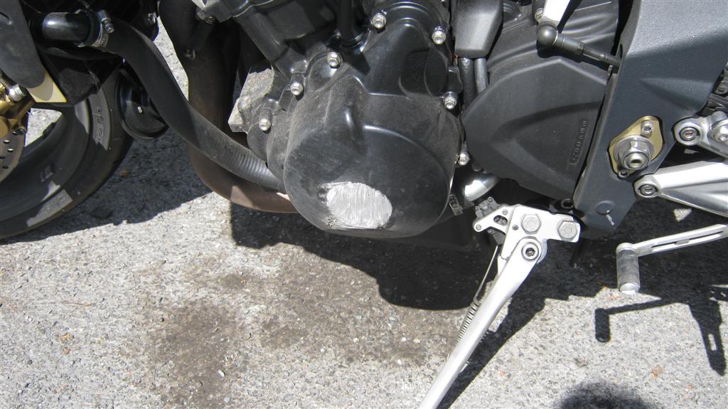

So far, so terrible. But the worst was yet to come. The brake lever I ordered turned out to be incorrectly machined. There is a hole that the brake pushrod seats into, but in the new lever it must not have been quite deep enough. This was where the combination of shoddy parts and my mechanical incompetency resulted in true disaster. Despite it being a very tight fit when I installed the lever, I decided to persevere anyway, because I'm a total bellend. This resulted in the front brakes being ever so slightly on, although I didn't realise it.
The next day I was riding to work, going about 60, when the bike started slowing down for no apparent reason. This lasted about a second, then suddenly I was no longer on the bike, I was sliding down the road.
I ground to a halt and managed to drag myself onto the verge. I knew my knee was hurt but it wasn't until I looked at it and saw bone that I realised how badly. The woman who'd been in the car behind came to help, and mentioned that she had seen smoke coming out of the bike just before I'd crashed. Presumably this was from the front brakes.
So as well as a pile of worthless eBay crap, I also have a severely scraped bike and the prospect of 2 months in a leg brace due to a broken kneecap. My helmet, boots and gloves are in the bin.

Here's a few more pictures:
https://www.bikechatforums.com/files/img_5595__large_.jpg
https://www.bikechatforums.com/files/img_5593__large_.jpg
https://www.bikechatforums.com/files/img_5592__large_.jpg
https://www.bikechatforums.com/files/img_5600__large_.jpg
https://www.bikechatforums.com/files/spm_a0057__large_.jpg
https://www.bikechatforums.com/files/img_5607__large_.jpg
Damn, that looks nasty!
This is exactly what caused my off on the runway at 132mph.
When the bike is first ridden, the wheel spins freely and the brakes don't bind at all. As the brakes generate heat, a tiny amount of oil is supposed to flow back into the master cylinder through the return port (no bigger than a pinhole really) to stop pressure building up. This port is covered by the master cylinder piston in the very first bit of travel, so because the lever was tight-fitting it's held the piston over that port which has not allowed any pressure relief in the system.
Basically, they have sold you a poorly-machined part which has caused the crash. I'm not a great advocate of the compensation culture but in this case, I would say you have a great case and good justification for a claim.
BTW don't touch the bike or the braking system if you think ou want to claim - it's going to need to be inspected by an engineer/assessor.

I'm not one for the compensation culture either, but in this case it is just. I've ranted in another thread about how e-bay has become a haven for "businesses" selling cheap crap and it's about time the sellers are the ones paying for it!
Like Pete said, don't touch the bike. Get it inspected to prove the lever caused the problem and start down the road of taking the seller to the cleaners!

Thanks for the advice guys, unfortunately I had already removed the brake lever because I wanted to work out what had happened. Plus the fact they came from China made me think I didn't have a chance at getting compensation.
I have fully comp insurance and a guy from 4th Dimension came to pick the bike up this morning to take it away for repair (all the way to London, surprisingly).

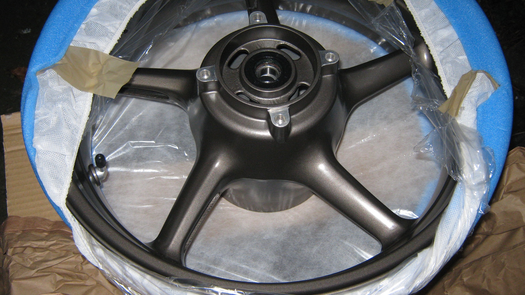

I forgot to mention the gold wheels I bought on ebay:
https://cgi.ebay.co.uk/ws/eBayISAPI.dll?ViewItem&item=260761663273&ssPageName=STRK:MEWNX:IT
https://i.ebayimg.com/05/!CEd9CHg!mk~$(KGrHqYOKpME0UnDvv+)BNS!rhTmS!~~_12.JPG
When they arrived, they were the wrong bloody colour!
https://www.bikechatforums.com/files/img_5539.jpg
So I've sent them back asking for a refund. I could've asked for the right colour but I can't be bothered any more. This whole thing's just been a complete failure from beginnig to end.

I don't think it's particularly the levers at fault, well i suppose it is as this wouldn't have happened without them, but plenty of people fit the cheap pazzo knockoffs with no problem.
It was mainly down to the man on the end of the spanner. Someone with a bit more savvy would have drilled the hole to the right depth or just not used the lever at all.
Not having a pop at the OP as he's already kicking himself enough.

Yep, it's weird to think such a simple little job could have prevented 2 months of pain and suffering. I'm now relying on the goodwill of the gf to give me lifts to and from work every day; that's what I call suffering!
